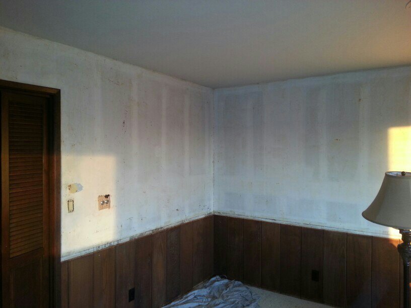

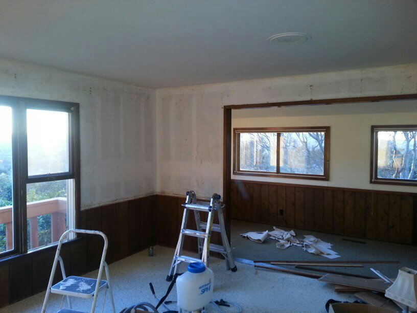

    It seems to depend on the type of wallpaper. First, I try to see if it will just peel off by hand. If the paper is thick enough, sometimes you can just pull the front off the backing. In the small room attached to my living room, the paper just pulls off, leaving the paper backing that's glued to the wall. Then I spray the DIF solution on that. It soaks in well and the whole sheet will usually come off in one pass. The paper had a ridged felt-like texture to it.
    DIF concentrate works really well if it can soak into the paper. You mix one cap-full of the DIF concentrate (not the GEL) with one gallon of water. Then, spray it on the wall using one of those backpack pump sprayers.
    Let it sit for 15 minutes so it can react with the glue and it should peel right off.
    For the paper in our living room, the DIF solution was not working so well. It doesn't soak into the paper as easily (the DIF has to get to the glue). It'd get some soaking where the wallpaper met with another sheet but it wouldn't soak through the surface. So we're using a Wagner steamer that came with a wallpaper attachment. It works well but it's much slower. You fill it with water, let it heat up and then place the attachment over the area you're going to remove. Steam it for about 10 seconds and that portion of the sheet will come right off (about 8"x11"). It mostly takes time because it has to keep generating steam after it's been used a couple of times. It's easy though.
    I don't perforate the paper. The guy who recommended DIF (it's a video) said it makes it harder because it tends to come off in little pieces rather than one big sheet.

    Got the wallpaper off in the living room. Now to clean the glue off with the Dif solution.

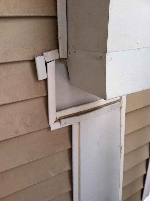

    i've lived in my house now for about 3 months, im learning that the original owner cared nothing about maintenance. and if there was ever a problem, it was not dealt with it was just covered up.
    anyways, here is my question for the day. i hope to address this somehow in the spring. i'm not sure who did the siding installation on the house, or if it is actually supposed to be done like this.....
    this is how the siding is bordered around the doors, windows etc... i think it looks like absolute crap! there was a section of porch here that was removed so he could install a handicap ramp so this looks especially bad. this is probably the worse spot on the house...but i mean what the heck??? did the installer just really half ass this? what are you supposed to use around doors, windows and stuff? i don't think these are pieces of j-channel (i think that is what it is called, forgive me i am new siding nOOb), it looks like it was just some sort of trim glued in place. any ideas or suggestions on what to replace it with?

    I had the same problem on the back of my house when I removed a deck. The problem is finding siding that will match the existing siding. I had to have the entire rear of the house resided to make it look right. Not an inexpensive fix.
