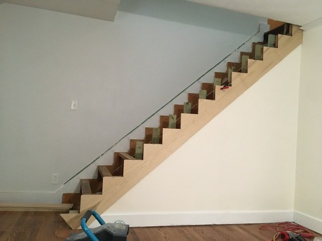

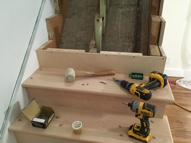

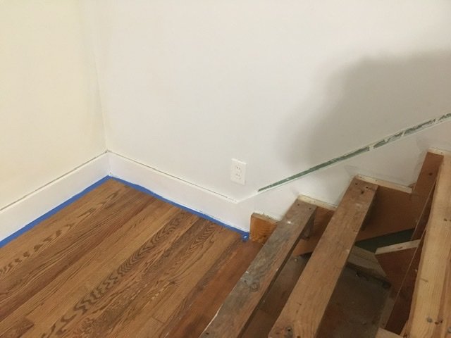

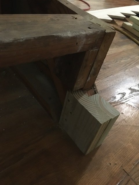

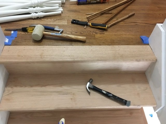

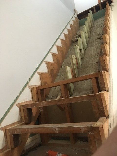

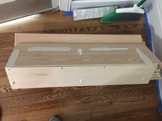

    I didn't have any time to update until now, was able to finish assembly.

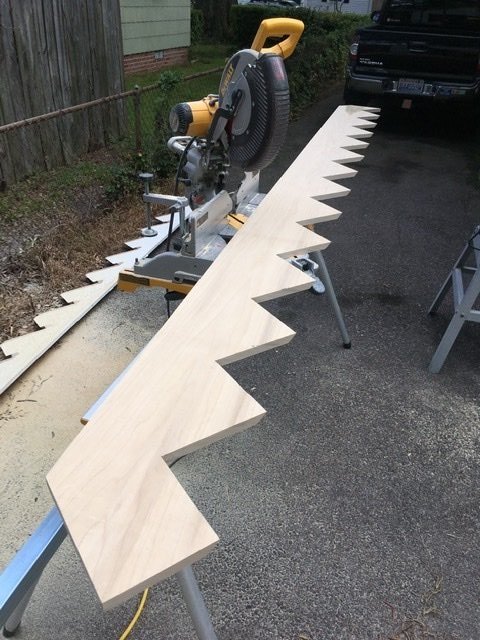

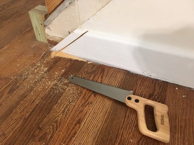

    I situated the open side stringer and cut the existing baseboard to match.
    I placed a level across the front of the framing and glued/screwed 1"x1" blocks onto the back of the risers, to tie the riser to the tread above (adds more rigidity).
    I Liquid Nail and then placed the tread/riser assembly, I pulled one to verify good contact

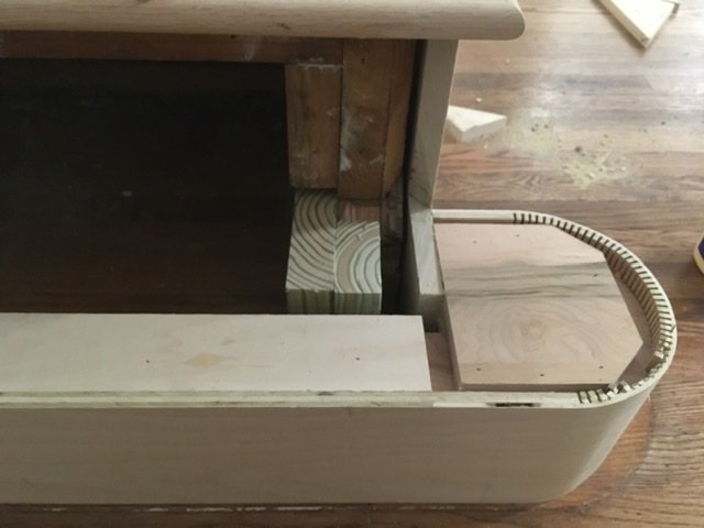

    I needed to replace the landing nosing this time
    Made and attached the bullnose wrap
    Bondo screw holes that the trim won't cover and then trimmed

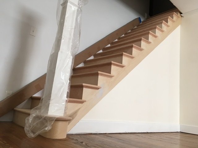

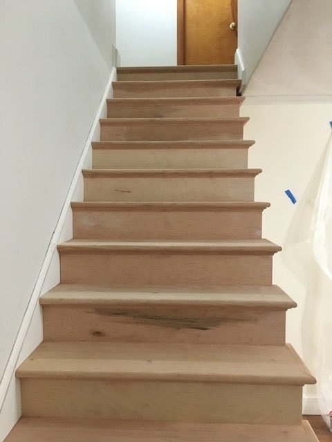

    As she sits now, waiting for me to get back into town. The next thing I'll do is stain/poly the treads and then paint. After that, I'll install the already painted balusters and newel and then the rail. I think I'm going to match the treads to the floor and go with a darker stain for the rail.

    Now that's a transformation!

    Absolute work of art. Beautiful

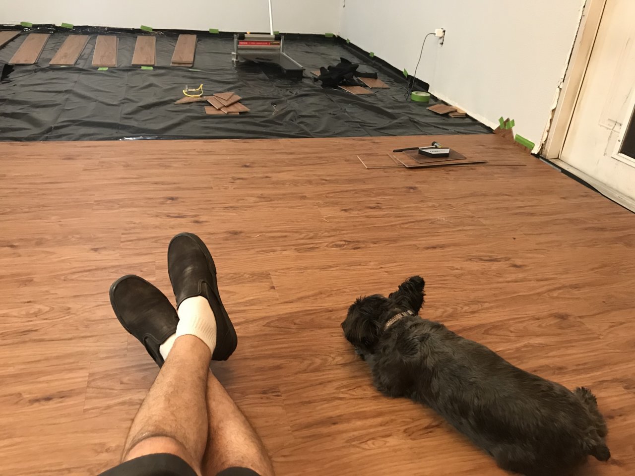

    Putting down my “Luxury” vinyl plank. Almost done and then can do baseboards and bring all of the furniture back in.
    there’s a spot I wish I had leveled a bit better but it should be ok in the long term.

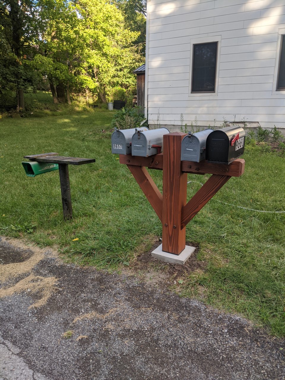

    I finally got around to installing the mailbox post I made, only took me a year from when our old shitty one got blasted by a car in the middle of the night.
    The old one is a hollow 4" steel pipe, it rusted out at ground level and then got run into, there's been a 2x4 in there holding the top half upright. Gonna take that out and fill the old pipe tomorrow.

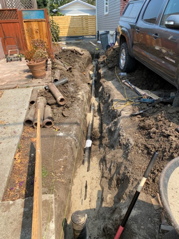

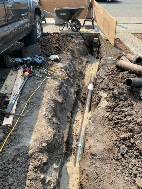

    I’ve been slowly working up the willpower to start my driveway work. I did a second floor addition to my house two years ago and just Now got around to fishing up the driveway. The old concrete that was there was just completely destroyed by the trash dumpsters and delivery trucks.
    While I was at I replaced my sewer main that had a nice little uphill slope in the middle of the driveway. Replaced the old clay with cast iron. Finished leveling out the dirt in preparation for paver work later this week.
    Not too bad for 3 days of work for me and my 55 year old mother as a helper.
    we took out around 10 years of concrete and 10 years of dirt.

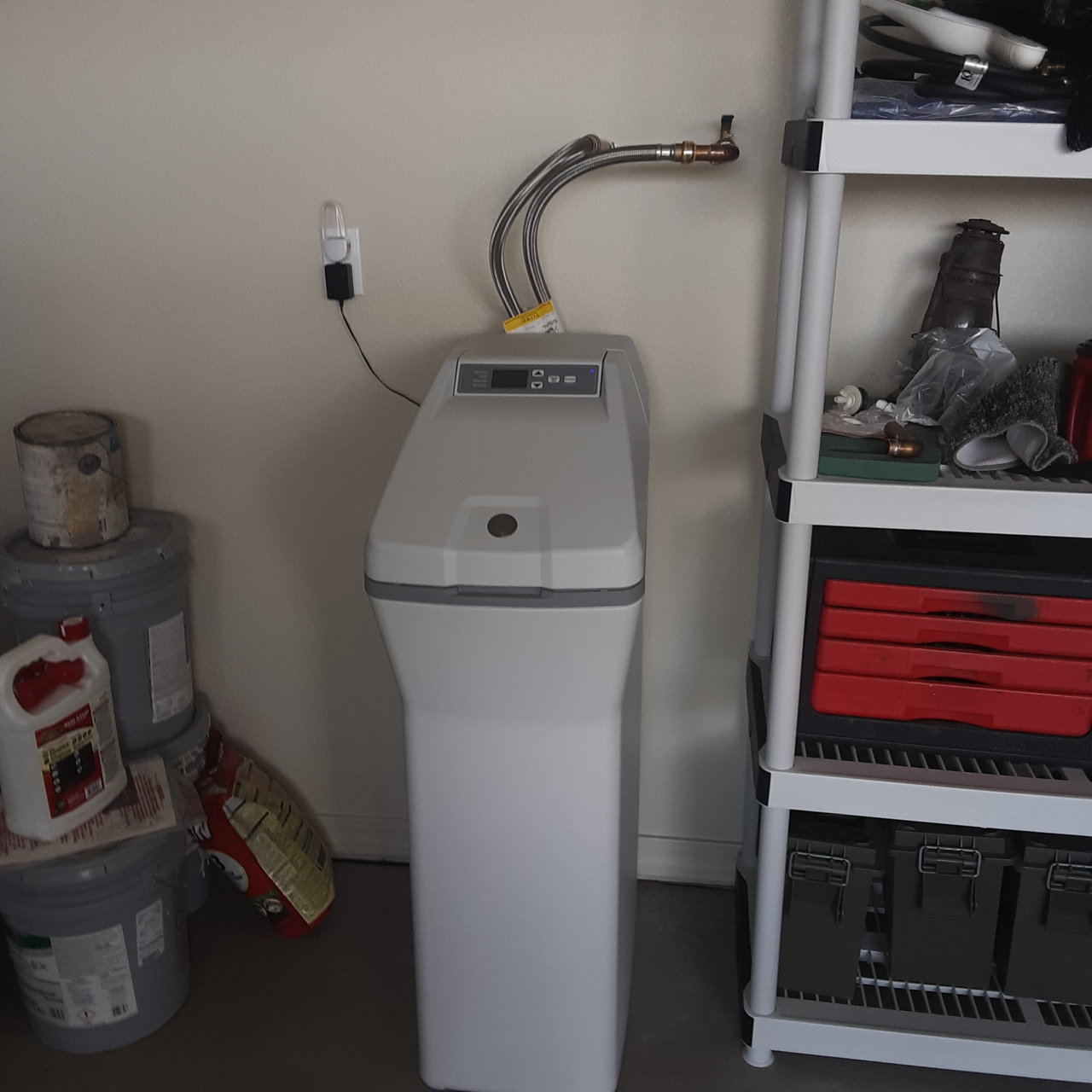

    Helped a friend install a water softener in his house..

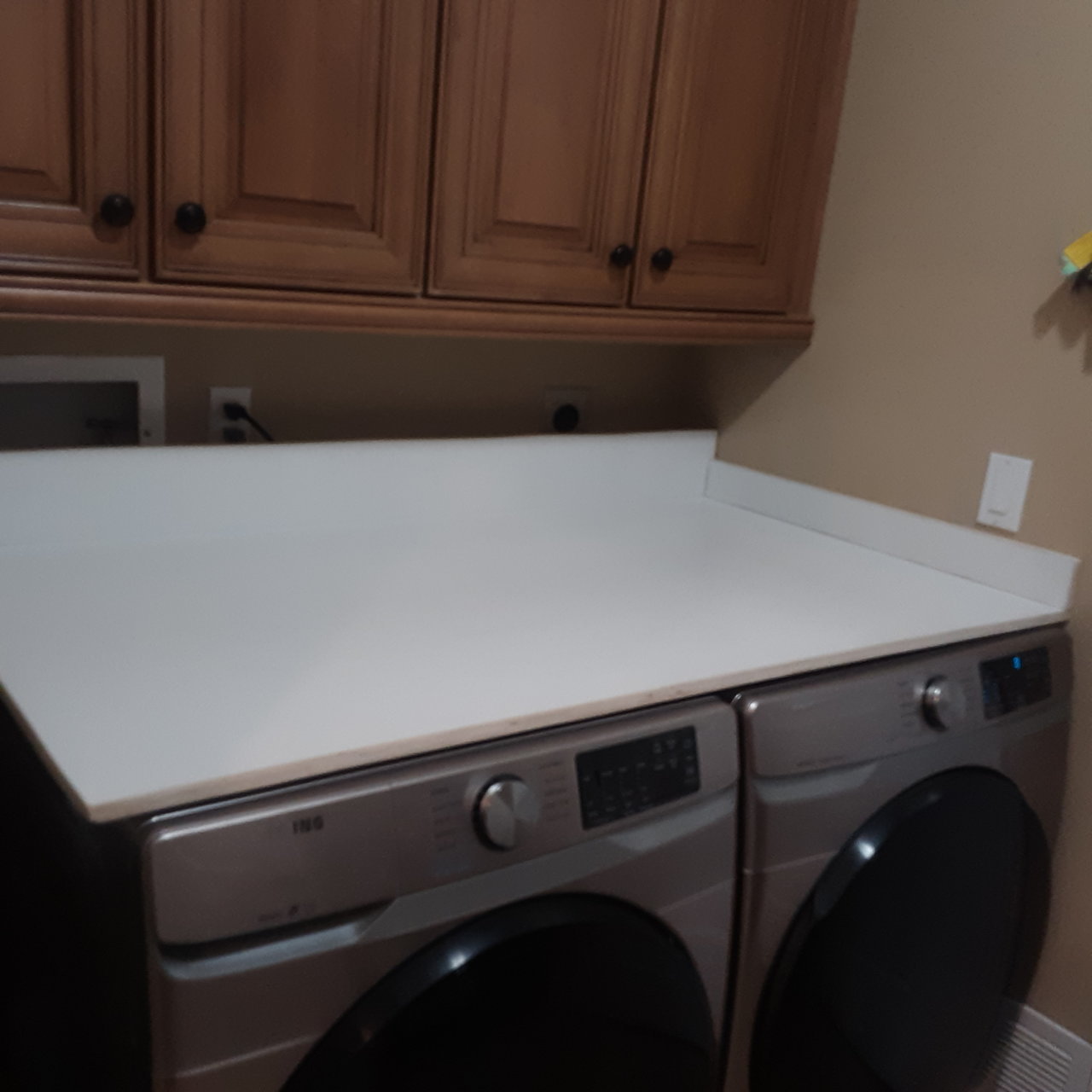

    Nothing fancy...Made this today, has rubber feet under, free floating. Open to the left to hide mop/broom etc
