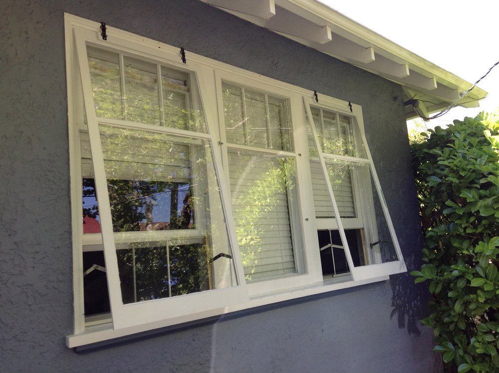

    I have old wooden windows with a key lock. House built in 80s. What’s thoughts on restoring them vs replacing.
    I think restoring them would be cheaper even with adding a storm window like this, plus better insulated with the extra window.
    Just looking for opinions on what to do. Thanks

    If the wood is in good shape (not rotten or cracked) restoring them and adding a storm window makes the most sense. Window efficiency really comes down to good weatherstripping and sealing. if you can get a good seal around the window and add a storm window you are looking at 1/3 of the cost of replacing the window itself. People will insist that you need to upgrade to fancy dual/triple pane glass, but its generally not worth the expense if your existing windows are in good shape.
