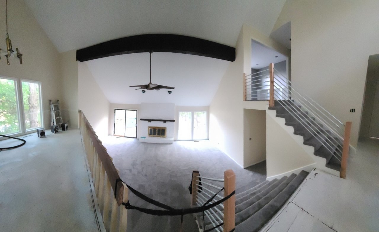

    Carpet installed yesterday! Wasnt there myself but one huge step forward

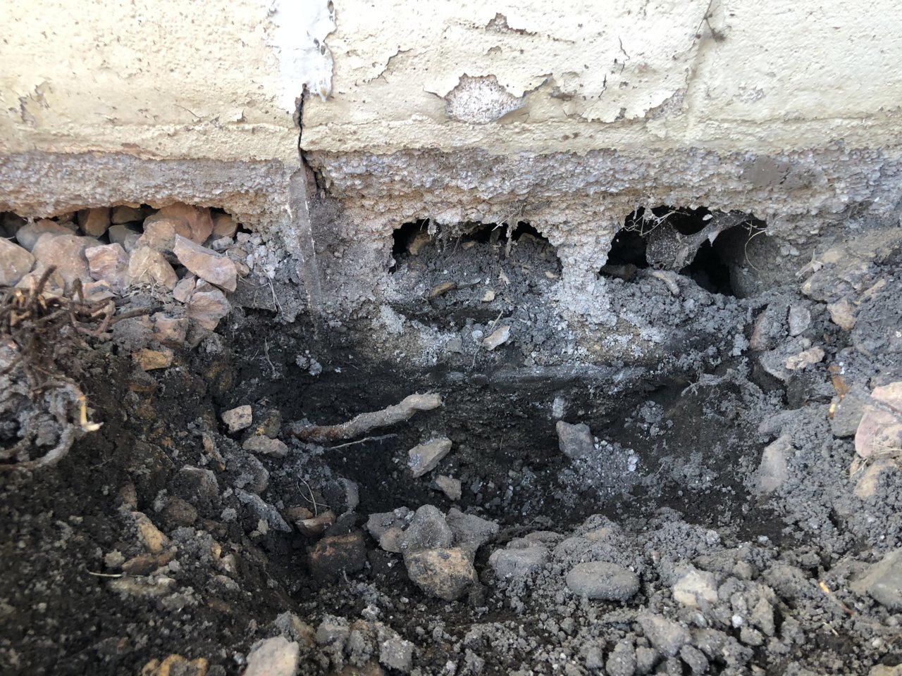

    The deeper I dig, the worse it gets. Hoping to stay under 20k now. So much for the new camper (which was the only damn reason I sold the Tacoma! Argh!)

    are the blocks laying on their sides or is the outside wall of the block completely gone?
  9. Oct 8, 2020 at 5:34 AM
    brow
    brow Well-Known Member
    Apr 4, 2010
    #34580
    624
    Andy
    Minnesota
    2020 Dodge Ram 1500
    outside of the block has completely disentegrated. Poor bulk water management from the previous owner and Minnesota freeze thaw cycles turned them back into gravel. Frost footing goes down 48” not sure how many rows will need to get replaced until it’s dug out.

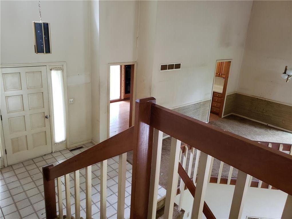

    alright looking for opinions again...
    my entry floor (dining room/kitchen/entry way) needs flooring. subfloor isnt flat at all - gaps between some of the subfloor, some have dips etc... see below areas (tiled, carpeted,vinyl in the kitchen) in a before picture.
    My dad was suggesting the trafficmaster allure grip strip install stuff since it will lay flat and conform once i put the luan down. Does anyone have a different suggestion? ~625sqft that id have to self level otherwise to use click lock i think

    If you where married I was going to tell you to ask your wife what she wants in the entry. Then do whatever it takes to make that happen. For sure get the girlfriends input. Self leveling that area with Level Quick RS would be very easy. Go with what you want and do the work needed to make that happen. You'll be happier with the finished product that way. The last thing you want is to walk into your home in 5 years and think "Damn, I shoulda done that different."

    @Sacrifice. I'd suggest to lay down a layer of 3/4" plywood glued and screwed to floor joists.
    Luan is too thin to bridge gaps or to "level" a floor. If the base isn't solid, whatever is on top will be crap no matter how pretty or expensive.
    Get the 3/4" down, then you can prep for anything you want as finished flooring.

    yeah, somewhat at the point of im ok coming back to redo it nicer down the road. would level quick be able to go over luan in the future?
    i wasnt expecting the luan to necessarily "level" the floor, was just using it to obtain a smooth surface if i put it down as it is now. 20 sheets of 3/4 plywood might blow up budget a little too much at this point

    Its your choice.
    Do it right, do it once.
    or you can plan on doing it again with more expense.

    Could you pour level quick over luan? Sure. Should you? No. Anytime you add multiple layers it adds flex. Flex will cause squeaking and potentially cause the level quick to crack. Since your pulling the old flooring have a look at the sub-floor. If it's still solid just level quick it and be done. If it's not solid then you can decide whether to fix it proper or band-aid it. I will always recommend the proper fix. Duplication of labor is something I like to avoid.

    thanks guys. ill weigh my options. maybe i can do the 3/4 plywood to give me a more even surface/level as i put it down
