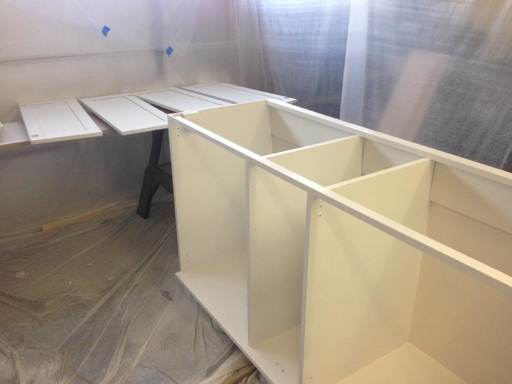

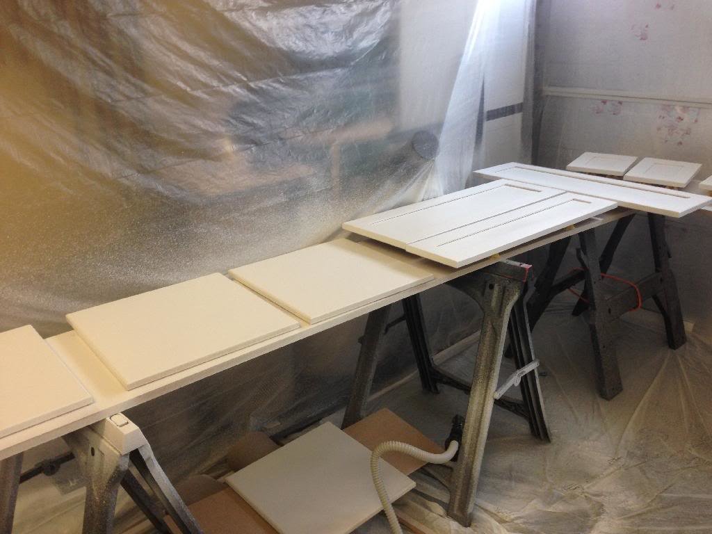

    Never used it for raised panels, only flat. Raised panel doors aren't really my cup of tea so I haven't done any of them yet. For my vanity, I used a shellac based primer (zinser BIN123) and it dries fast and really hard. It's sandable within 15 minutes. It worked well to seal the edges of the MDF. I think I ended up doing 3 coats on the edges. I'd imagine it would also work well for raised panels if you sand the fuzz between coats. The key with mdf is to not use a water based primer bc it will raise the fuzz.

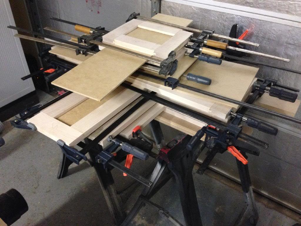

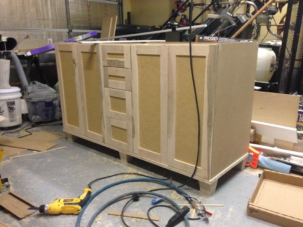

    For the doors? The vanity is a frameless full overlay style door so no "face frame" technically. The doors are done with a stile and rail (aka cope and stick) router bit set. I used Rockler's shaker stile and rail set for these doors. The frames are soft maple and the panel inserts are 1/4" mdf.
    I did do a face frame for the built-in though. It's just poplar (ran out of maple) pocket screwed together.

    How finicky is setting up the router so that the rail and stile bits line up ? I usually do mine on a tablesaw with a dado head , Norm Abrams style

    You can use any type of paint on top of the shellac based primer. My finish coat was Sherwin williams pro-classic latex gloss. The pro-classic is a waterborne acrylic so it's called a latex paint bc it's waterborne but it's not really your typical latex. It has a really hard finish. Plus easy cleanup bc it's water based.

    It's not bad, I use a few scrap pieces to set the stile bit like I want it, batch out all of those, then set the rail bit (for the end grain) with the cut stiles. I'm thinking about buying some of those phenloic bit setting jigs that rockler sells to make setup even faster.

    Thanks for the advice. We did a bunch of built ins with a catalyzed industrial paint and they came out beautiful, but that was a high budget job. Since then i have sprayed a few times and have been looking for a cheaper way to get a really nice finish but have struggled with MDF. Damn fuzzy's!
