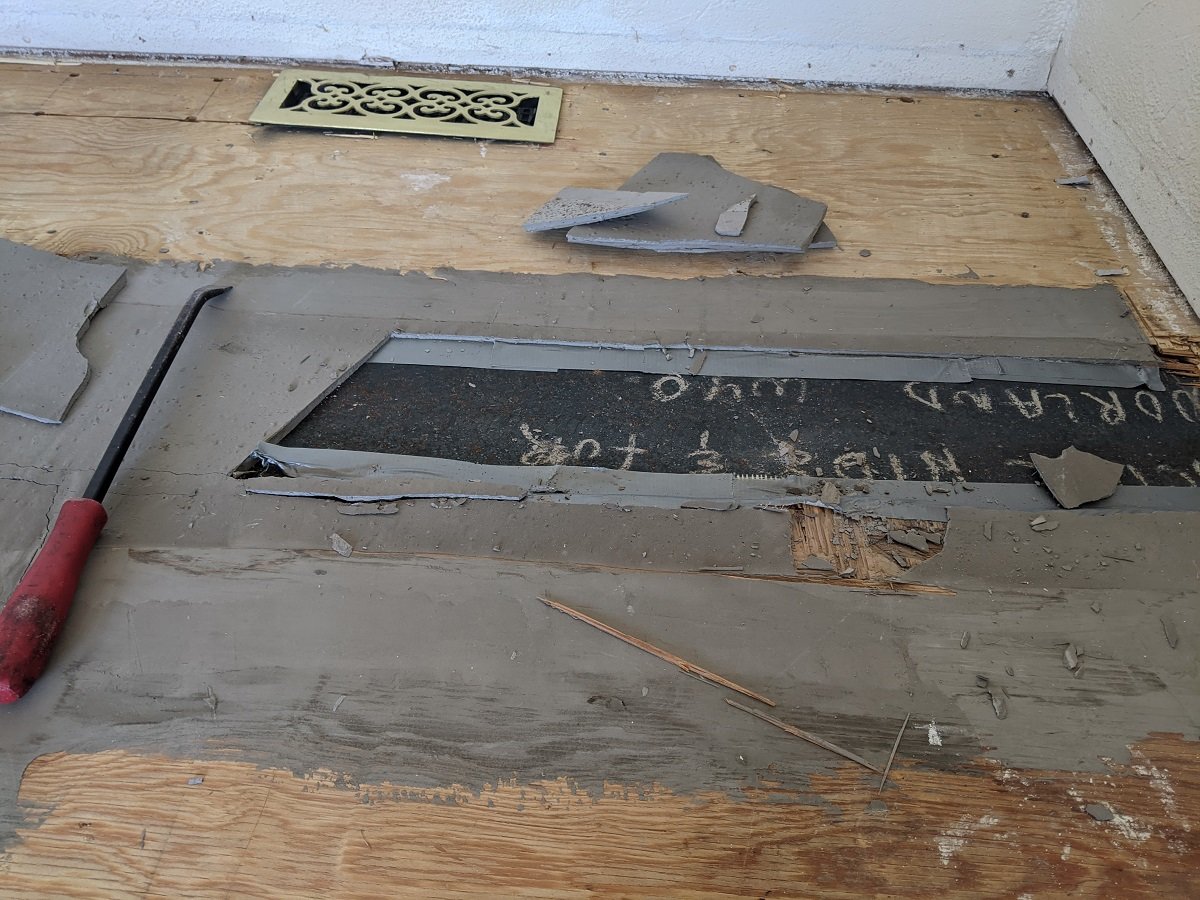

    Well the wife and I decided we wanted to continue the flooring from in the kitchen into the living room and spare bedroom. So ripped out the carpet in the living only to discover where the joists meet up with the steel beam wasnt level at all. Had a nice ~1/4" hump to it. Wasnt noticeable with the thick pad and carpet but wasnt going to work. Between the subfloor they just used..something. Not totally sure what but its a cement like product. Thankfully it didnt really stick to the beam so it came off easy. But after removing a small portion we knew something was up. One side of the "cement" on the beam was maybe 1/8" thick while the other end was closer to 1/4. Plus the side furthest from the wall they had reduced the subfloor thickness to ~1/2 of what it should be. Maybe thinking they would just go right over the beam? They at least added support under the reduced thickness sections
    So our game plan was to just replace the subfloor around the beam.

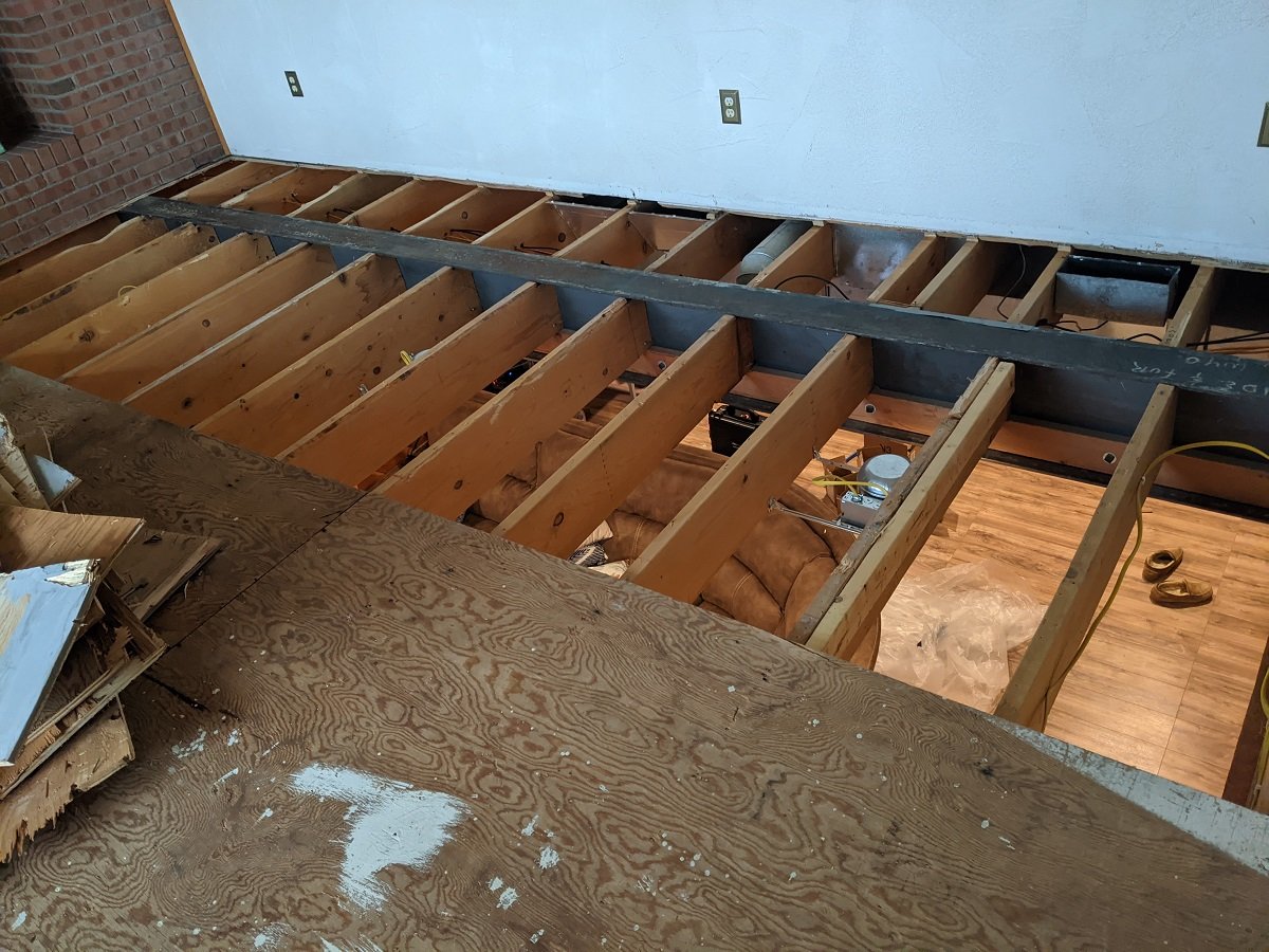

    Once we had it removed we noticed the problem. The "short side" joists all sit ~1/4" below the steel beam top. The "long side" are all pretty much flush or just below the top of the beam. The "long side" is also slightly off level with the high side being the beam side.
    So our thinking to solve the problem and get the floor level enough for flooring.....just skim the needed ~1/8-3/16" off the "long side" joists and do it over the ~40" from the other piece of subfloor to the beam.
    Figured I'd get second opinions before just doing it (well and im done for the day) and make sure Im not thinking of something easier/wrong with the idea.

    I had a similar problem in our master and solved it the same way I think you are describing. On mine, the second story overhangs the back of the house a couple feet and the joists were sagging on that side causing the opposite side to rise. I secured the rising side with 2x 10” or so long lag screws/bolts to keep them from moving more. Then bought a power planer and took off about 1/2” over a couple foot span adjusting the height of the planet mid stroke to taper the planing. Then on the low corner, built it up with an extra layer of plywood, feathering compound and then the whole floor got self leveling compound (no picture of this room with that). That lowest corner (final picture) was an inch and a half lower than the rest of the floor only ten feet away when we started. Perfectly level when we finished. Came out great.

    i've never seen a wood to steel beam connection like that , usually we pad the beam with wood on both sides , full depth of the web and put the joists in hangers
