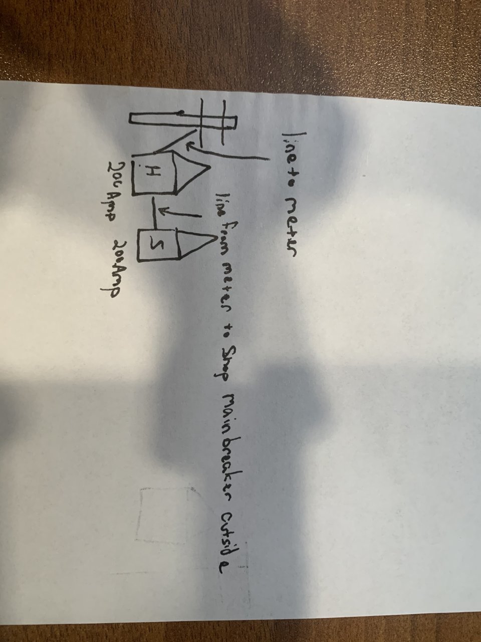

    Thought I would post in here, I have built a 25x25x10 shop in the backyard. I'm working on getting quotes for running power to the shop.
    First quote was for $6300 to run estimated 100' new line of service 200 amp to the building.
    Waiting for more quotes, but sounds unreasonably high.
    This also has me considering not getting 200 amp service and just sacrificing to a 100 amp sub panel.
    Just means that I may have to be more conservative on letting every machine I want to buy be running at same time in the future.
    At least I can do the sub panel myself though.
    Just looking for thoughts because though I stayed calm, I was hugely let down when he said $6300.

  15. Feb 3, 2021 at 9:26 AM
    tirediron
    tirediron Well-Known Member
    Jan 19, 2019
    #279864
    3,891
    John
    Victoria, BC< Canada
    2022 4x4 Sport, Auto, BCM
    Is that $6300 just to run service to the meter base, or does that include installation, cable, etc? Either way, seems crazy high. Other than bringing in the supply from the pole, it's all a very simple job that you can do on your own.
  16. Feb 3, 2021 at 9:31 AM
    whitedlite
    whitedlite Well-Known Member
    Jul 14, 2016
    #192033
    9,315
    USA!
    3RD Gen TRD 4WD
    Bringing power from the pole has to be done by Power Company I thought?
    That was them telling me pulling permit, running power to building, and "per code" they told me they have to hook up the panel, and wire 1 plug and 1 light.
    I was under the impression the power company runs the wire from the pole to meter for free just to get the new line of service. So an extra payment every month.
    I could be wrong on that though.
  17. Feb 3, 2021 at 9:53 AM
    tirediron
    Jan 19, 2019
    #279864
    3,891
    John
    Not sure of the specifics for your location, in most places the utility company will pull power to a service provided it's within X' feet of the property; that's typically a pole's distance or less. I would call whichever government agency is responsible for such things. In my area, the homeowner can do anything electrical to their home/structures on their property. It has to be inspected, and usually receives a more rigorous inspection than a ticketed sparky would get, but it also costs a lot less. When I bought my home, the meter based was spiked to an old cedar stump; I installed a brand-new service, and did everything from the weather head to the panel myself. I saved about $3000.
  18. Feb 3, 2021 at 9:58 AM
    whitedlite
    Jul 14, 2016
    #192033
    9,315
    USA!
    3RD Gen TRD 4WD
    Will be calling Alabama Power today.
    Thanks for insight.

  20. Feb 3, 2021 at 10:07 AM
    whitedlite
    Jul 14, 2016
    #192033
    9,315
    USA!
    3RD Gen TRD 4WD
    so why can’t this be done, say the wire from pole to meter supports 400-500 amps going to meter with a main breaker right below meter on house as a master throw. From that master breaker you have a wire running into house and one running to shop.
    Wire going into house is to a 200 amp panel, wire to shop first hits another master switch on outside of building, then goes through my conduit to 200 amp panel inside shop.
    check out my drawing.
