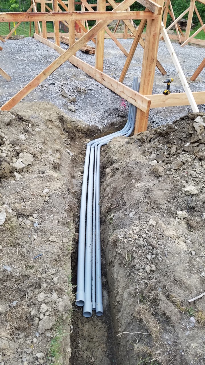

    Holy chit, I've done a lot already!!
    Again like everyone else, I don't know your local code. I was able to pull my 100 amp sub (to barn) off my 100 amp main (at house) appx 75' for a HELL of a lot less than $6300. My site contractor dug the trench, and I installed conduit and pulled wire myself. Also installed panel and all wiring DIY. This is in NY, so a lot more uptight than AL I'd assume. I'd guess all in I was less than 2k for service and panel. Probably less than 3k for ALL wiring. Now your 200 amp wire will be more than mine, but that does seem unreasonably high. I did mine pre-covid price spikes though.
    One other note, if you open a trench to the shop, run more conduit. I have 4. 1-power, 2-low voltage (data and phone), 3-pex for water, 4-future. Conduit is cheap, compared to digging in the future to add more.

    Just wondering, because I assume most places are the same, is that deep enough to run wire?
    Is the 36" deep only for wire ran from pole to meter?

    As far as I know, conduit only needs to be 18" to pass. Picture is misleading, mine are between 36" and 27" down, because in Buffalo, deeper is better. I don't know what pole to meter is as ours are overhead.
