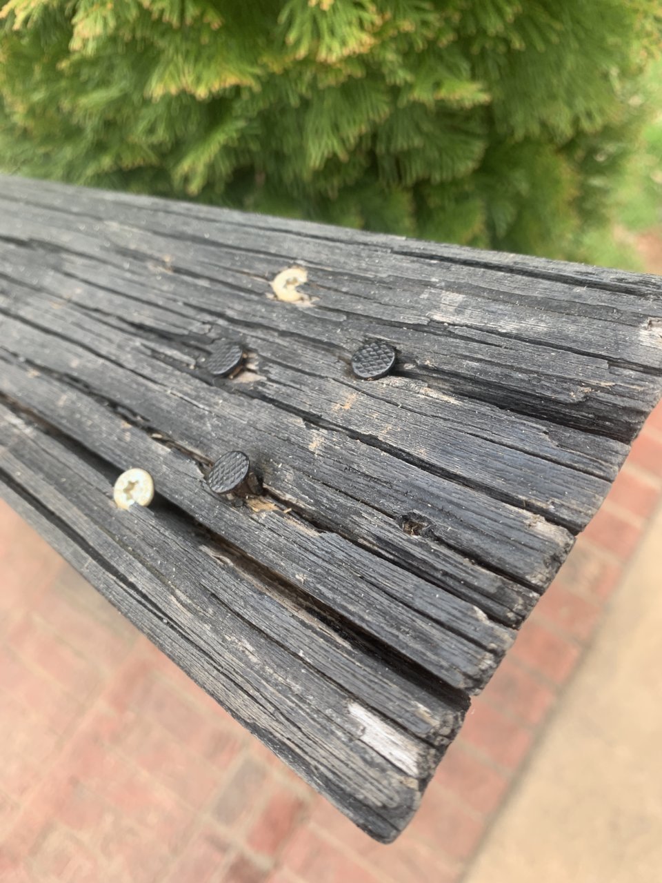

    I don’t use nails for anything.
    Nails back out over time. Example A
    And yes the wood is shit so probably doesn’t help but yeah

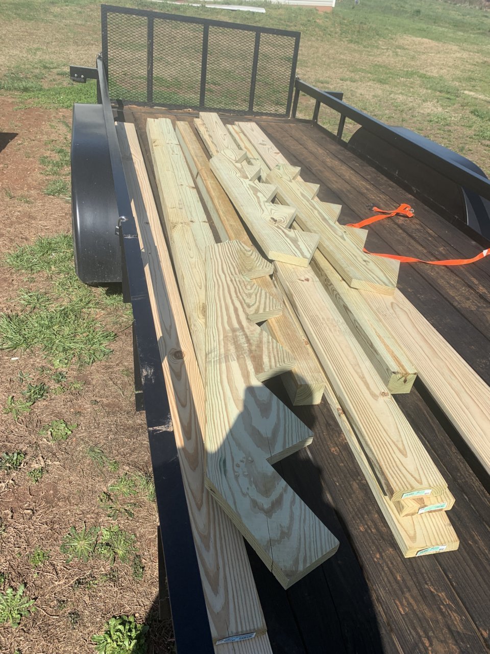

    Load of lumber to start my 6x6 deck project after my patio is poured.
