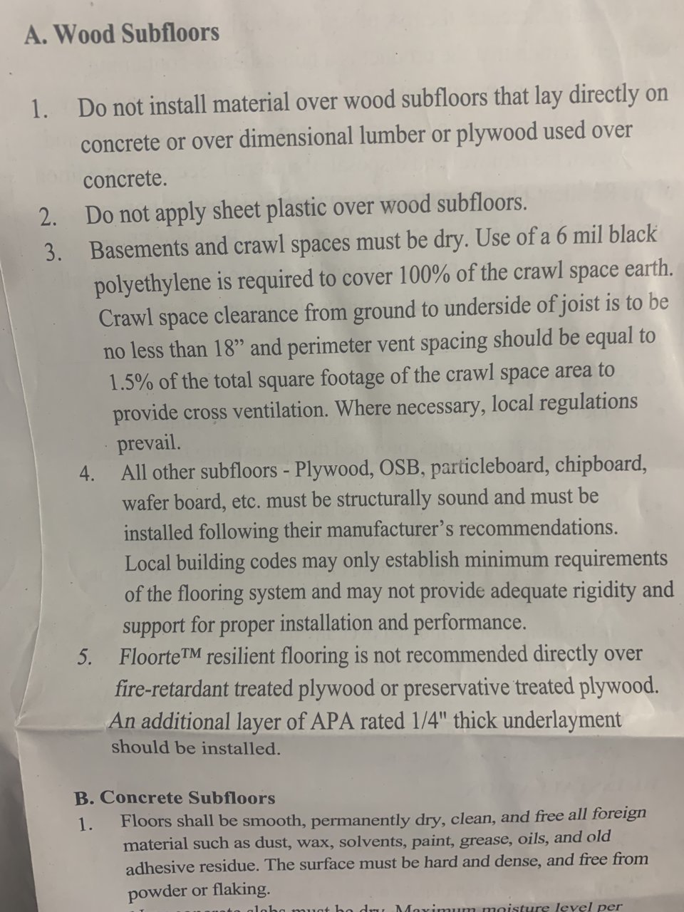

    Okay guys. Quick ?. I’m fixing to lay some of the “Shaw resilient” pop and lock flooring in my sons room. But unsure if I need a backing pad or not. Instructions have me confused. I live in a double wide so the subfloor is wooden. Any help? I’ve done Some googling and haven’t gotten a solid answer.

    my take on what they are saying:
    1) do not lay directly on a wood plank subfloor
    3) crawl space should be dry and protected
    4) if your subfloor is bouncy our flooring bay fail
    5) id your subfloor is treated for fire or bugs/rot it needs a buffer layer
    I'll assume your subfloor is one of the types listed in #4
    truchador and wilcam47 like this.

    Also if theres flex id put a layer of hardi board down then the new flooring. Just make sure you have enough clearance with all layers under doors

    I have plenty of space under the doors that’s no problem. Just unsure if I need a layer of anything under the new floor. The subfloor is 3/4” plywood right-now. Very solid.
    Everything I’m seeing is the only time I need to use a padding under the floor is for either sound barrier or if the subfloor is uneven it will help hide the high and low spots. I’d like
    To start on this tonight when I get off work so any help or advice or pointers would be great. I’m going to undercut the door jamb so I’ll have to pick up a oscillating tool when I get off as well.

    I put foam barrier under mine. Its mostly for sound and i think it softens the step a bit rather than walking around on a hard surface all the time. Much like padding under carpet

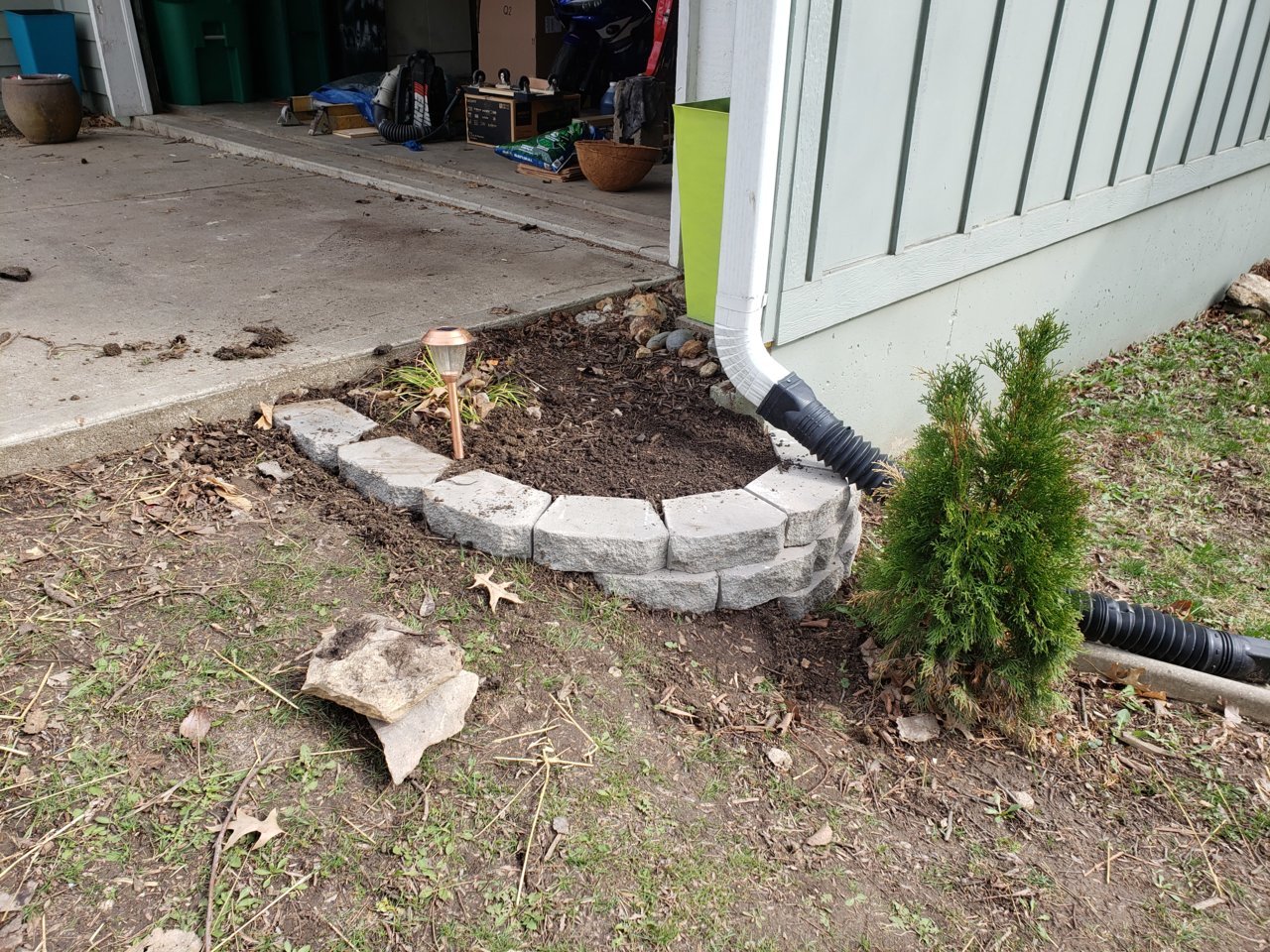

    Not too shabby if i say so. First time really laying them down20210327_162039.jpg

    You’re good to go, install directly on your plywood subfloor if it’s clean and level. They recommend tacking down some luann but I would think this is unnecessary if your subfloor is in as good a shape as you say. Any LVP products I’ve worked with have underlayment built into the planks so don’t roll any foam out underneath them.
    Leave a 1/4” gap all the way around for expansion and cap the gap with some quarter round or pull the baseboard and use it to cap when u reinstall.
    All that scary language in the directions you posted is to make sure any water that gets between the impermeable LVP flooring and the subfloor is able to dry in a downward direction otherwise it might rot your floor
