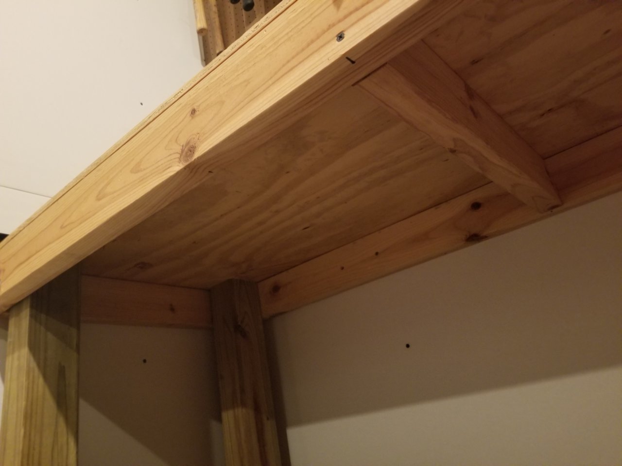

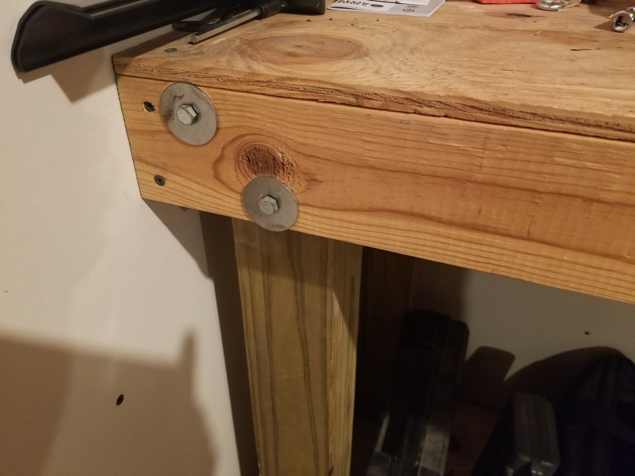

    @Slashaar - Aesthetically not at all what you're going for but my 8' bench comes apart and goes together with 16 bolts, but that's also with a bottom shelf. You should be able to make due with 12 if you add extra legs in the middle.

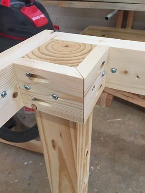

    build a frame like the Jay Bates picture above and either use hardware like he is using or affix the top to the frame with fasteners up into the top through the rails with elongated holes for seasonal movement in the wood top

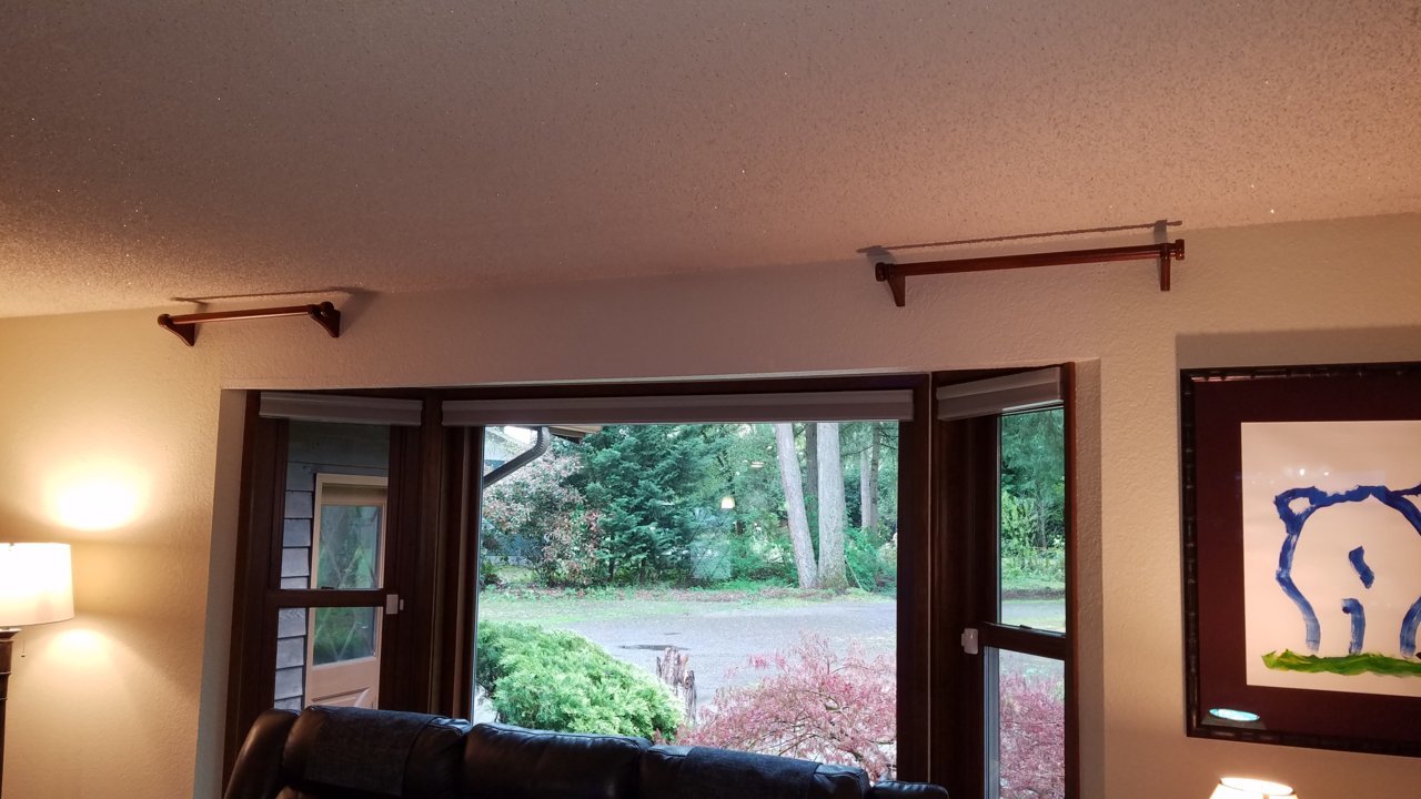

    Only the menliest of men fear not the hanging of linen curtains!
    The two bars in the second pic are DEAD level, but they appear high on the inside due to slope in the ceiling. Contemplating unleveling them to correct the optical illusion. :annoyed:
    Hoping it doesn't look as bad when the curtains go up.

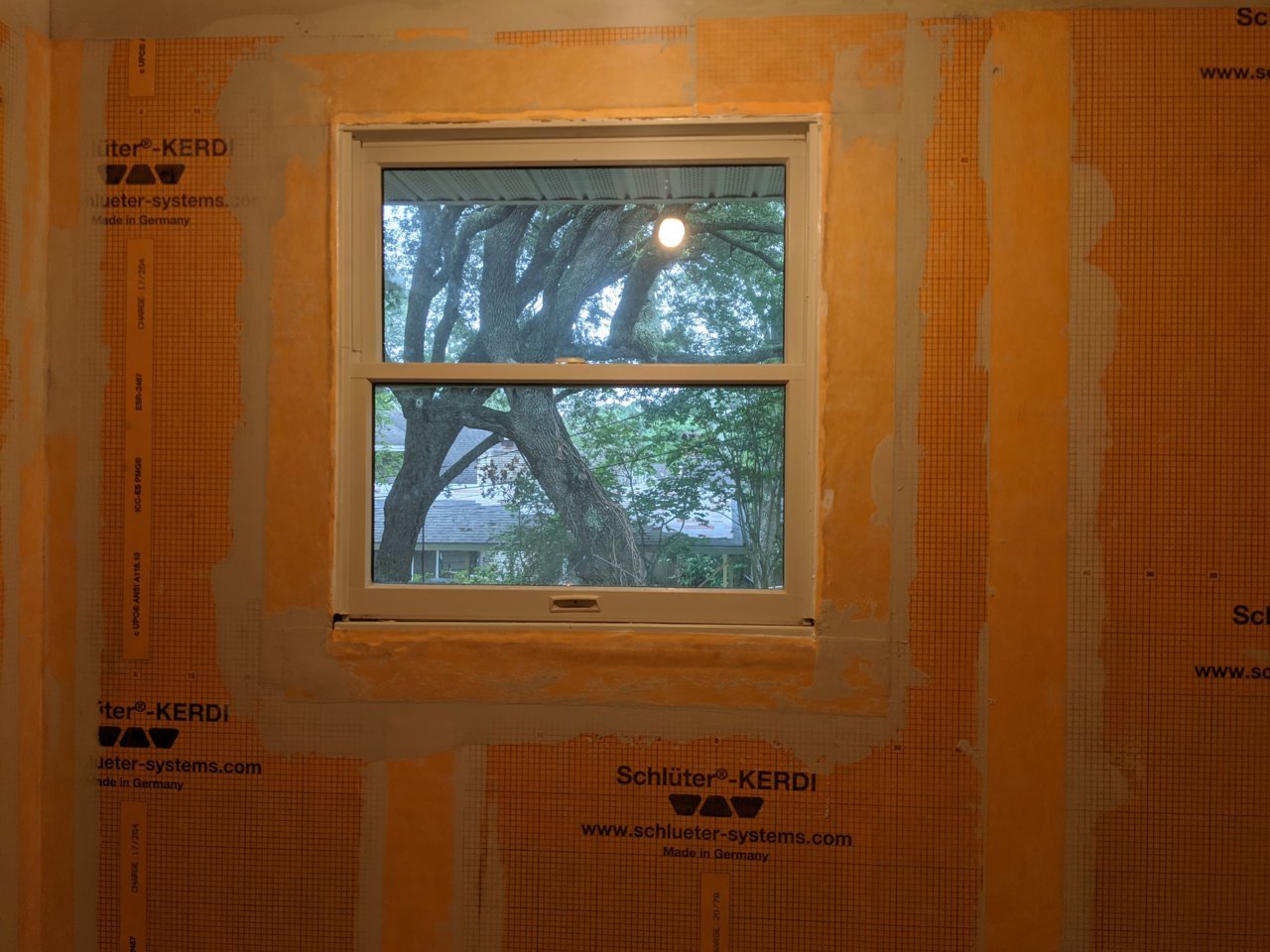

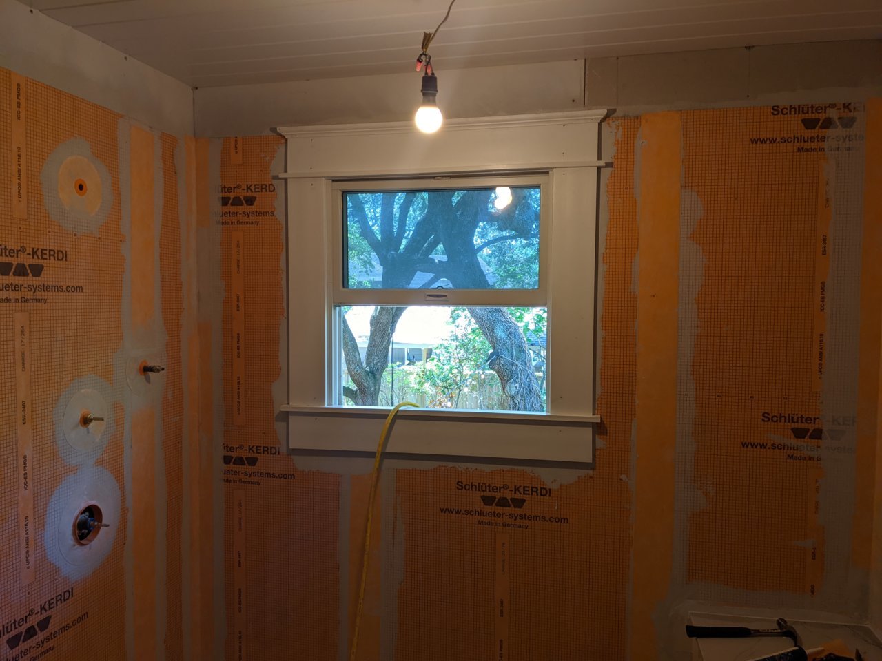

    Working on finishing my master bath. Got the window trimmed (PVC). Hopefully, I can seal it up well enough. Ready for tile.

    Looks great :) and pvc trim would be ideal but wow a window in a shower seems like you’re asking for water intrusion in your wall. Is this a common building practice? How did you flash and seal it? Genuinely curious, always like learning new things lol.

    Sealed it up to the window frame with the kerdi and used kerdi-fix to adhere it to the frame.
    I was initially VERY concerned about this, but I do a lot of 100+ year old home tours and I see this quite a bit. And they use wood for their trim. I'm not crazy about it. It it was the hand I was dealt. The obvious point of entry will be the window seal edges. Caulk and pray.

    That sounds like it should be watertight :)

    Let's hope so. It doesn't hurt that the shower is 48" wide. So...the nozzle is 2' away from the window.
