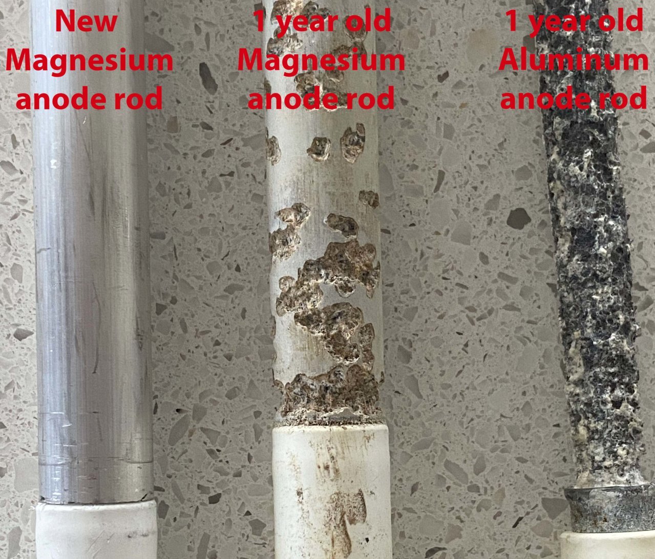

    Another year is gone and it time for annual household maintenance. This year I was looking forward to seeing what the magnesium anode rod in the water heater looked like. As you can see there is quite a difference. The magnesium rod still has 2 or 3 years left in it. Also when I flushed the hot water tank there was none of that nasty jelly like schmoo created by the aluminum rod.
    PLT check your water heater's anode rod. Replacing them isn't hard and they are way cheaper than a new water heater.

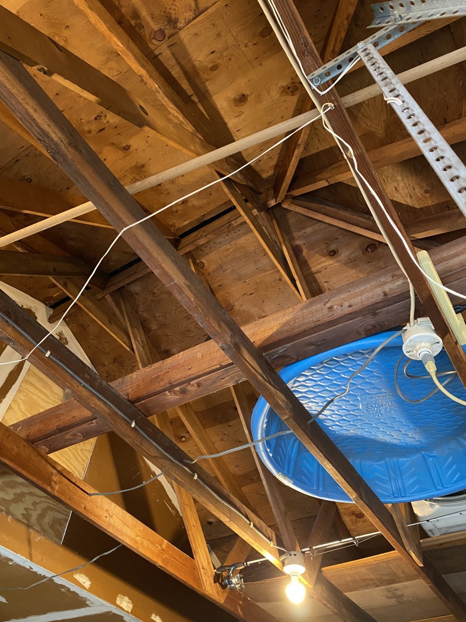

    Looking for some opinions from the weekend structural engineers of the group. I’m picking up an old craftsman jointer/planer this weekend. Cast iron monstrosity that probably weighs upwards of 500 pounds. The plan is to use a come along to lift it just off the truck bed, then lower it to the ground. Now, do I need to wrap my chain around the ridge beam, or will the bottom chord of my 1970’s hand framed rafters suffice?16986842-CCEB-4FA1-B2D1-11EA236AD67A.jpg 16986842-CCEB-4FA1-B2D1-11EA236AD67A.jpg

    Thanks, this reminds me I need to flush my Rinnai tankless water heater again. I don't think tankless water heaters have anode rods though.

    I don’t even stay at a holiday in but if u hang 500# 3’ up from a single point on a rafter with that span you might regret it

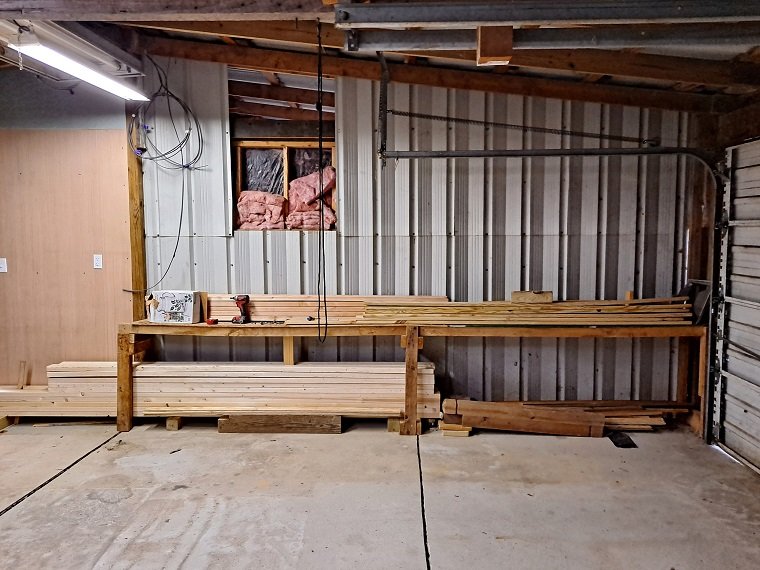

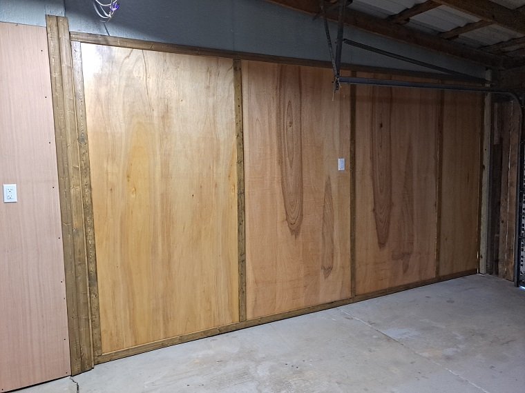

    Took down the metal wall and tore out the nasty shelf in the garage and made a new wall, much nicer now.

    double up a temporary 2x6 beam , lay it so it spans across 4 or more ceiling joists , lift from that

    Thanks, probably should have been more specific in that i would not just pull from a single bottom chord, but would span them as suggested. I figured 500 pounds would not overly tax them, but the ridge beam is designed to displace weight so i wasnt sure if that was a better option.

    Looking at your pics , you have a ridge board and not a ridge beam at the peak of the roof

    yes, you are correct, everything is hipped on the roof, so just a single ridge board.

    What our brother from the north is saying is any weight hanging from the ridge will become lateral load on the tops of the walls as opposed to a ridge beam which would be supported at each end by a post
