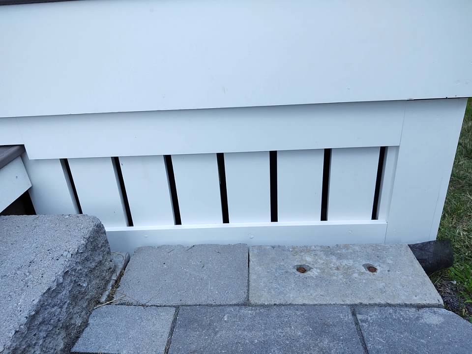

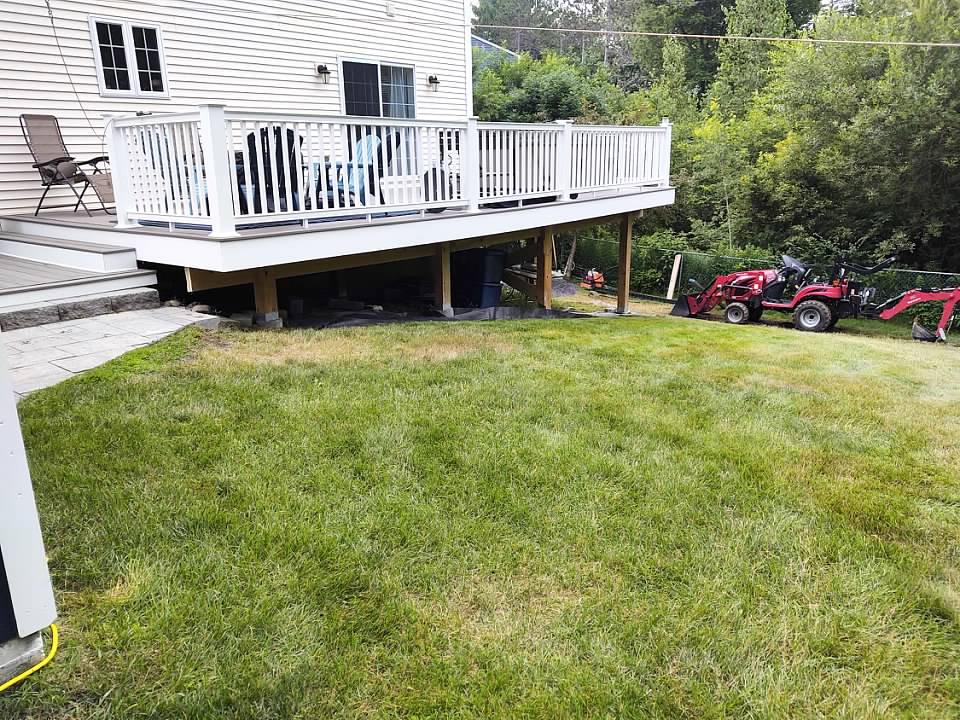

    Wrapped up that deck skirting job today. Estimated 6 days (it's just me), but knocked it out in 4. I hate Azek. Gate is for access to Propane tank. Hung nailers off the rim/band joists and attached 2x6's horizontally off those. Hung everything off those. Added some 1x4 PT to the back of every 6th board to stiffen things up. 1x4 PT nailer (screws) all along inside of bottom edge.
    Before:
    After:
