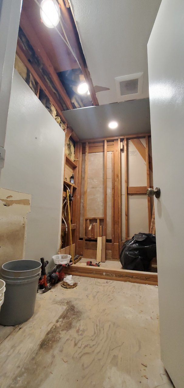

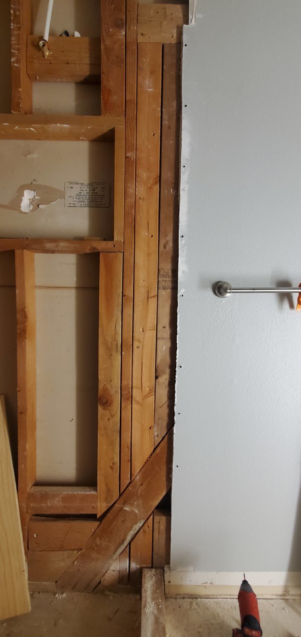

    Crappy pics but last night after work I hacked up a 2x6 to use as a sister stud. I had cut the drywall back to expand the shower stall & needed to support the new drywall edge. Equally important was having a solid point for the shower glass wall to anchor to after the wall is tiled. The fire break above & shear wall below made notching & fitting this 2x6 fun. I'll keep this pic handy for the glass guy to reference when it comes time to install.
    Then I decided to wire in the LED "can" lights before I seal up the drywall. 2 of them are just held in place with wire but the room is a helluva lot brighter than the 2 tube fluorescent fixture I had leaning up in the corner. Now the Hot mop crew should be able to see what they're pouring on Monday!
