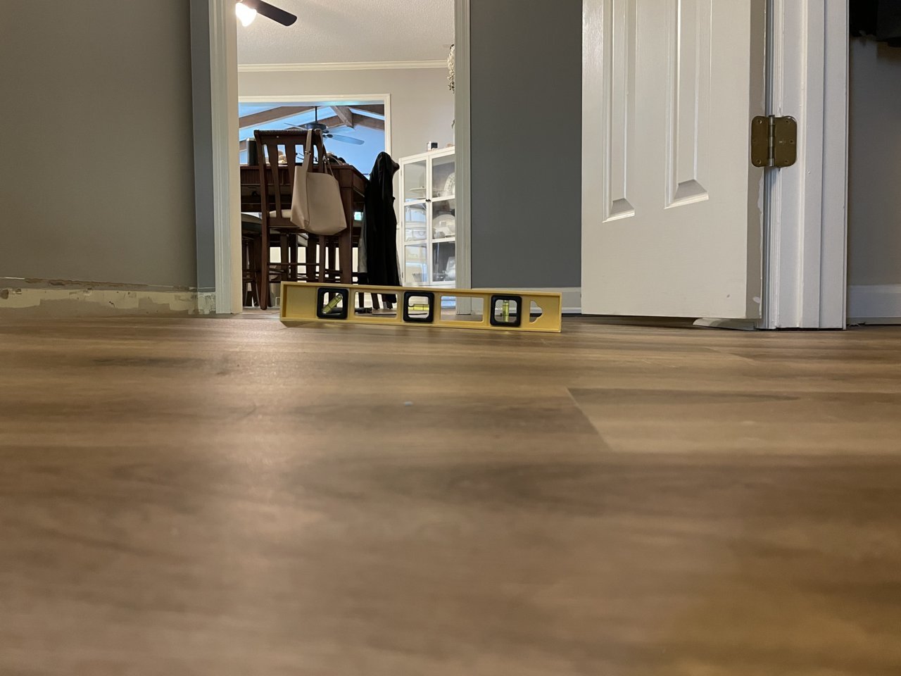

    Ok so what is below that section? Vinyl is very sensitive to heat and cold. From what ive seen. So maybe something warmer there causing that section to swell. Since its vinyl and no wood correct?

    Tough to know without taking up the floor, but is the subfloor arching as well? You say it's floating but is there a chance some genius used liquid nails or something similar to adhere some spots that wouldn't sit flat on their own?

    Only thing below is the plywood subfloor, floor joists, and crawl space. No pipe, no duct, no anything. It is vinyl, not wood.
    Subfloor isn’t arching. It’s literally like an air pocket below the vinyl plank. About 1” at its highest point. You walk on it and sink down and can see and feel the floor move, but it always raises back up. It’s floating. I liquid nails or anything. They installed it so we know every detail to it.
    I installed vinyl plank in my house as well and have not seen this. It’s just wild..

    Was there a backer or padding put down before the lap that could be at fault?

    Is there dampproofing done in the crawlspace? Did they use a moisture barrier underlayment before the plank went down? Was the subfloor nice and flat?
    That “waterproof” vinyl plank is anything but. If you’re certain expansion room isn’t the culprit then floor flatness or moisture are the only other two variables. I deal with with this stuff constantly in my line of work.

    Nope. Just the underlayment connected to the vinyl plank itself.
    The vinyl has the underlayment layer attached to itself, or so advertised. I don’t believe they have any damp proofing in the crawl space, but not sure. It’s cool down there, but not damp. I’m no expert on that stuff. Why would that be affecting just this one specific spot like that? And how is it reversed/prevented?

    Moisture is a weird and unpredictable thing in flooring. You could have one little spot with issue, or the entire floor, it really all depends. Usually when the floor starts going upward, it’s trying to expand and has nowhere to go but up. It’s possible it is gaining moisture in and around that spot and those planks are swelling. I’d also see how that quarter round is installed. If the nails were installed into the floor and not into the baseboard, that expansion gap isn’t doing what it’s supposed to anymore.
    It also could be that the subfloor has a little dip there and walking on it has broken the click mechanism in those planks, that will make them bow a bit as well.

    The nails are into the baseboard only, and that is “above” the flooring. The gap should definitely be doing what it’s supposed to.
    to the best of my knowledge there is no subfloor issues, but maybe something slight. I know this is a big enough bump/air pocket/etc that it seems like it would be something much more drastic

    Might be time to do a little destructive testing and see what’s going on in that spot. Popping up those planks might just answer all the questions!

    Yeah they were trying to avoid that haha.
    do you think a dehumidifier in the room or maybe in the crawl space would possibly help? Just to see if it makes it go down or go away
