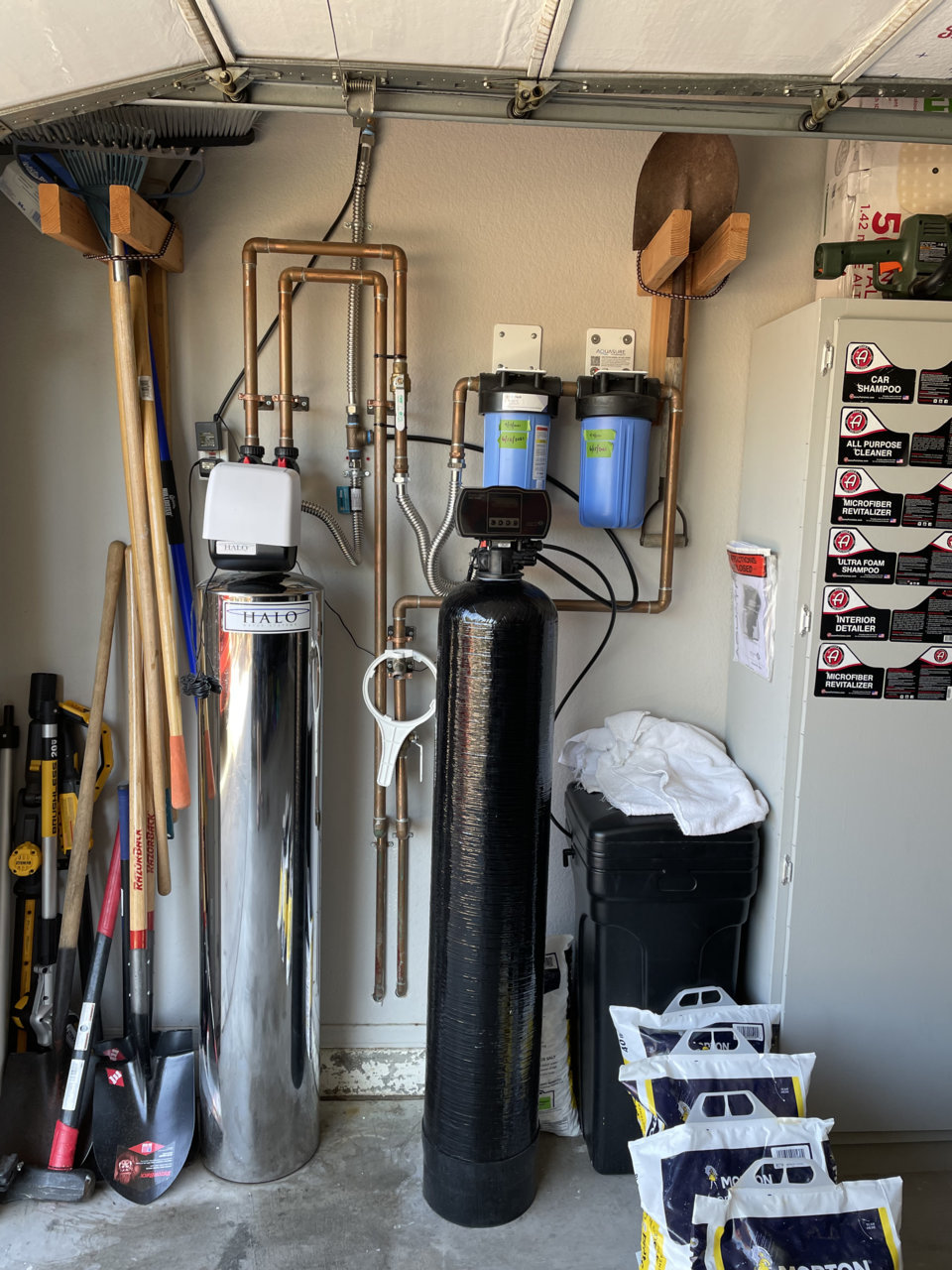

    If you're running the fleck softener only you need inline sediment and carbon pre-filters. Sediment filters will keep debris out of the resin tank and the carbon will filter smell, taste, and bacteria.
    Have you tried regenerating your fleck system again to see if it clears it up? You can use potassium or salt. Potassium is supposedly healthier, but we use Mortan Salt softener pellets. I would think the taste is from the untreated water, possibly the resin itself, or something other than the salt. Have you considered a reverse osmosis system in the kitchen? They're about $200-$300. https://aquasureusa.com/collections/premier-reverse-osmosis
    Our Phoenix city water is awful, so we've first purchased a Halo 5 whole house water filter/conditioner. It removed the chlorine and some other junk from the city water, but we still weren't satisfied. So we added an Aquasure 48k grain softener (pretty much the same as fleck) and an additional inline wall mounted sediment and carbon filter. I also have a DI Rinse Pro-100 ionized water tank (not in picture) for spot free car washes.
    If I were to do it again I would have never bought the HALO 5. It's really over priced for what it does or doesn't do rather. I would have done sediment filter, carbon filter, and then the Aquasure softener or even one of Aquasure's "Fortitude whole house water filters" before the softener. (It's basically a giant sediment and carbon filter.) https://aquasureusa.com/collections/fortitude-whole-house-water-treatment I probably would have gone one size larger on the softener too like to 60k grain. Ours regenerates about once a week as does the HALO 5.
    Yard tool racks were installed before the water system, so excuse the mess...

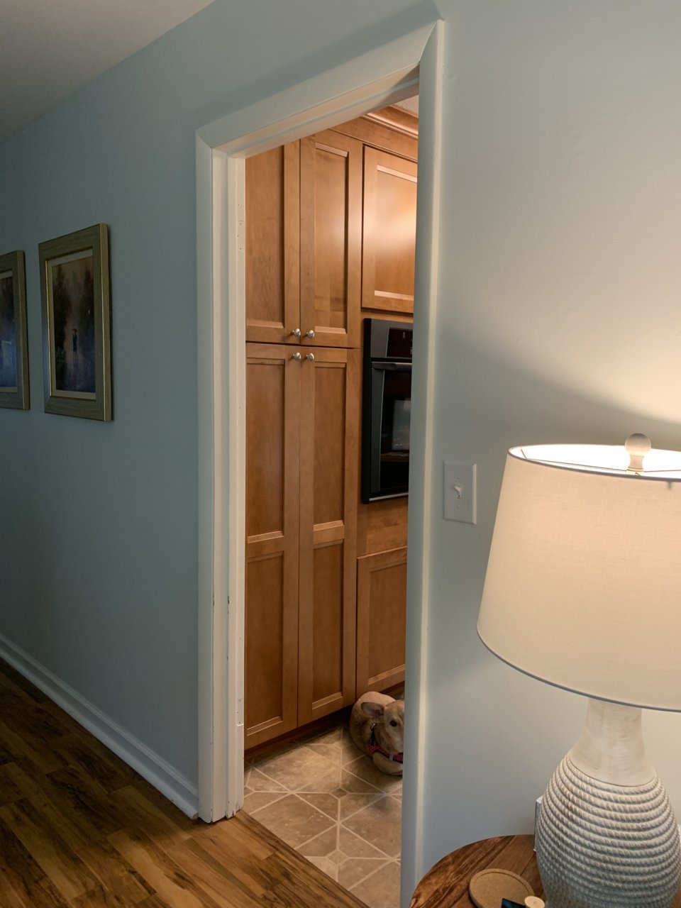

    Next project will be removing this door frame between the living room and kitchen.
