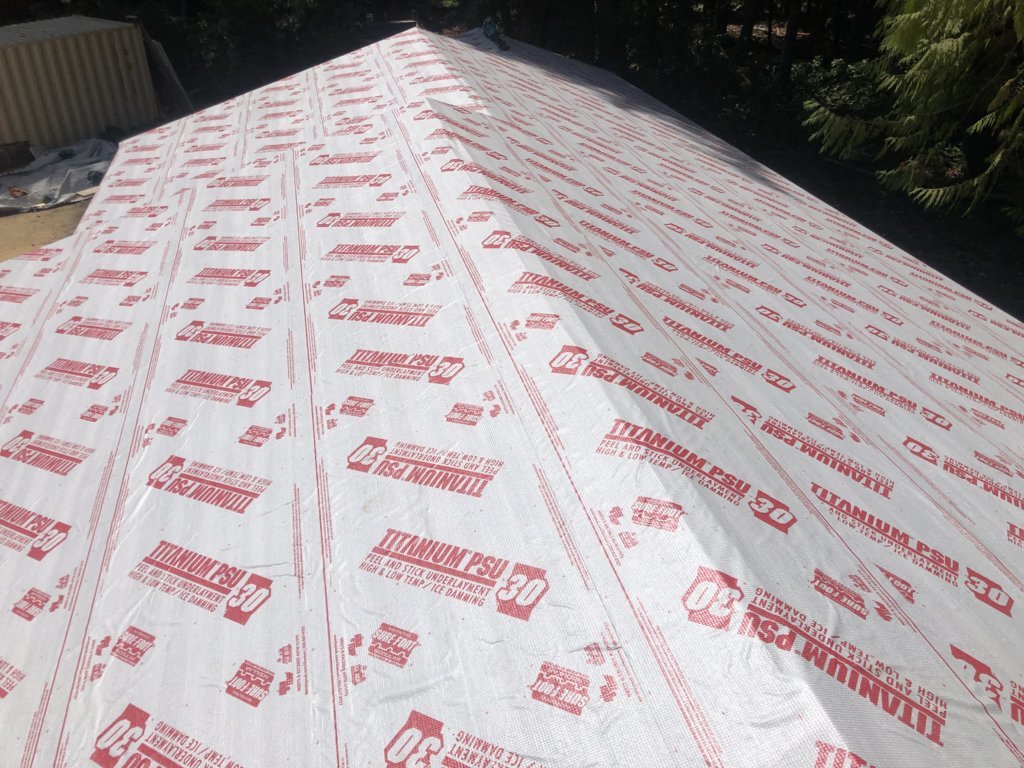

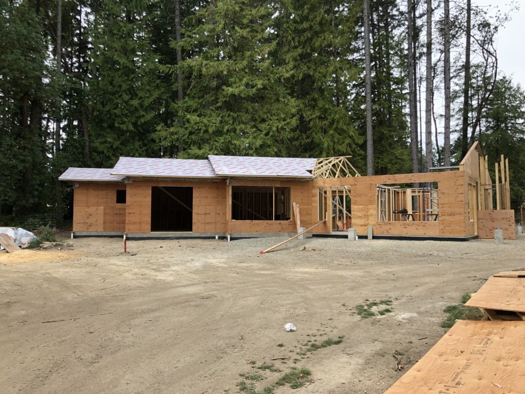

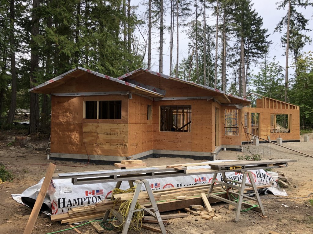

    Decided to sheet truss section of house roof and apply the peel & stick before starting to hand frame vaulted rafter section over kitchen end . Finished that up today .
    Start framing kitchen end of roof tomorrow .

    Nice. Clean job site. Having a clean job site is one of my pet peeves. Way less likely for someone to get injured and it just makes you look like a professional.
    What's the ridge detail for the vault?

    Harder for lumber to get stolen if it’s not laying around too. That’s becoming a serious issue around these parts.

    I agree
    Structurally ? Its a 2 ply 1 3/4" x 16" LVL ridge beam from an interior seismic rake wall on interior foundation stem to beam crossing the opening in the exterior rake wall , free span is about 18' . Rafters are 2x10 on 2' centres with perpendicular and parallel 2x4 strapping then 1/2 plywood
