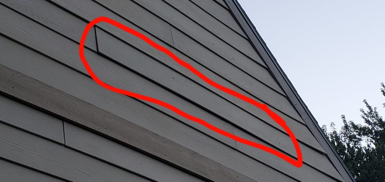

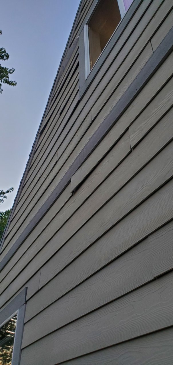

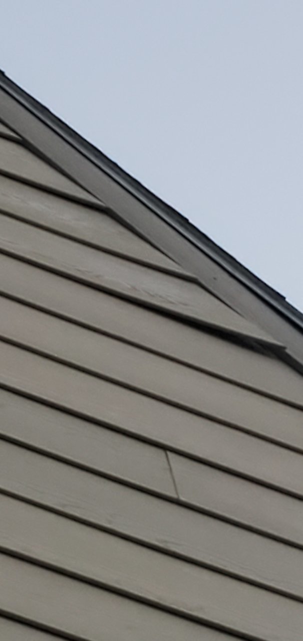

    Siding was installed in anywhere from '13 to '15. I'm also concerned with the gap between butt joints on the siding.
    Here's a couple pictures.
    Here's an example where the tails are curling. The house inspector actually called this out and even noted that the siding was installed with 20ga x 1" staples.
    Here's a piece where the field is bowed out from the wall. I really don't want bugs/wasps building nests behind the siding.
    More curling where the fastener has been pulled out.
    I also have several places where the siding is broken or a whole piece missing, so my head is :boom::bananadead: while trying to figure out how to replace and blind nail the replacements in place without removing the whole field above the missing/broken pieces.

    Open butt joints allow for thermal expansion. There is supposed to be flashing behind the joint
    Staples lol I hope some good nails will fix it. Are the exposed pieces damp or kind of crumbly? What is beneath the siding?
    If you could get a pic showing the top of the leaky window up to the eave
    And a pic of where the leaky dormer runs into the roof line
    It might could help diagnose leak
    as far as fitting new pieces in they will be fine just face nail the next row up thru the top edge and face nail the bottom

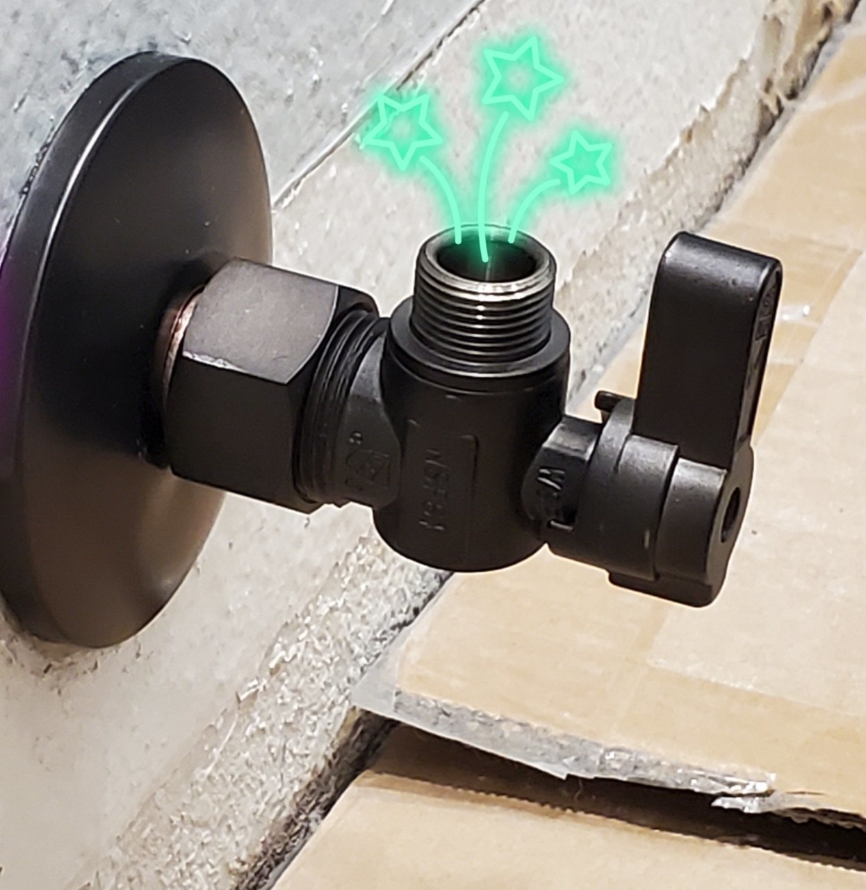

    Murphy's law came in to play today so I spent most of the day running to the store replacing parts. Couldn't get a 3/8" reducer for the 1/2" supply valves so I just replaced them. Then spent 2 hours chasing a slow leak from both of the new faucet supply valves. But the sink is now 100% operational! Then I swapped out the 80s chrome toilet valve for a matching oil rubbed bronze unit, that also leaked and required 3 re-torques. Cleaned off the old wax mess & sat the toilet in place...only to realize the bolts needed to be replaced. So for now it's in place for the picture, tomorrow I'll tilt it forward & swap the bolts. Maybe even get the shower functional. Wiring the vanity power outlet to the dimmer switch was a dumb oversight on my part, it keeps tripping the GFCI so I need to get in the attic & run it to the J box where the fart fan is hooked to. Me & the ol lady spent a bit of time literally standing in the new shower smiling ear to ear enjoying the new look & space.
