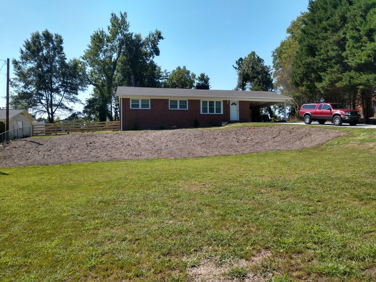

    Not too shabby for never having built a fence before.
    Really cant wait to keep going up the side. But unfortunately money is not an endless resource.
    :annoyed:
    Got quite the new look though.

    Looks good. Did you concrete the posts in or just bury them? Are you going to apply water sealer or stain?

    Dug down about 20" and used roughly 30 lbs of sakrete for each post. Ill let it dry out and then seal it probably next spring when I hopefully have all the fence done (160' ish of new, 100' existing)

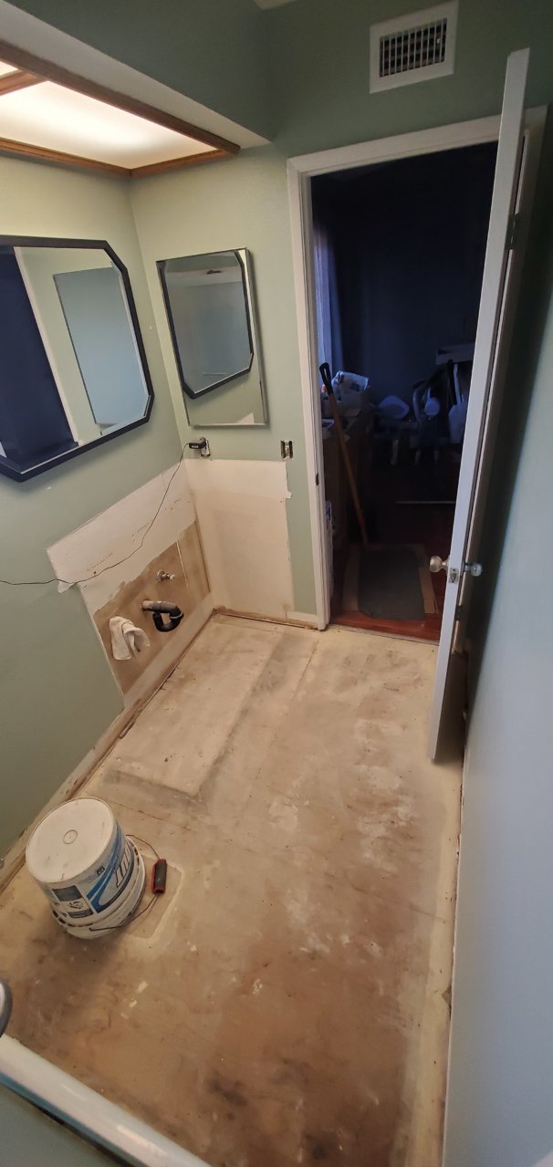

    Took out the camode, tile & Hardi board today. My hands & back are shot, thankfully the ol lady had a fantastic dinner & craft beer waiting for me when I got out of the shower. Tomorrow I'll start on the soffit, dunno if I'll finish it since this place is built like a tank with all 2x6 framing (even on the soffit!).

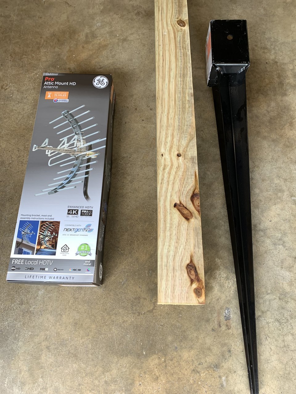

    Screw cable, and the big stations shut down Locast. Trying a different approach. Picked up stations from 85 miles away but not the ones we wanted which have antennas 25 miles away.

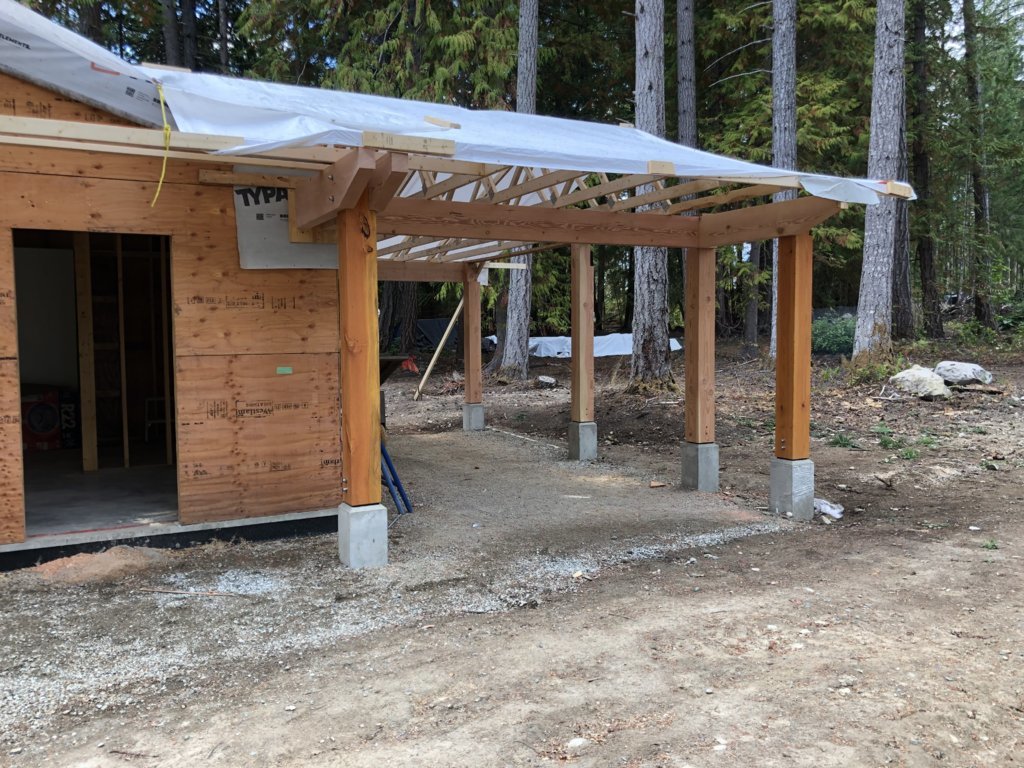

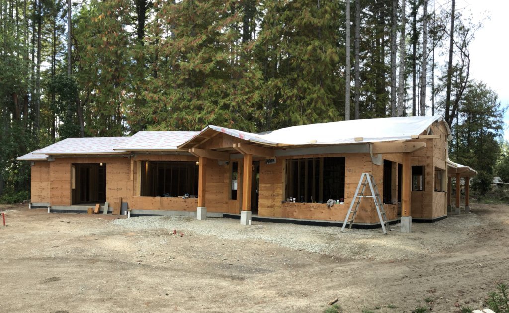

    Got most of my timbers in now.
    We framed the roof over the formal entry, installed one of the load bearing timbers on either end of carport so we could install the carport trusses and I just need to finish up the last couple timbers in the carport and we can complete the carport gable end.
    Final roof section to finish up is some exposed 3x9 fir rafters around the kitchen bump out then we can complete roof sheathing and peel & stick.

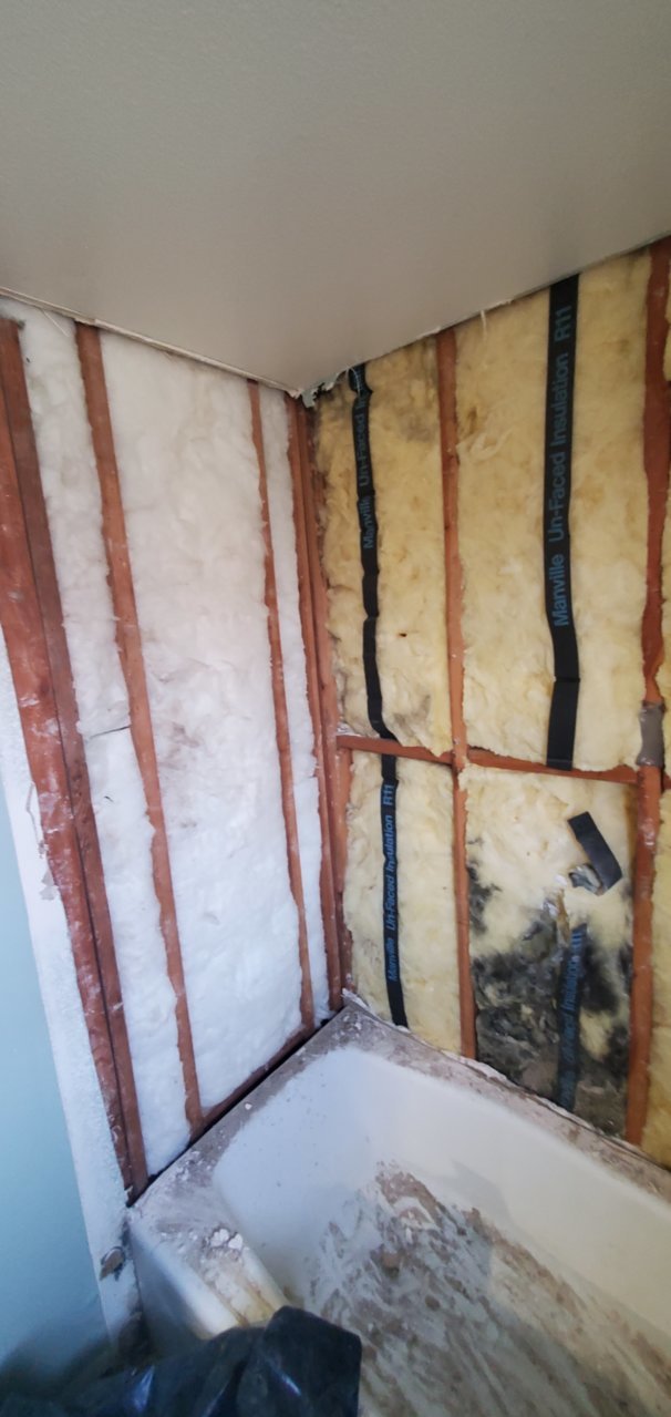

    With morning visits to the maternity ward, 7ish hours working from home, a couple hours of demo, then evening visits to the maternity ward I'm flat exhausted. But I'm getting thru the demo. Today I finished exposing the forbidden cotton candy around the tub. Doubled up 5/8 drywall all around makes it slow progress...but next up is the soffit! No, the dark spot on the right is not mold. I'm not really sure what it is but it's where the soap caddy poked thru the wall. Looked like Helen Keller cut the opening for it.
    Ok, off to bed for my 4 hour nap now.
