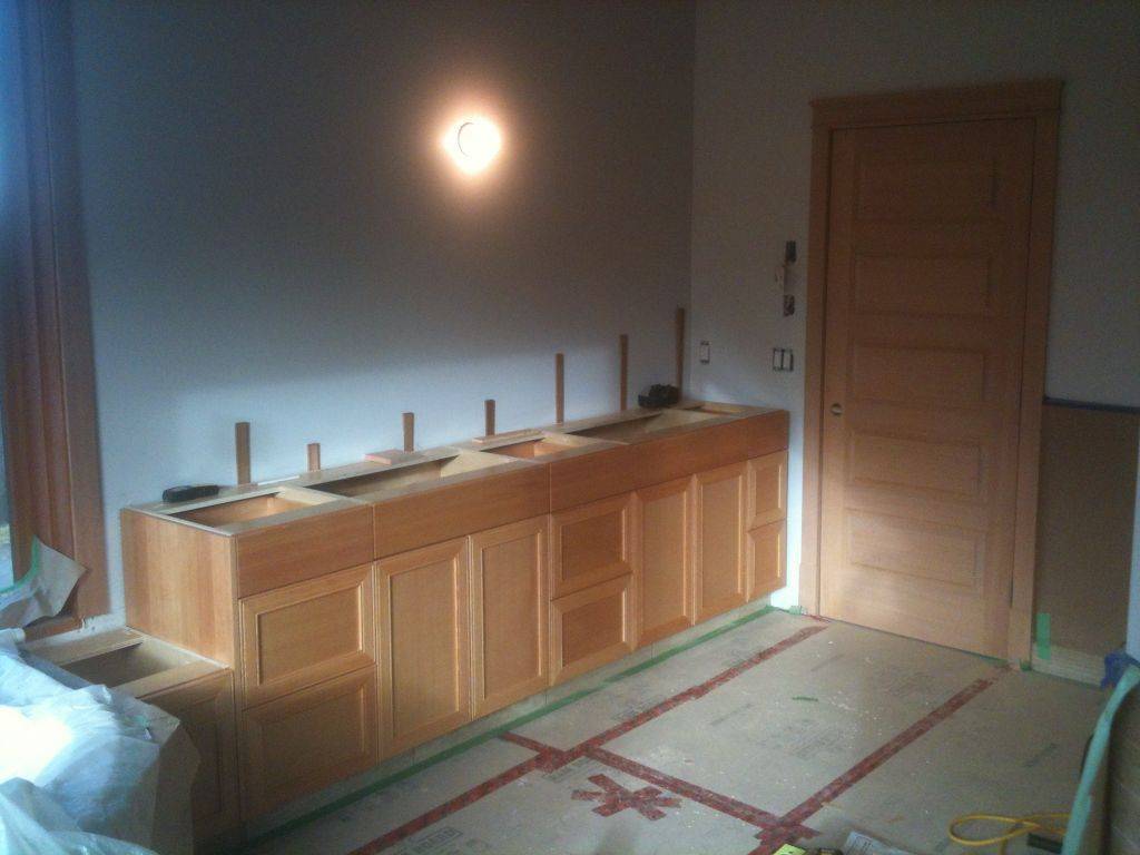

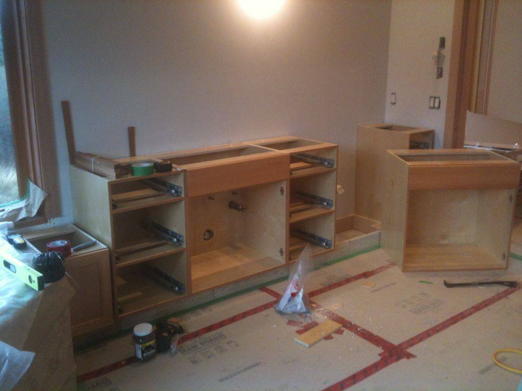

    This is what I was working on today , install of some Fir cabinets in my client's ensuite

    very nice

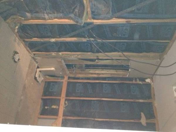

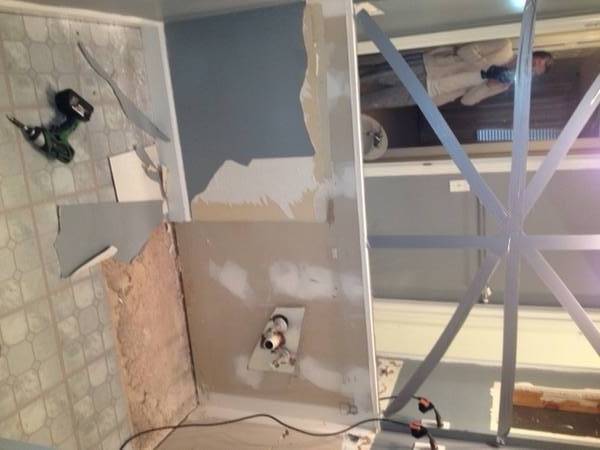

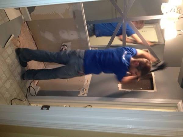

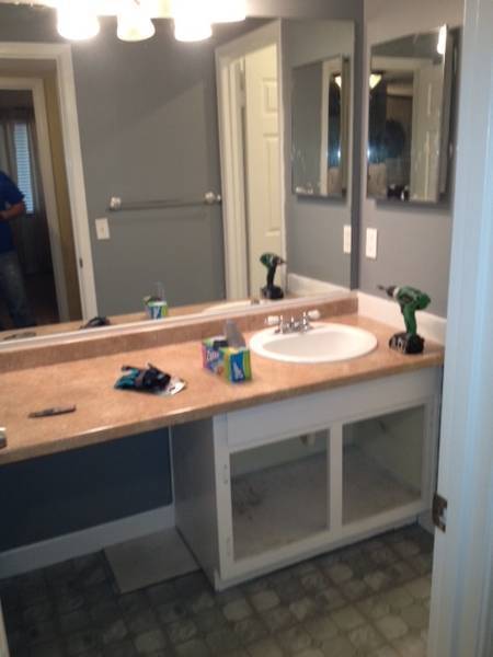

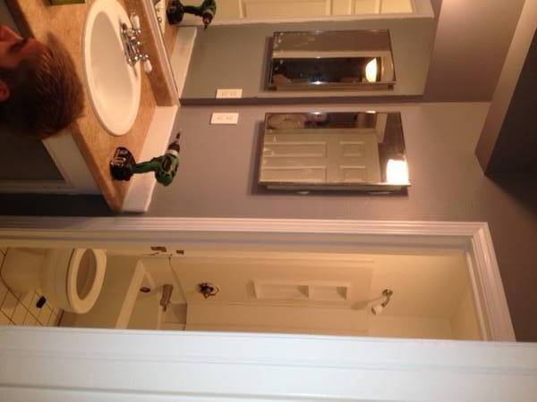

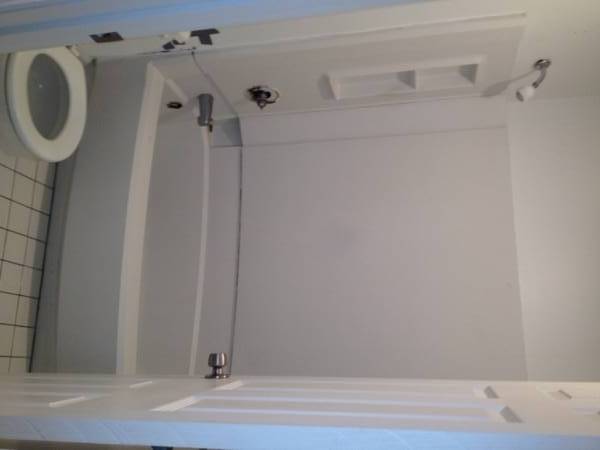

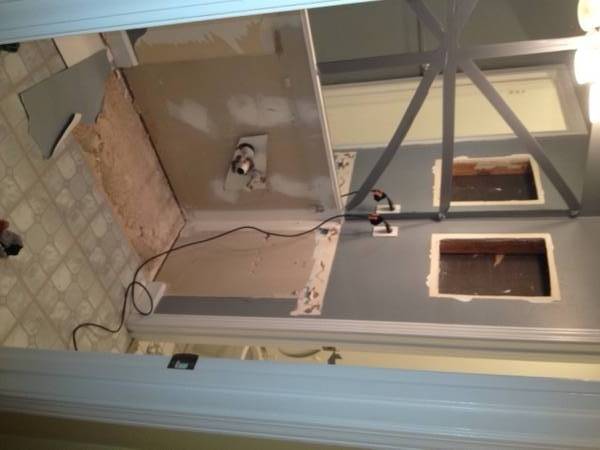

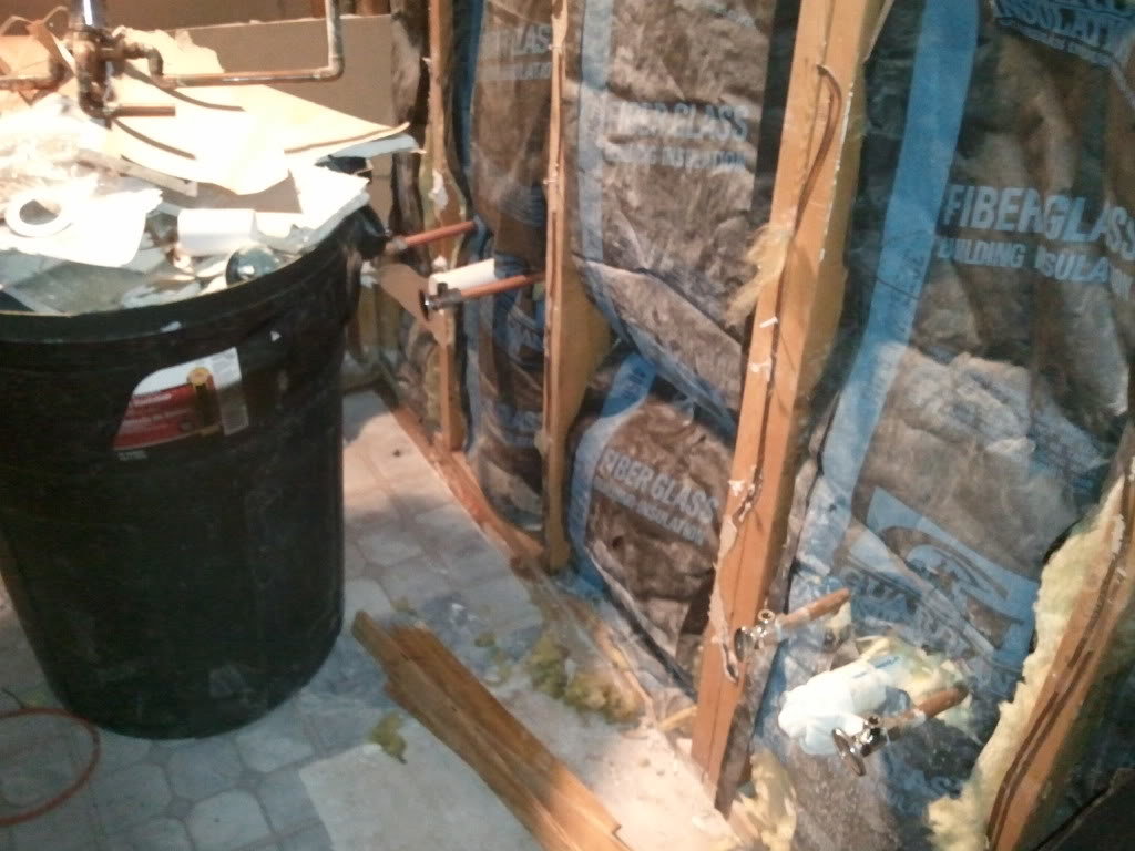

    Demo'd the bathroom at my Girlfriend's condo this past weekend. Plumber comes tomorrow to rough in the new tub, plumbing for second vanity, and new shower valve. I could do all the plumbing myself, however she was adamant on having a licensed insured plumber do the work since she's in a 2nd floor unit in case anything goes wrong.
    The room originally had a partition wall with a door (very awkward) and a random soffit over the vanity. It will all be one big room once it's done. We're doing two seperate 30" vanities, all new fixtures, new toilet, tile floor, tile tub surround.
    Next step is tear up the rest of the old flooring, re-wire the bathroom, then drywall, then kerdi the tub surround, CBU on the floor, lay tile, then trim, then paint, then install vanities, new toilet, and finish work.

    Nice
    Just look away from the mirror when you rip it out , you'll be fine .
    Haha

    Haha it came down in pieces, no cuts or scrapes occurred fortunately. Whoever installed it used the mirror putty and construction adhesive.

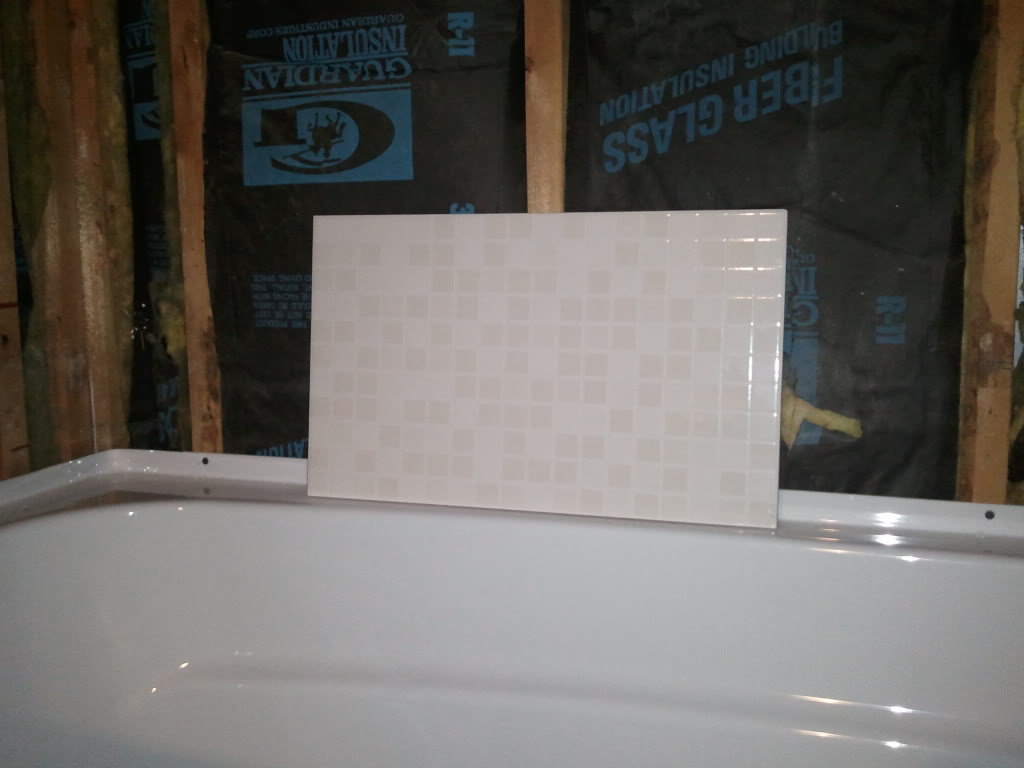

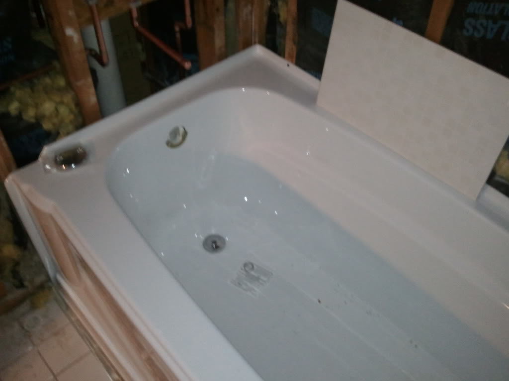

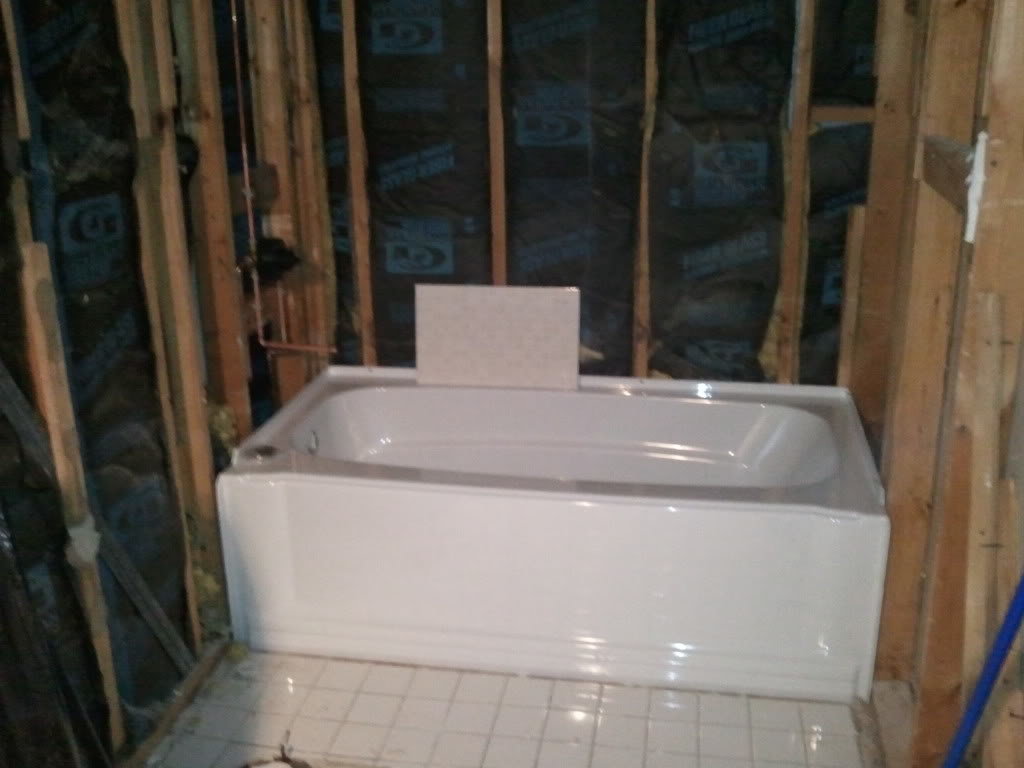

    Plumber came on Friday and roughed in the plumbing for the second vanity, roughed in the shower valve, and installed the new tub.
    We ran into a little snag because the main water shutoff outside wasn't completely shutting off the water. In her condo, they all share the same water (4 units). Fortunately we found a spigot outside downstairs that was able to relieve the little bit of water pressure still flowing and allow water to drain from the upstairs pipes enough so they could do their soldering.
    A shot of the tile going up on the tub surround next to the new tub.
    Next weekend the plan is to rip up the combination of ceramic and stick down tile on the floor, re-wire the bathroom, shim out the walls, and drywall.
