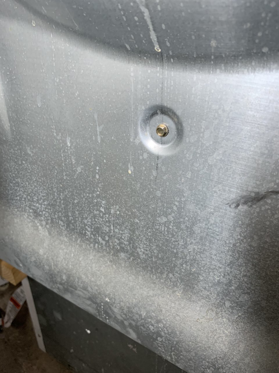

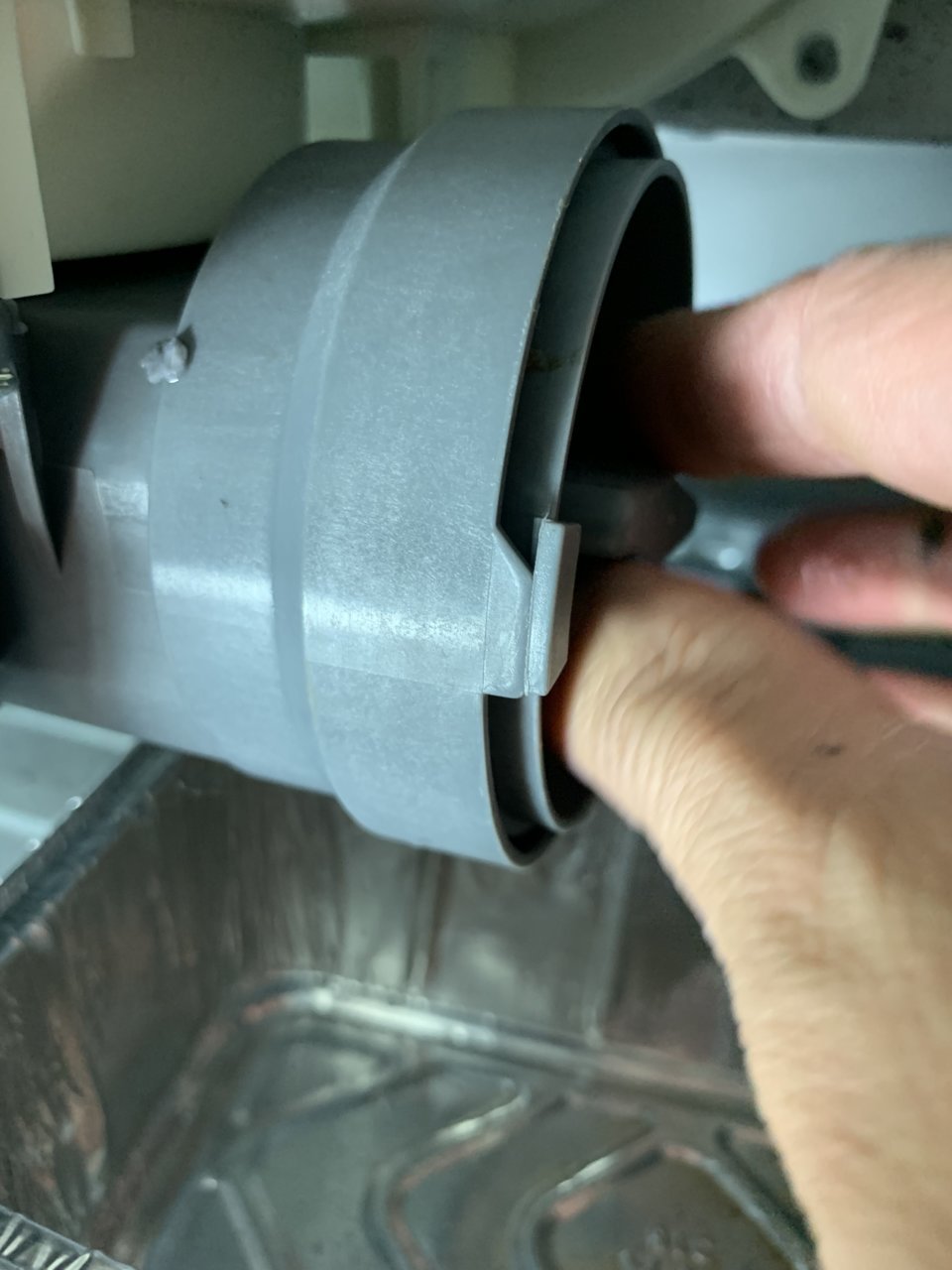

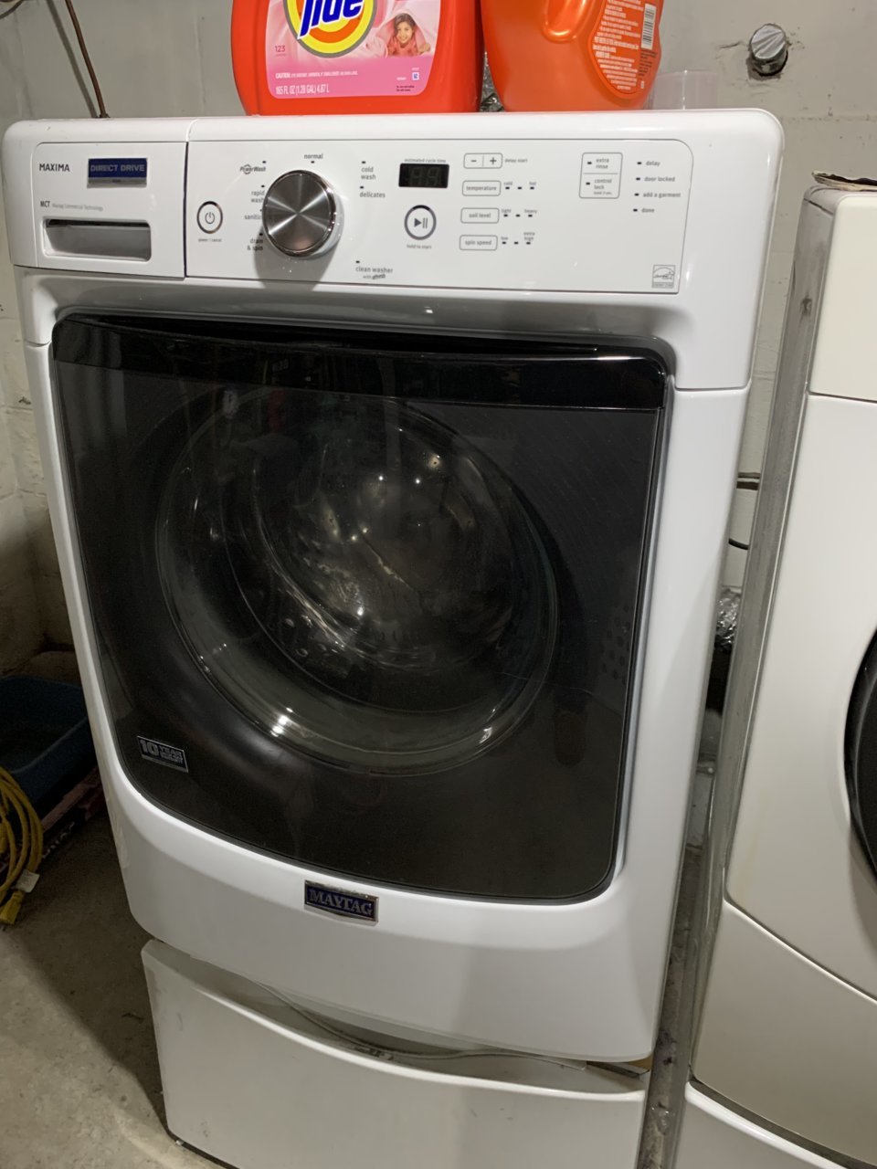

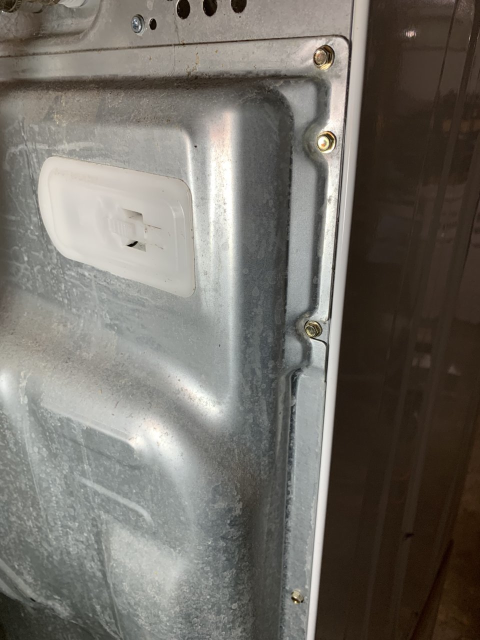

    Thought I would post this here for anyone else that might see this problem. Wife was complaining the front load washer is giving a F9 or E1 error code which also locks the door and you can’t open it. It’s really easy to fix. Took about 15-20 minutes. Take off all the bolts on the back around the outer edge and don’t forget the one in the middle. Sorry I don’t know how to post pictures with the information above them so I have to do them separately.

  8. Sep 18, 2021 at 6:48 AM
    williams63
    williams63 Well-Known Member
    Feb 29, 2012
    #73898
    6,402
    chili
    nh
    2011 dblcb
    boss-c/o, boss rear leafs

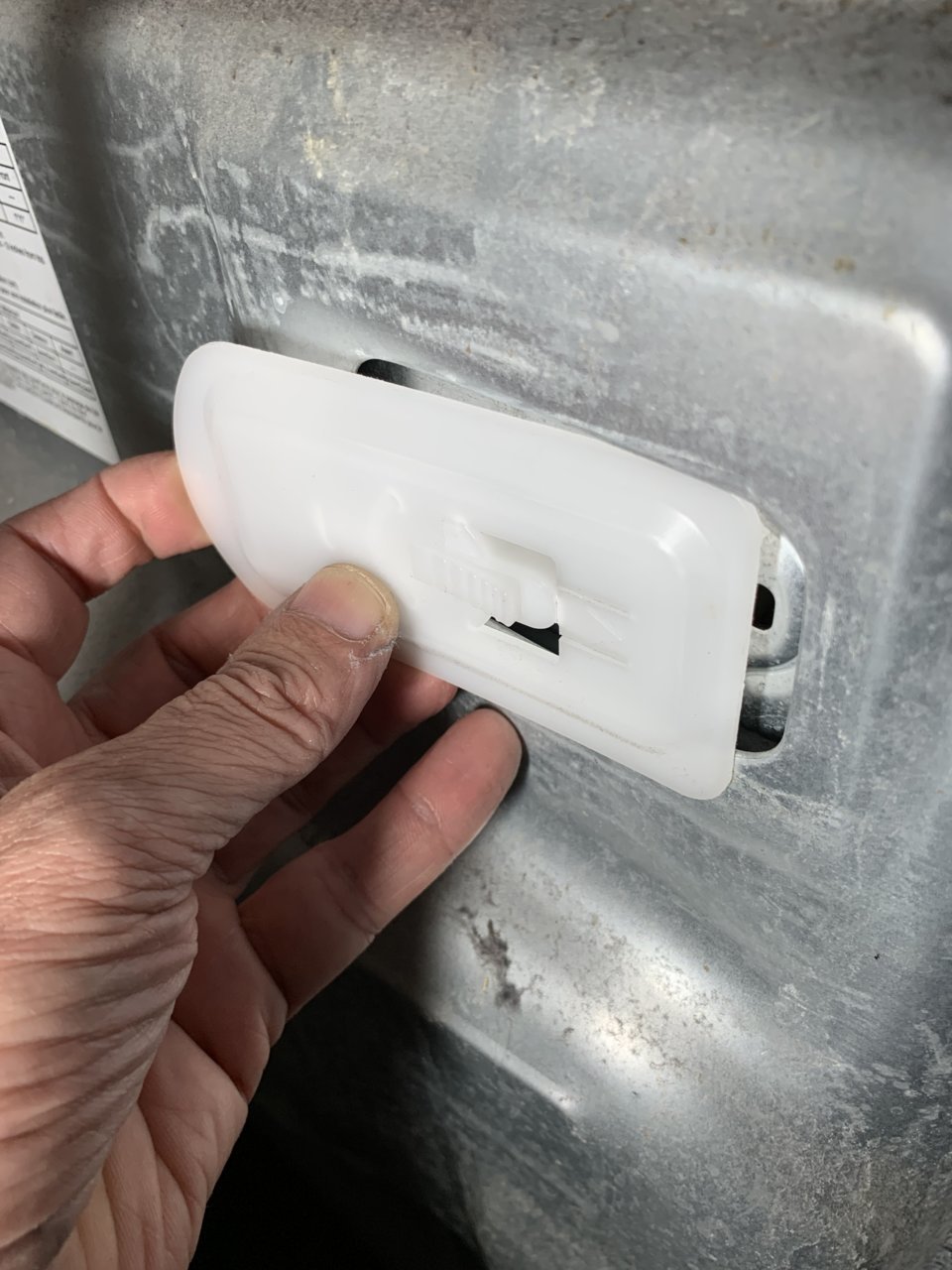

    Take these plastic clips off the 4 corners and the back should come off. Don’t forget the one bolt in the middle.
    Slashaar likes this.

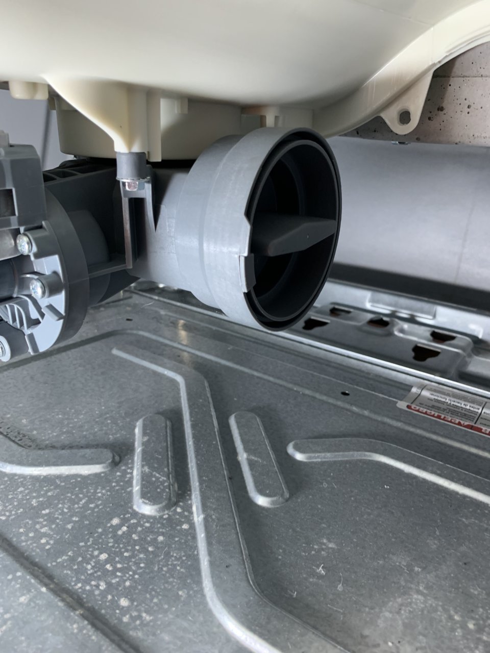

  10. Sep 18, 2021 at 6:51 AM
    williams63
    Feb 29, 2012
    #73898
    6,402
    chili
    nh
    2011 dblcb

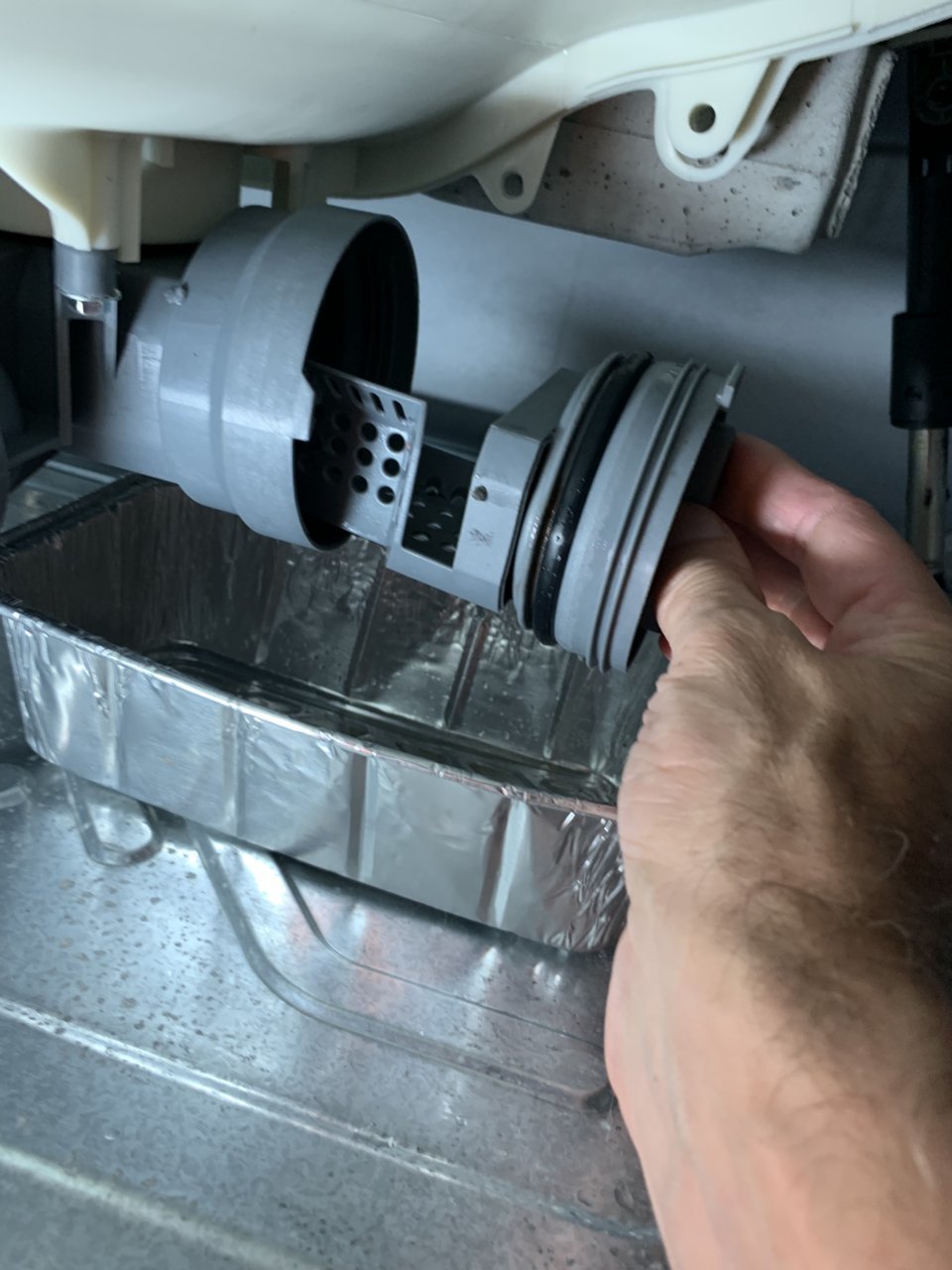

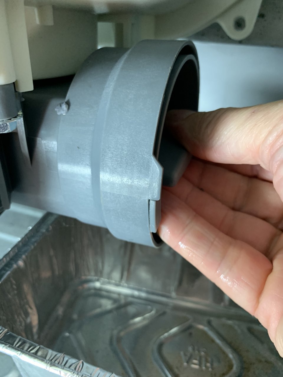

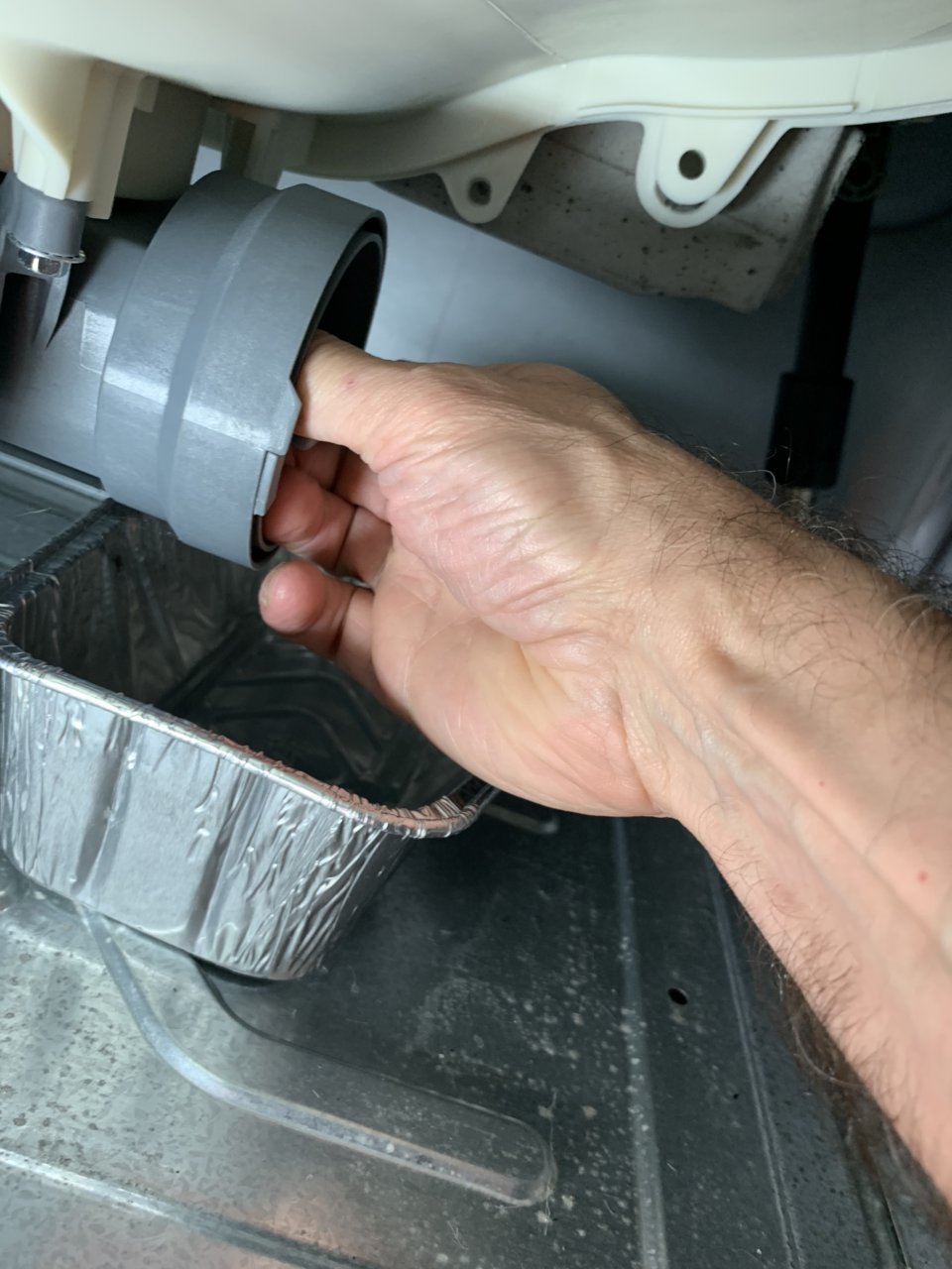

    Looking inside from the back you can see the plastic pipe attached to the pump. Put something under it to catch the water and reach in and turn the handle on the end of it and it will pull out a odd plastic filter.
    Slashaar and wilcam47 like this.
  11. Sep 18, 2021 at 6:55 AM
    williams63
    Feb 29, 2012
    #73898
    6,402
    chili
    nh
    2011 dblcb
    Didn’t get a picture off all the crap that was in it but, if it looks clean than the pump is on its way out. Push it back in and turn to tighten it. There is a plastic tab that will let you know when it’s fully tight. Put the cover back on and your good to go. Don’t know why they couldn’t put this sticking out the back to make it easier.

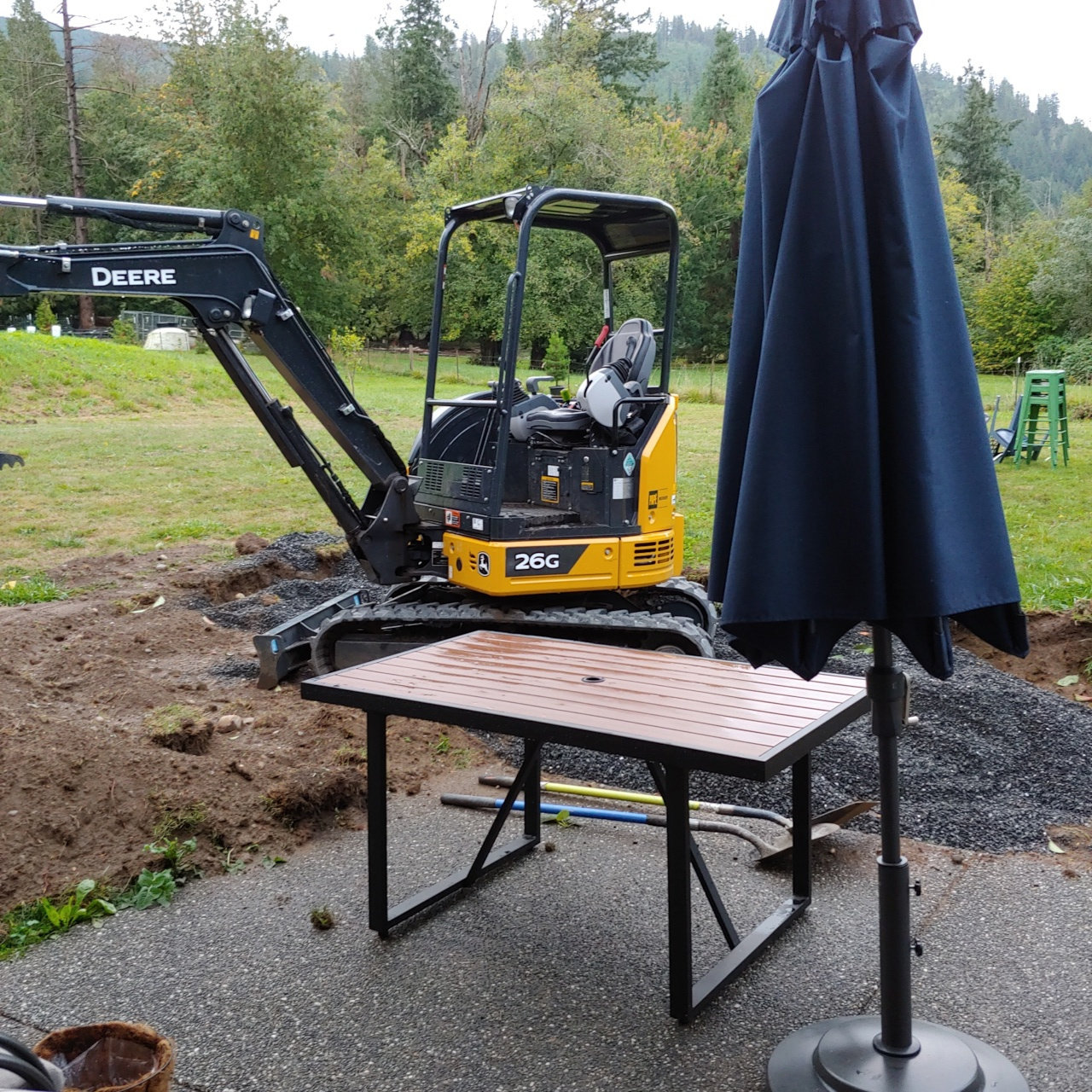

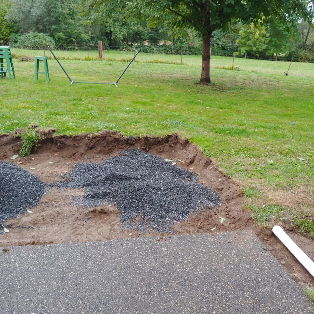

    Project on hold for rain and wind. Wait a couple days...........needs to drain and dry

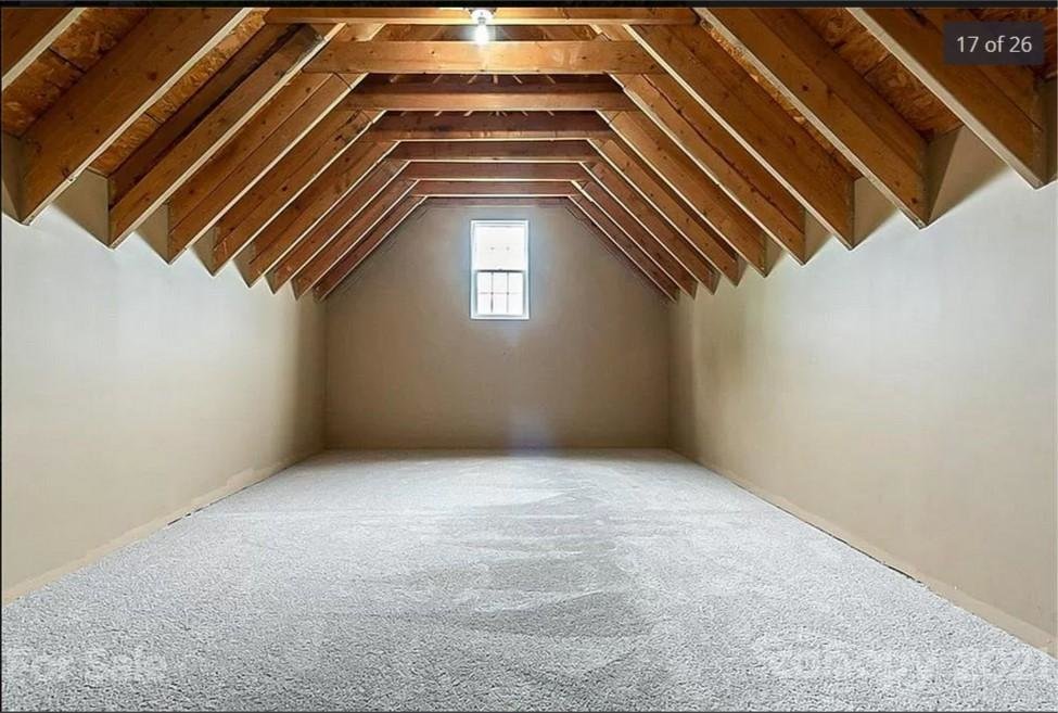

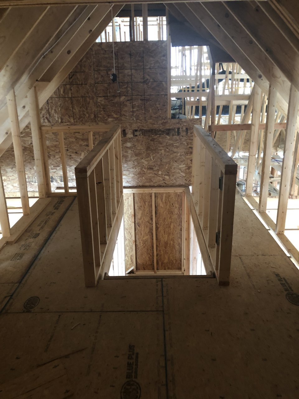

    Okay our new house has some attic storage above the garage with walk up stairs and I want to insulate the front wall would I be okay just putting some R-30 in the stud bays and putting drywall over it and going all the way to the roof deck like in the 2nd pic 2 I would like to insulate the roof side as well??

  17. Sep 18, 2021 at 9:11 AM
    IPNPULZ
    IPNPULZ Well-Known Member
    Jun 16, 2014
    #132087
    13,855
    Deeper in the South…….
    2023 TRD Off Road Premium 4R
    going to be fun!
    The amount of space is huge 250/270 sq ft

  18. Sep 18, 2021 at 9:21 AM
    Toyko Joe
    Toyko Joe Here for the pictures
    Sep 19, 2014
    #138654
    5,296
    Are you going to keep the rest of the area open to the garage climate or is this a separate area entering from a conditioned space?

  20. Sep 18, 2021 at 3:56 PM
    Sig45
    Sig45 Well-Known Member
    Jun 21, 2012
    #81045
    23,779
    Mark
    Maine
    Is there a ridge vent in the garage?
