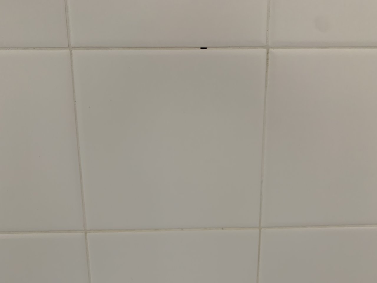

    Yesterday I found a bit of missing grout in my shower. It’s one small spot at about waist height. How should I fix it?

    They have some color match grout in caulk tube.

    Grout it. I'd also get a grout removal tool and see how far front/back that improperly filled section goes. Once you find out where the void stops just mix up a tiny bit of grout and stuff it back in that section.

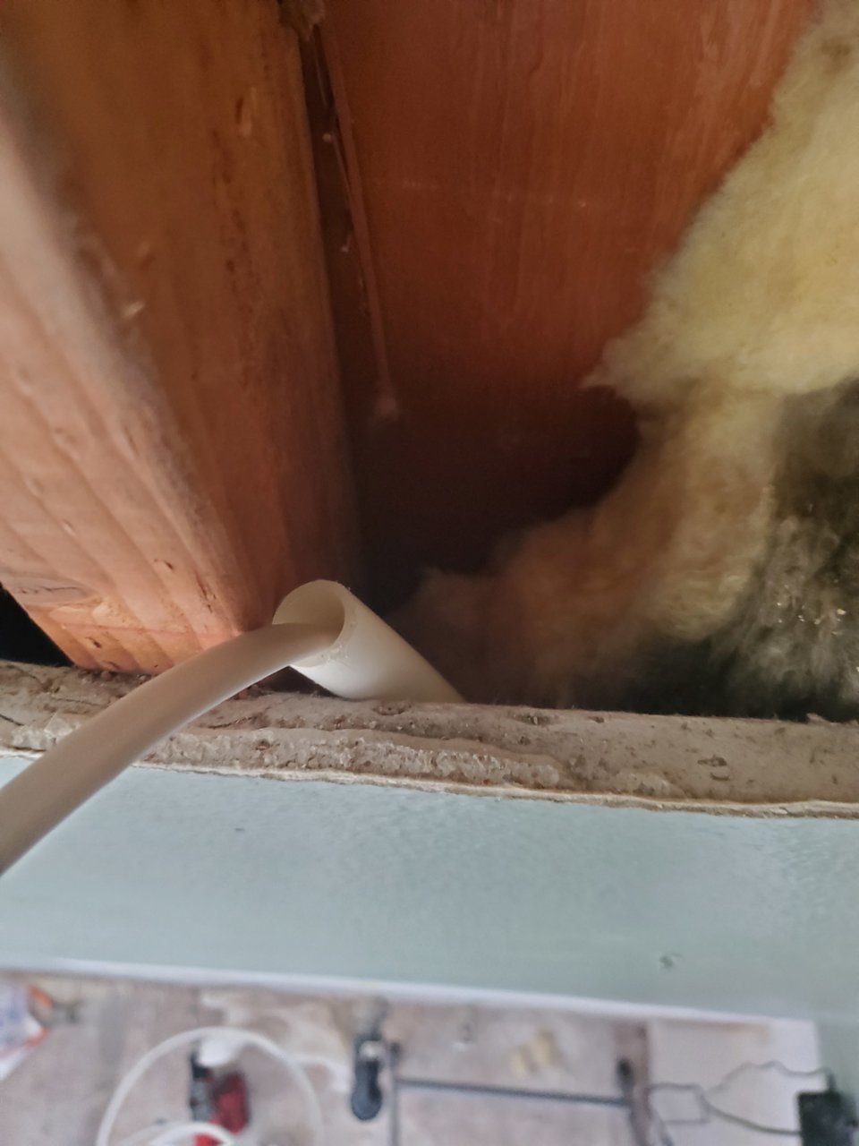

    Knocked out some more of the guest bath today. Couldn't find my fish & the Romex kept snagging the cotton candy. Turns out PEX is the absolute perfect conduit!

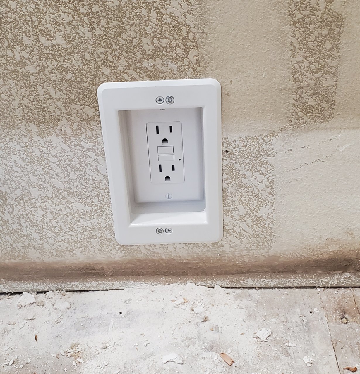

    Got the line dropped down, cut out & installed the new recessed plug for the vanity. Much quicker the 2nd time around since it's just a mirror image of the master bath. Haven't run the other end to the Jbox for power yet.

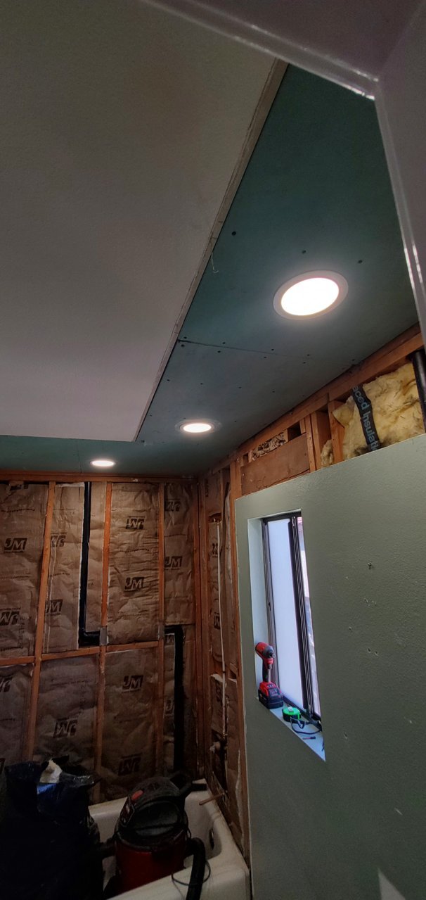

    Wired in the boxes for the recessed LEDs & then threw up some new greenboard where the soffit used to be. I hate hanging drywall & I think I suck at it...but that's what tape/mud is for. Lights work as expected, will install the Wemo smart dimmer after the tile guys get done making a mess.

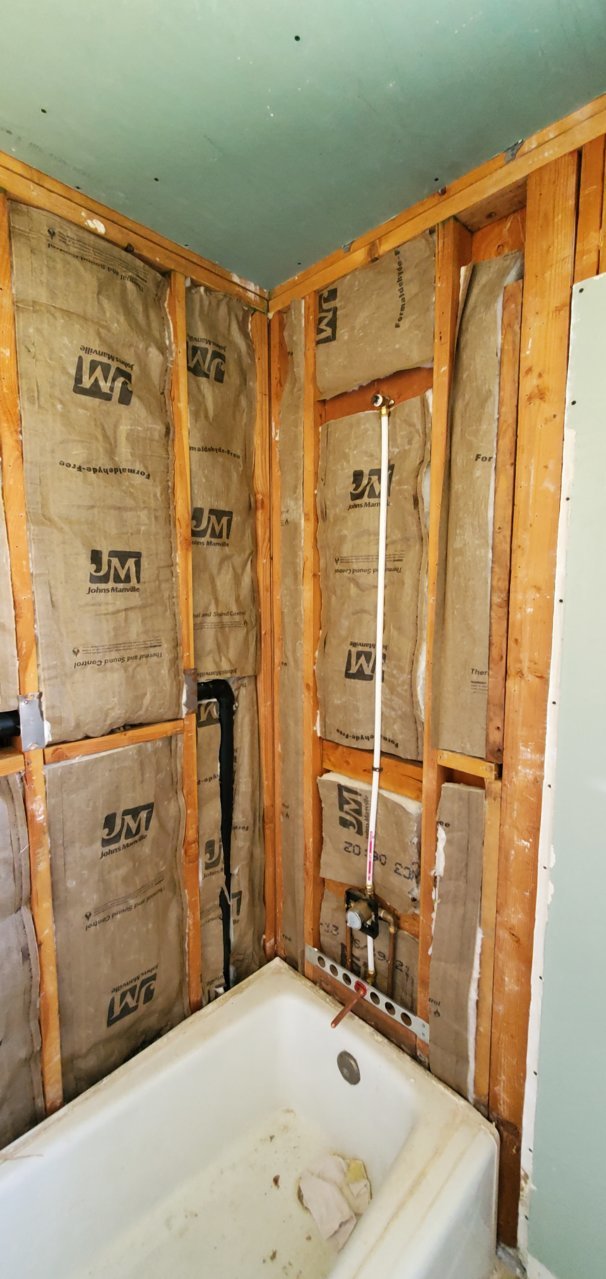

    Put up some new R13 "noise reducing" cotton candy around the tub (long wall shared with another condo, but no shared studs helps a lot). Also trimmed the drywall back to 2" from the tub per the tile guy's request. Got that line as clean as I could for the schluter trim.
