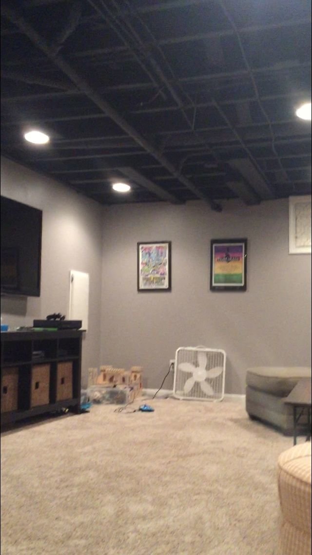

    In my opinion if this is not your kitchen, dining room you could take a perfect opportunity to rewire or clean up wiring with wire chases (or conduit). Next have the seams of the duct work sealed. Second to last fill all gaps with grout or spray foam. Lastly just paint it all flat black. No more fuss and when you need to work on something, it’s right there.
    Example: upload_2021-9-29_18-20-28.jpg

    Unfortunately it’s the vast majority of the downstairs. The living room and master bedroom were the only rooms without drop ceiling. They ran damn near everything through the drop ceiling too. Wifey says no to black paint so there’s that haha
