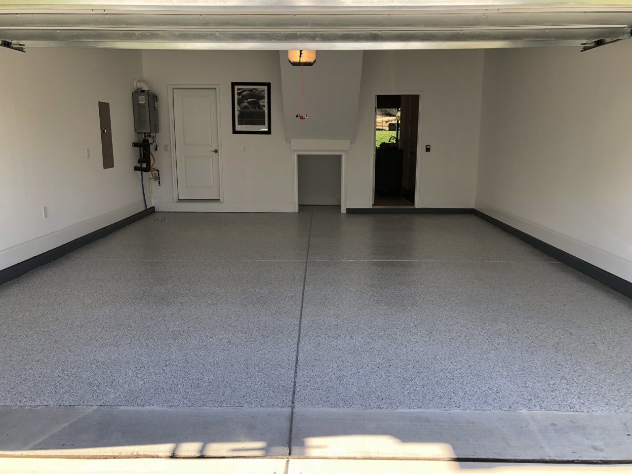

    final coat of sealer

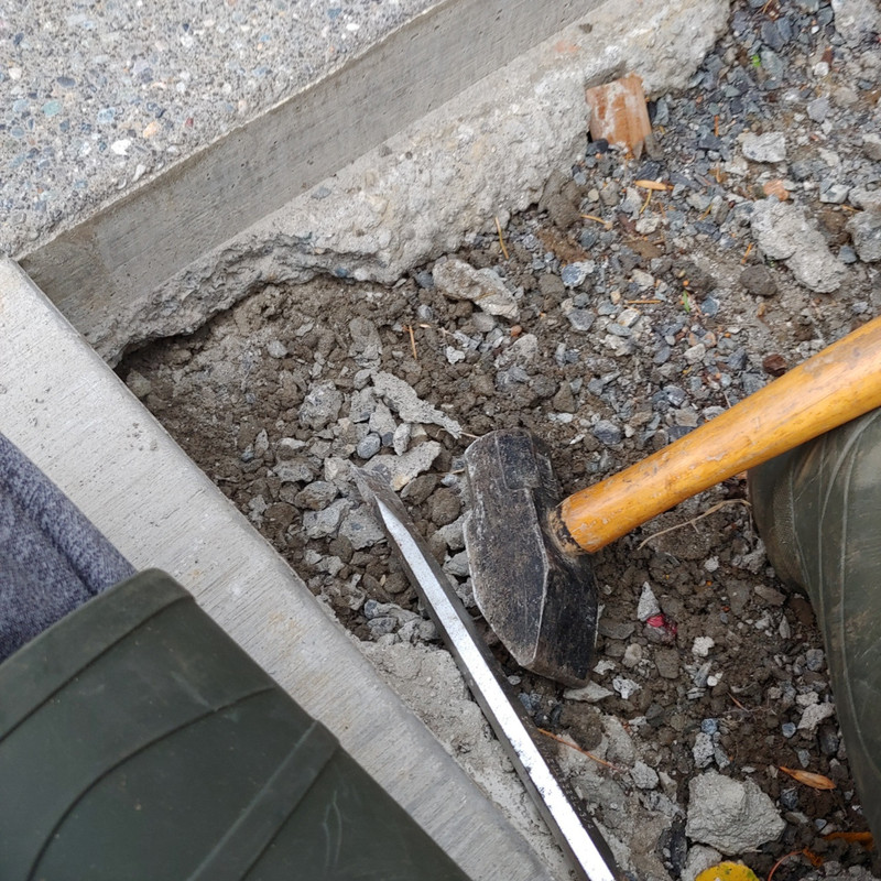

    Looks like you need a hammer drill with a chisel bit attachment! That makes quick work of it. I'd say you could borrow mine, but I'm on the other coast... :(

    I actually have a couple hammer drills but no chisel bits. Well no hammer drills that are hammer only! :D:eek::p

    Heh, I guess I should have specified the SDS variety :laugh:

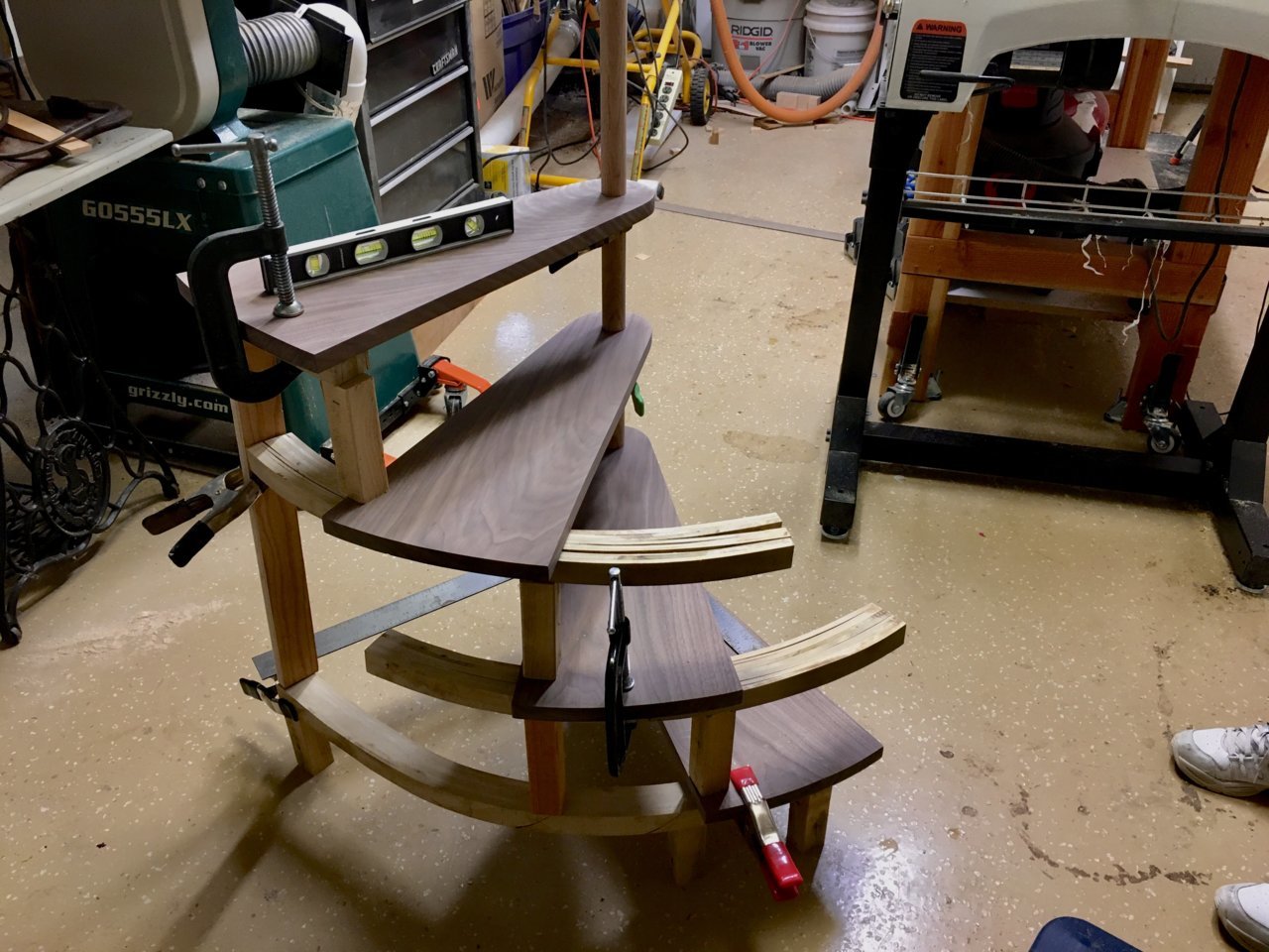

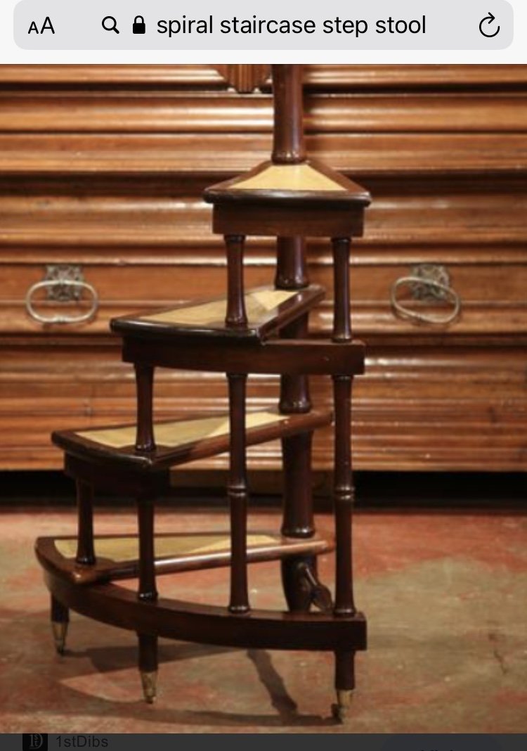

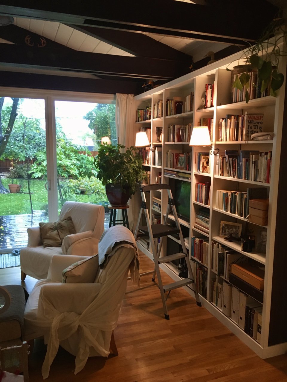

    We have full height bookcases and my fiancée, who is vertically challenged, uses a step stool to reach higher shelves. She saw a pic of a spiral staircase step stool and wanted one. They sell in the $3000 dollar range. o_O
    We have a retired friend with a nice shop setup in his garage who likes woodworking projects, so we approached him about building it ourselves. Some of the work I'm doing in our garage - I have various saws, sanders, drills etc, but he has the band saw, lathe and other really nice stuff. He was onboard and was excited to try something he's wanted to do for some time: bent wood without a steam box.
    So we went to a specialty wood store and bought some walnut (for the treads) and an oak pole for the vertical shaft. I cut the treads, first on a table saw, then the bandsaw to get the shape close, then clamped them together to drill the hole. After that I used a vertical oscillating belt sander to get the radius done. Then sanding with progressively finer grit. A lot of sanding...
    He has a large slab of poplar we decided would be the risers and tread supports. The original plan was to turn the risers on his lathe, and I had started practicing turning beads (not so easy), when the other half decided she wanted a more craftsman style. So round is out and square is in.
    For the horizontal, curved bands we cut thin strips off the slab. He soaked them in his pool :)eek::rofl:) then put them in a curved jig, glued them and clamped the hell out of it. Came out pretty good but a few pieces didn't stick.
    We got to a point where we wanted to mock it up and that's one of the pics below, using scrap wood as the supports. All in all, this is a really fun project and we're having a blast.

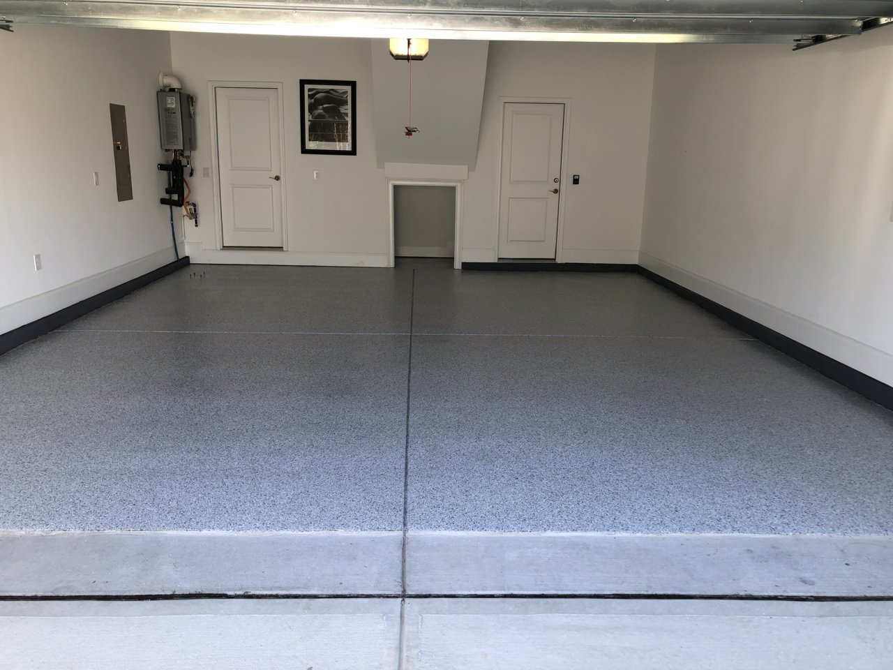

    Well after 3 days of cure time its time to park the cars....
