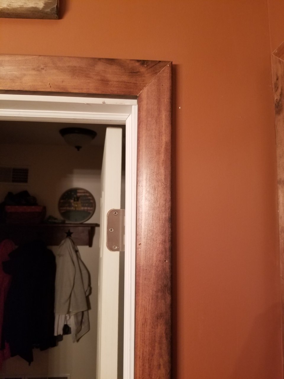

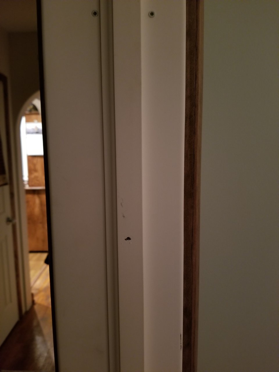

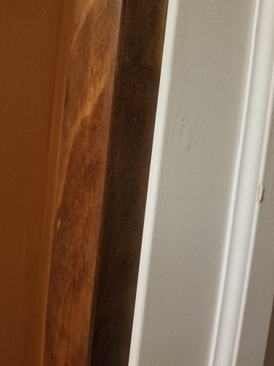

    All of the exterior of the doors in the hall are flush with the wall to the visual continuity. The interior side has the filler. I glued the filler to the trim so I could nail it in place as one.

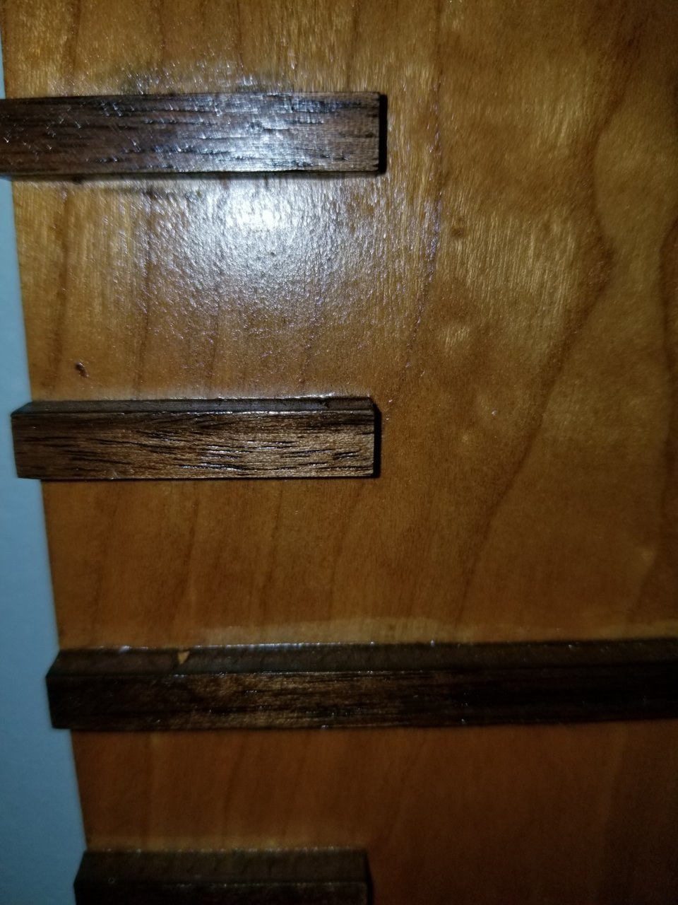

    So it's extremely hard to see if you can see it at all. But you can see where the glue was in the wood. It didn't show until I applied Arm-R-seal.

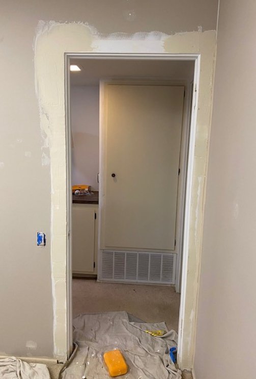

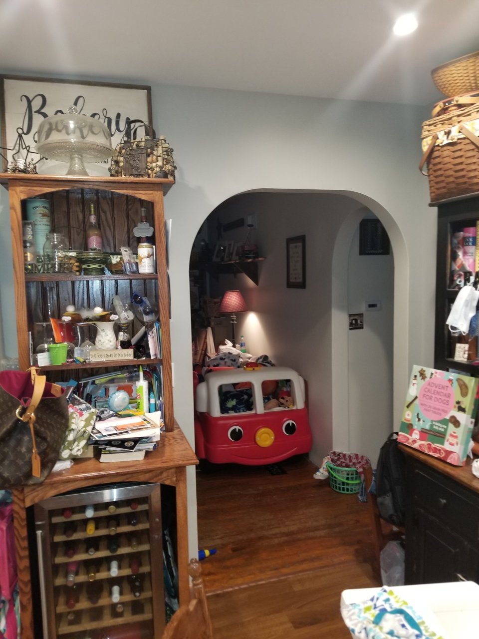

    When we redid the kitchen, we decided to leave the Arch in because if we took it out we would have had to redo the wall in the living room. There was about an inch difference between the two surfaces. So the wall behind the wine hutch is largely mud tapered back until you couldn't notice. My BIL is a genius with that stuff

    Can we talk about the fire truck bed?

    LOL. It replaced the racecar bed

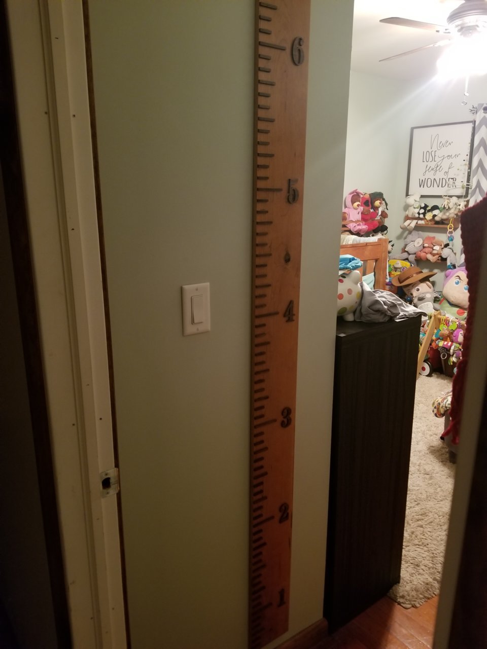

    That's actsully not the trim in that picture. Its a ruler I made.
    This is the trim.
    It's just the pine trim you get off the shelf.

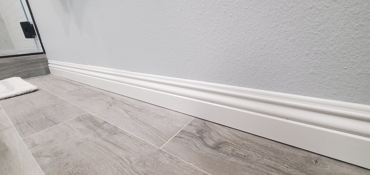

    Neighbor in my condo complex had stockpiled baseboards & gave me a couple sticks to finish my bathroom remodels. Just cheap MDF but I slapped new high gloss paint on them & did my best to hide the nails where you can't see them from above. Don't think I'll worry about filling the holes.
