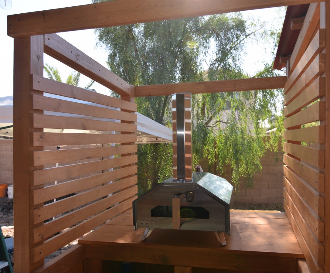

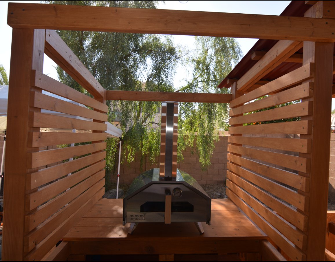

    Finishing up my Wood Fired Pizza Oven 'hut'

    Thanks - it's the wife's work, I just hold the pieces up for her per her design and wishes.
    Going to finish up some doors on the bottom to hold 'stuff'... there is a second-half of this
    project ( not shown ) to the right, where we'll have a sink and 3-burner gas-thing... and
    drawers and doors etc...
    Outdoor living... say YES to the outdoors 'eh ...

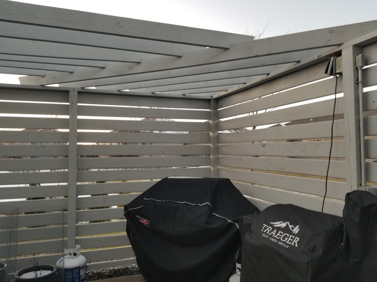

    My patio is incredibly simple - just 4x4s, 5/4 deck boards and 2x6s but it made the patio 15 degrees cooler because there was no shade.

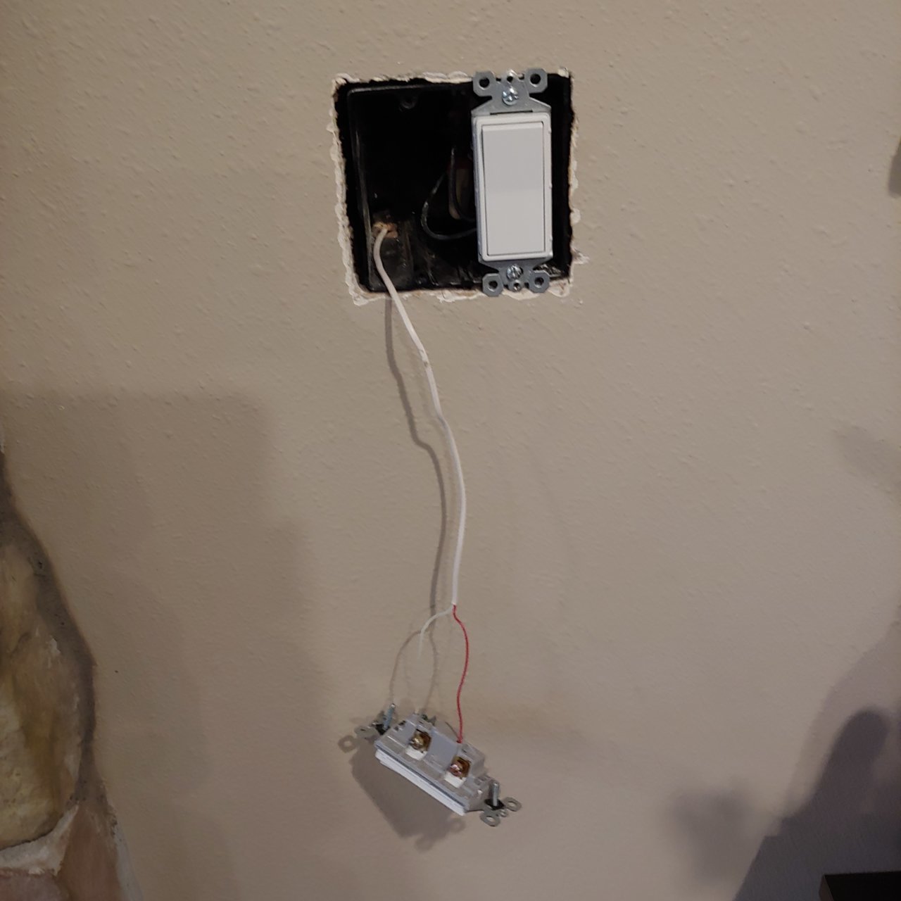

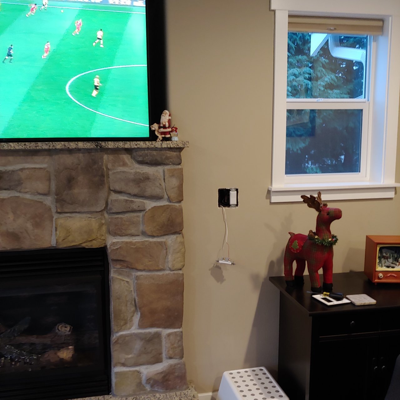

    20211204_084317.jpg 20211204_084237.jpg Propane fireplace. Actually by some miracle, it works and looks pretty good. Does not consume copious quantities but we have a nice NEW full house HVAC, so only use it for special occasions.
    Here are my question details: Externally only a simple switch (generic light switch in a double gang box) - for ON/OFF via millivolt copper wire. I wish to add a millivolt T-stat. Done this before at two other houses (NG) - easy. But here is the hassle. The double box. Next to the ON/OFF switch is the switch for lighting over the fireplace.
    Q: How to put a low cost millivolt T-stat in one half of a double box?

    either a 3 gang box or add an addl single gang box

    Probably my question wasn't clear. Not sure why I would add another box.
    The t-stats are usually surface mount with just a hole in the drywall for the low voltage wire.
    Now I could - and maybe will - keep the "manual" switch and just mount the T stat above the switch plate and run the wire up there and back. That would give us a hard positive OFF.
    I was mainly asking if I could mount the T-stat NEXT to the existing light switch - not sure I have seen such a thing. (???)
