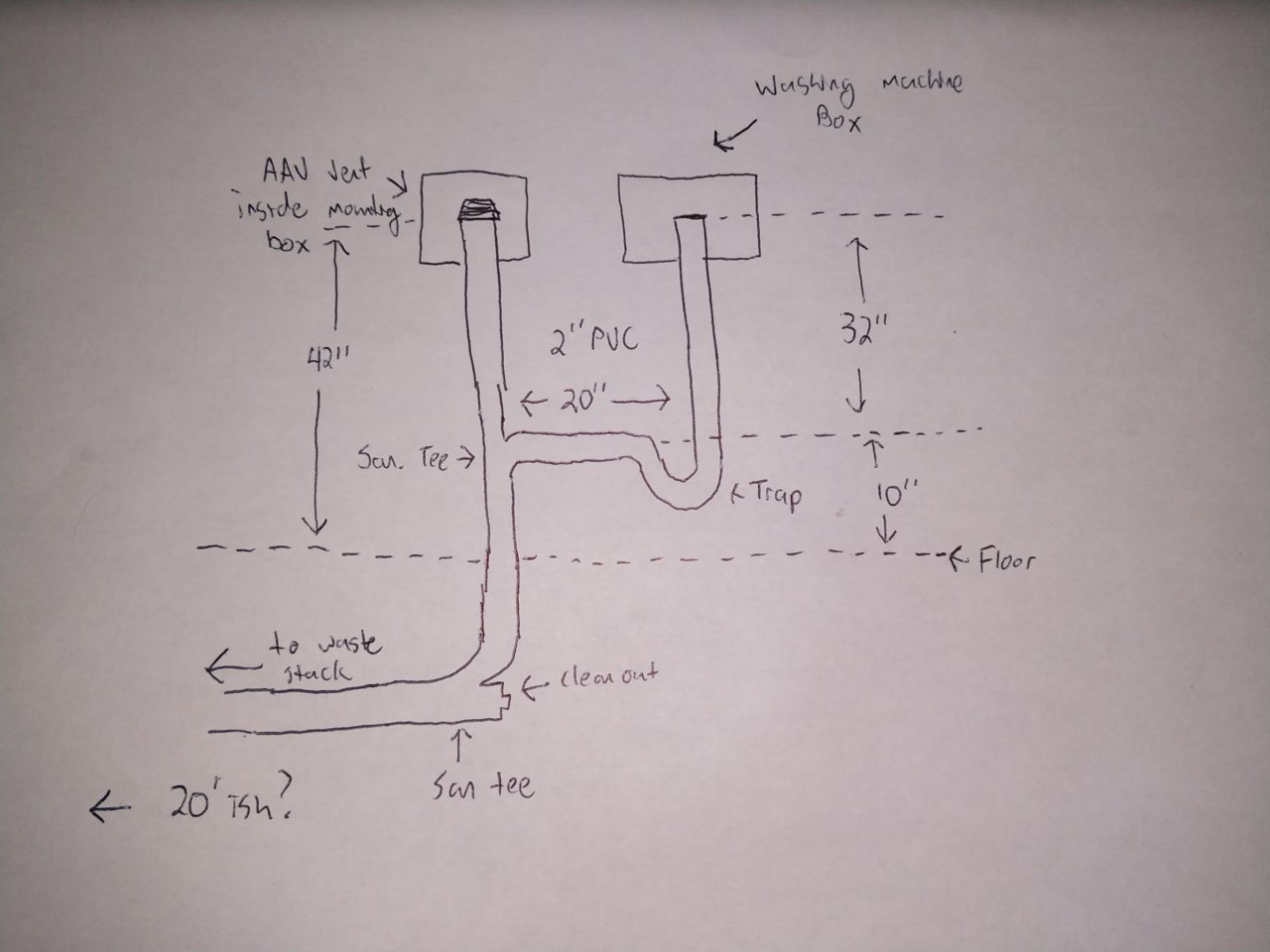

    Aight TW plumbers, Ive got a question for you. Im planning on moving the washer/dryer hookups out of my kitchen and building a closet for them in the back of the house. I've got a plan as far as framing and electrical, but I need reassurance for my plumbing plan.
    Heres what Ive come up with.
    Does that look ok? I don't really have the option to tie into another vent or install a roof vent so Im gonna go with an AAV vent that I'll mount in one of those screened boxes so that its accessible. Does the height of the vent matter in relation to the washing machine standpipe? The drawing is a rough guess, I'll either put the AAV mounting box level with the washer box or up by the ceiling for looks.
    Next question, after the waste water goes below the floor, does it matter how far it has to travel before I can tie it in to my waste pipe? Im pretty sure that as long as it has sufficient downhill slope it doesn't matter, but I want to make sure as it will probably end up being a good 15-20 feet or so.
    Thanks

    It looks like an AAV only needs to be 6" above your horizontal 20" long pipe so you're plenty good there. Going any higher would be purely for aesthetics.
    As for the distance, I've never heard that it matters as long as you're running a downhill slope of about 1/4" per foot.

    I dunno about new installstallation but that looks good. Just make sure the angle is good for drain. I dont think height vent matters too much. Found this...for vent
    https://garynsmith.net/venting-101-air-admittance-valve-pros-cons/

    When the flow goes from vertical to horizontal you need to use a wye.

    :thumbsup: Will make a note of that.

    Another thing to consider is if the 20' lateral run is above a finished space. The wye is going to bring around 6.5" to the party plus the 5" of required slope is 11.5". That's a problem for 10" joists, tight for 12", and easy as pie for 14" or more.

    Crawlspace so were good there
