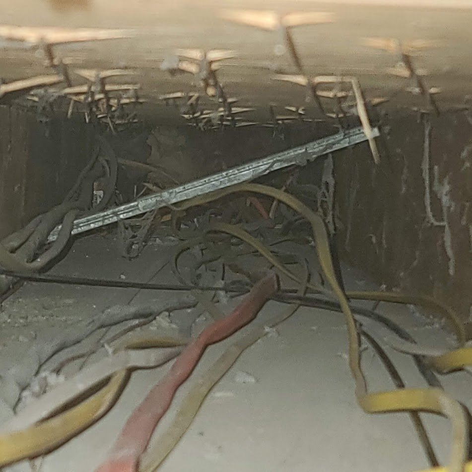

    Anyone have some advice on running some Romex through this mess? I've tried getting a fishing wire but that gets stuck too. I only have about 15 feet but it gets stuck every time. It's not blocked, there is just too much crap in there.

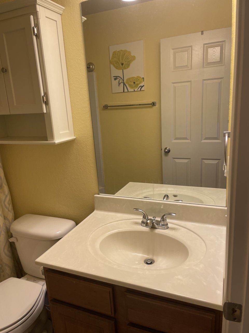

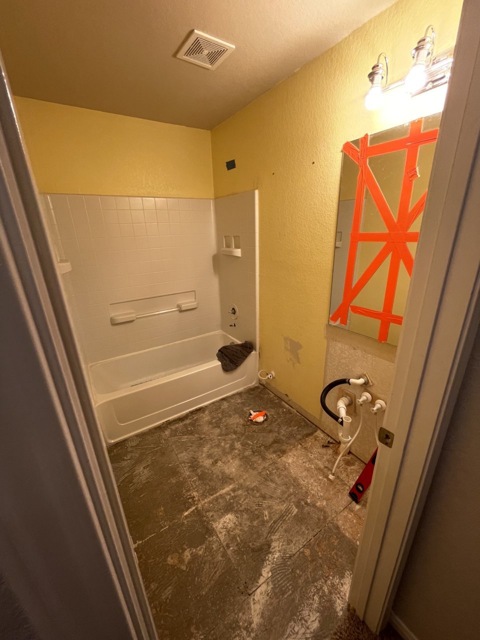

    Started the guest bathroom remodel last night after supper. Plan for today is to get the shower surround out and level the subfloor. About 3/8” low near the toilet.

    beefierfishing wire?

    BX cable is some old stuff.
    Get a thicker fiberglass fish rod and coat the end in wire pulling lube. It should find a path pretty easily.

    Never used that before but that looks like it would work perfectly here. Thanks.

    Candle wax also works if you dont want to pay for a bottle of lube that you'll only use once.

    Dang that layout is like verbatim my guest bathroom, which also needs to get redone soon

    Fiberglass fish tape has a lot more flex. Not sure that will help you much. Just gonna have to have some patience and keep trying.

    Bulk builder special. Gonna leave the tub, but tile with 12x24 up to the ceiling and add a niche on the back wall, hex floor tile, new vanity mirror and light fixture.
