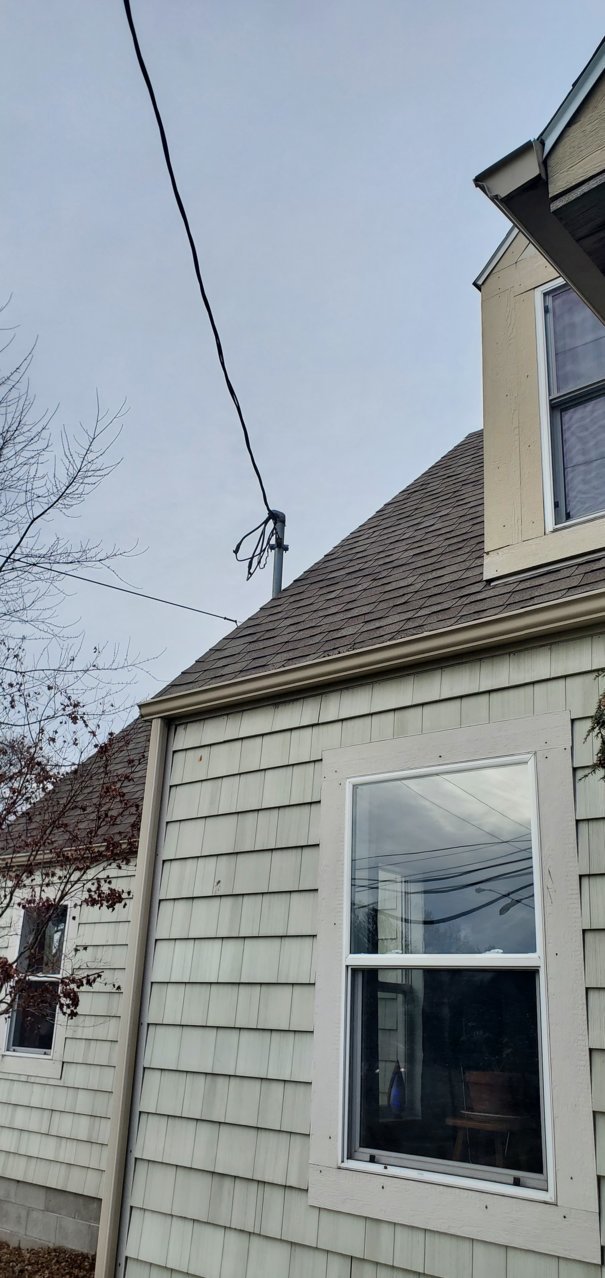

    I need roof help. I have no eaves on my house for vented soffit. Also, when they resided the house in '15, they boarded up the gable vents. Can I put vents in the fascia behind the gutter?
    There is a ridge vent, and I plan on either putting the gable vents back in or putting roof vents just below the ridge.
    Picture for reference.

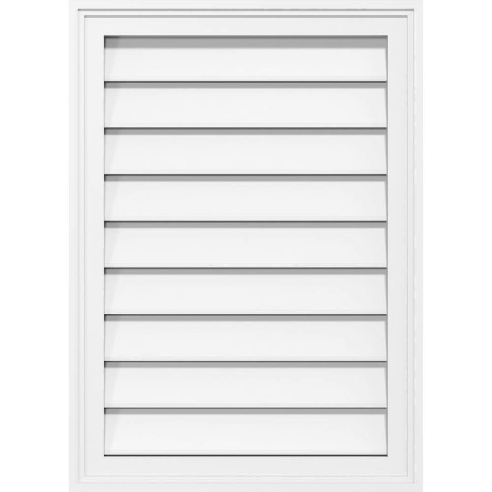

    I would not put holes in your fascia lol water will run right in
    Just make sure your gable vents are big enough (there’s a formula that uses the volume of your attic to determine vent sizing)
    try to find some that look like they would direct water away from the attic. They will work with your ridge vent to do a convection path. Adding roof vents will not do much better f there is already ridge venting.
    Why doesn’t your house have eaves lol

    I'm not sure I understand the bolded part.
    Also, I don't know why there are no eaves. It's a bungalow built in 1936. Maybe that has something to do with it? :notsure:

    Most gable vents will resemble shutters (but with screen on the back to keep out critters) to keep rain out of the attic space.

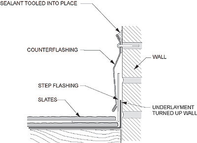

    This ^
    Seal it up with some good silicone and maybe a counter flashing strip above
