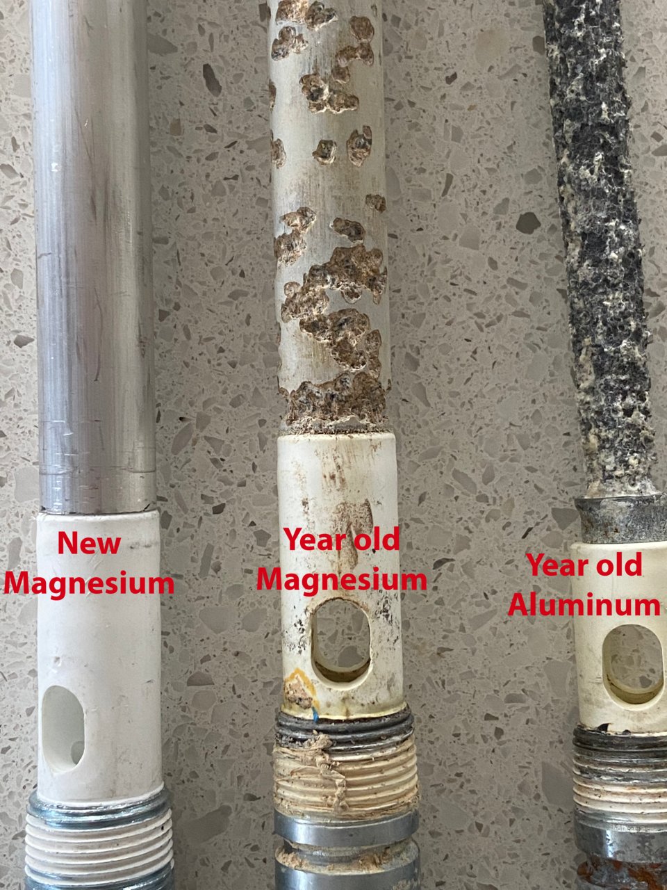

    Here's another thing to check yearly that nobody does, anode rods. If they ever get used up the interior of the water heater will be toast in no time at all. The only reason I do mine yearly is because my new house has a high efficiency water heater that will be stupid expensive to replace. Oh and aluminum anode rods suck. They leave a gummy film in the tank and they don't last. Hmm wonder why the rod that came with the stupid expensive high efficacy water heater was aluminum? Planned obsolesces maybe?

    Water softeners are especially hard on anode rods. That's why I have a tankless hot water heater (no anode rod).

    I do have a water softener. The softener was installed about a month after I moved in so the aluminum spent 11ish months in softened water. The magnesium spent 12 months in soft water. I put it back in after inspecting it. Come July I'll pull it again to see how it does. There is no way the aluminum rod would have lasted 2 years. And with the aluminum rod there was a BUNCH of crap that came out with the flush.

    Different types of anode rods are available depending on the water quality.
    https://www.nebraskyplumbing.com/everything-you-need-to-know-about-a-water-heater-anode-rod/
    • Anode rods are generally created from metals including magnesium, aluminum or zinc.
    • Magnesium anode rods are expected to work better in a home with soft water.
    • Aluminum anodes are appropriate for homes with hard water and a high PH.
    • Zinc anodes work best if a home is starting to smell like rotten eggs and is best for replacing water heaters that already dissolved.
