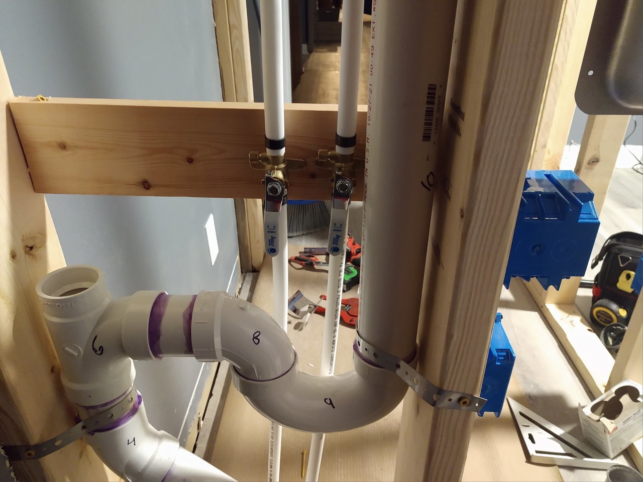

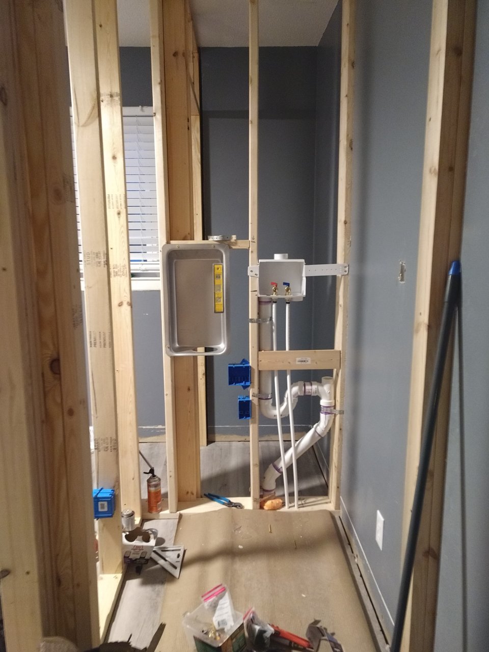

    Put my plumber hat on this weekend. Got the Hot/cold supply lines plumbed in and working. I put additional cut off valves in that will be accessible through the closet so that I dont need to move the machine to stop a flood.

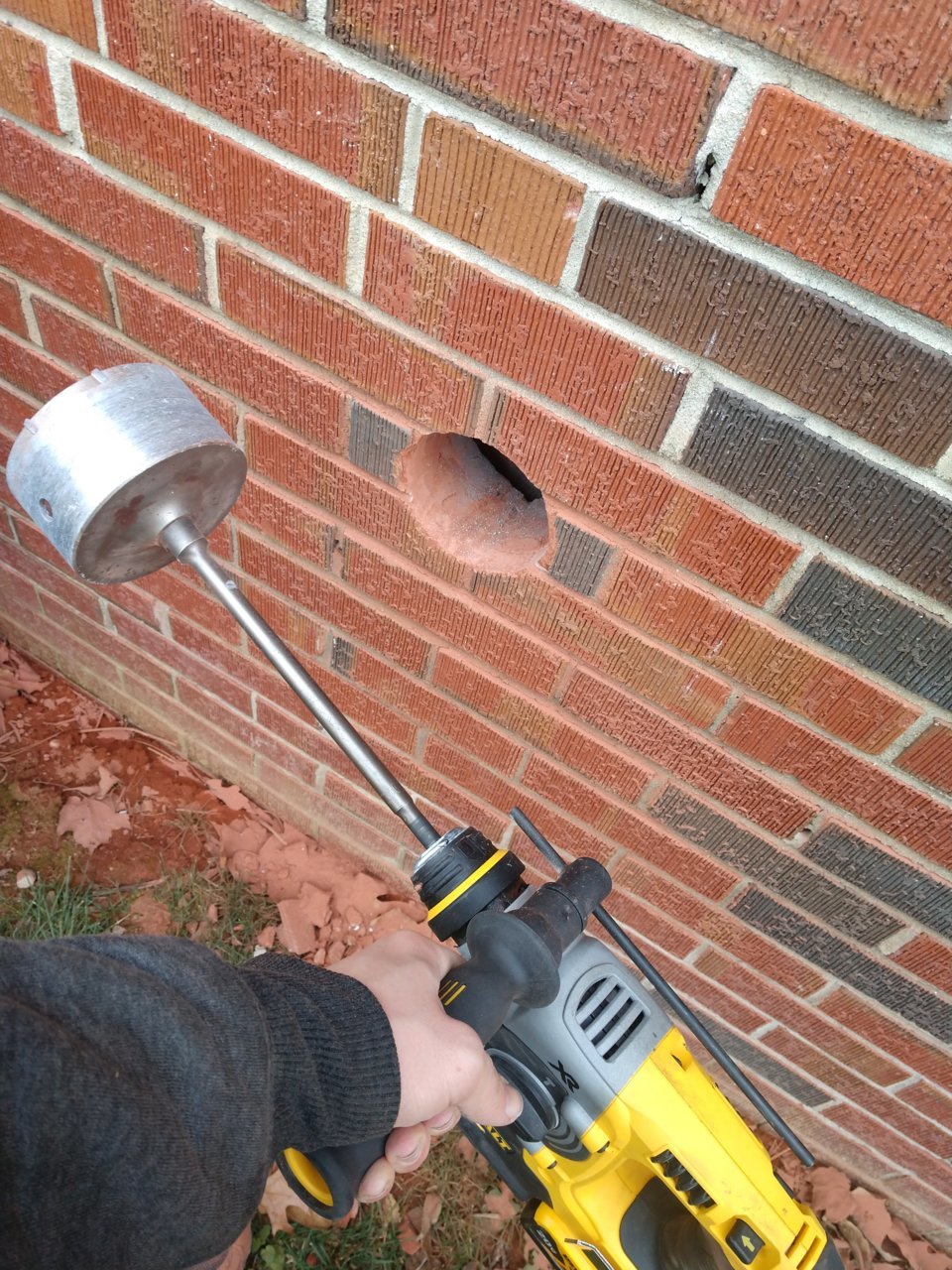

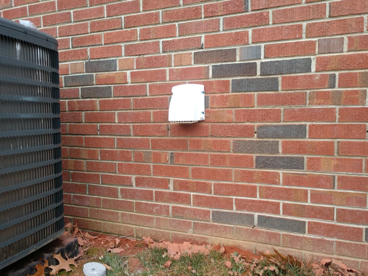

    Also bored the hole out for the dryer vent. The XR hammer drill I borrowed from work made quick work of it.
    This weeks after work activities consist of running the 2" drain line under the house and tying in to the main stack. There's 5" of snow/ice on the ground but it needs to get done.
    I really need to let my wallet cool off some before I do much anything else, got a house payment due at the end of the month. Gonna be hard to be patient for a couple weekends.

    Can you provide info on the cutter that you used

    I think its a Bosch 4.5" SDS+ masonry hole saw. Not cheap, hence why I borrowed it from work.

    That coreing looks great. I rented one to core my block wall for Radon venting (with fan). It took longer to sign the tool out at the rentall than it did to cut through the wall...let alone driving there and back for it.
    Nicer than a bunch of little holes and a chisel. Gotta be careful though, guy said the bit was over $500. And they gots your credit card number.
    Blue92 likes this.
