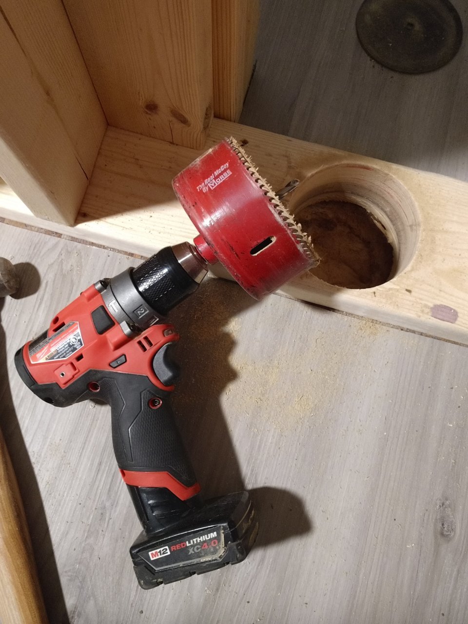

    So an M12 fuel drill will handle a 4.5" hole saw through 3" of wood on one 4ah battery.

    The DOC on that hole saw doesn't appear to be enough to go all the way through in one pass. Did you have to come up through the floor first?

    How many times did the drill stall out on overheating? I think the M12 Fuel Hammer Drill is only rated to 1.75" hole saw IIRC.

    I cut it in layers. 2x6 board on top of 3/4 hardwood, on top of 3/4 subfloor.
    A lot haha. Just went slow with light pressure and let the tool do the work. Its the only drill Ive got so I had to make it work.

    I have a corded Ridged for that purpose, the cordless for everything else!
