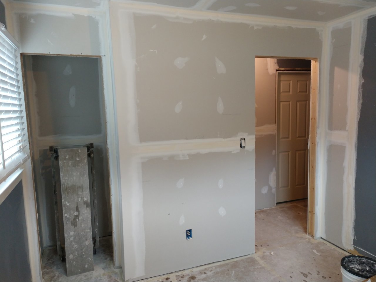

    What's that big gap against the wall (3rd Pic) on the left? Bad scribe?

    Maybe just rough cut, cover with trim. Cut for base board.
    Just a guess.

    that was wwwwwaaaaaayyyyyyy out on that side and its getting replaced tomorrow.....They had to grind it down to get the side board in so they could set the outer frame of the unit.

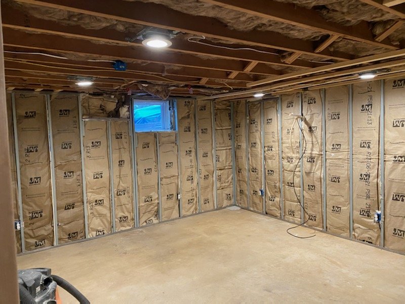

    Basement is making good progress. Structural and electrical inspections passed with flying colors and insulation inspection is today. Should be finished in the next week or two.

    What ceiling material is that?

    It's an R-15 insulation, that's really all I know. We added it to dampen the noise between levels a bit. I'm overseas right now and my wife is dealing with the contractor, who has been fantastic to this point.

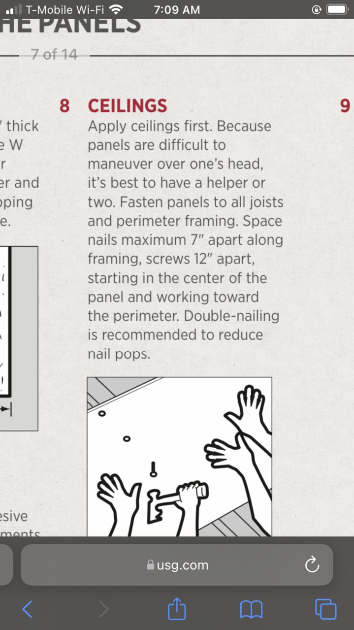

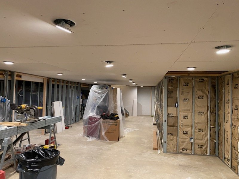

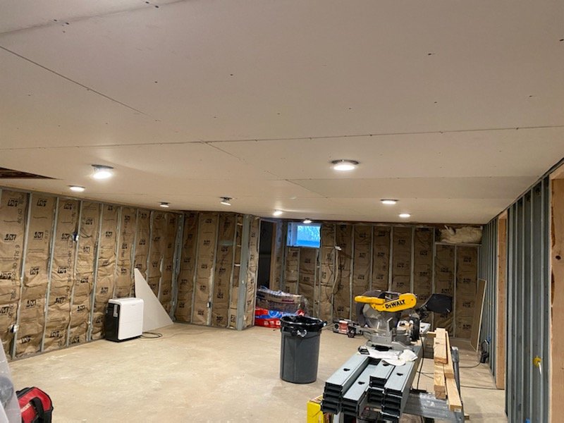

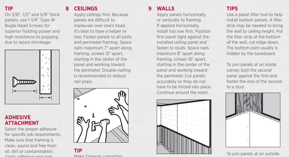

    It looks like drywall or gypsum board but the screw spacing does not look right. That is why I ask. I guess I am used to 6” screw spacing on drywall edges, but this manufacturer snip says 12” minimum. So I will carry on. :pout:

    Sorry, yep that portion of the ceiling is drywall. Thanks for pointing out the screw spacing, I'll ask him about that today...most of those are definitely greater than 12".

    Honestly, I would ask them what the MFG recommendation for ceiling fastener spacing is. Most drywall folks are very aware of the instructions, its when you get a handy man in who does drywall once a year that you have to be concerned IMHO. This is what I am referencing https://www.usg.com/content/dam/USG...-gypsum-panels-installation-guide-en-J371.pdf :notsure::notsure: My intent is not for you to get in a fight with your contractor. :oops:
    Take this installation for example, looks like the centers are the same spacing as yours @4x4Taco2012 but ceilings require more fasteners...

    Thanks, I appreciate the info! I wasn't planning to come at him with a questioning attitude, he's a great contractor (and guy!) that has educated us along the way. He's been building and renovating homes in our immediate area for over 30 years so I'm confident in him and his crew, but I'll ask about the MFG's recommendation. Thanks for looking out.

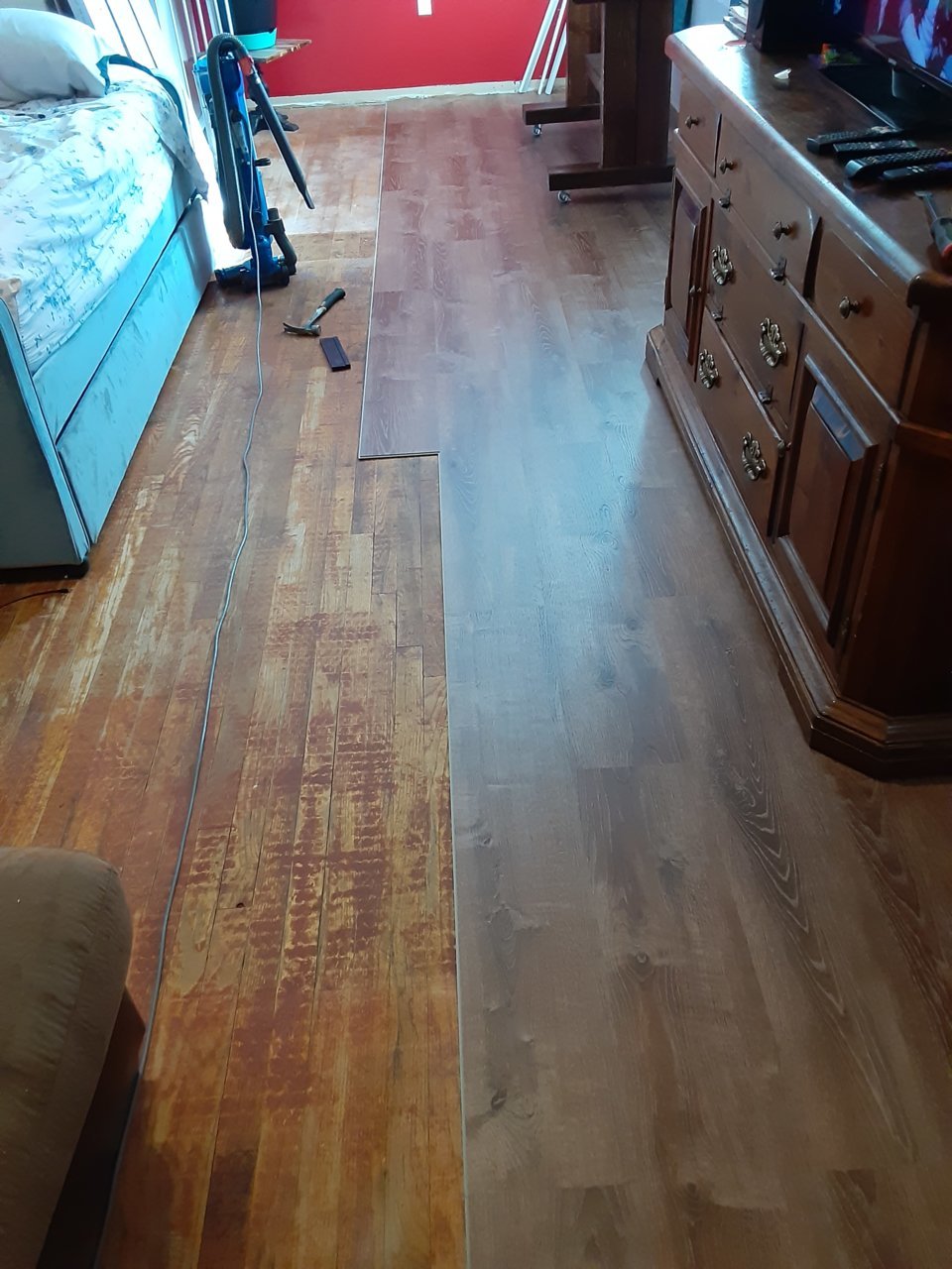

    There was actually 3 areas that were out by 11/16 of inch and one by a 1 inch
