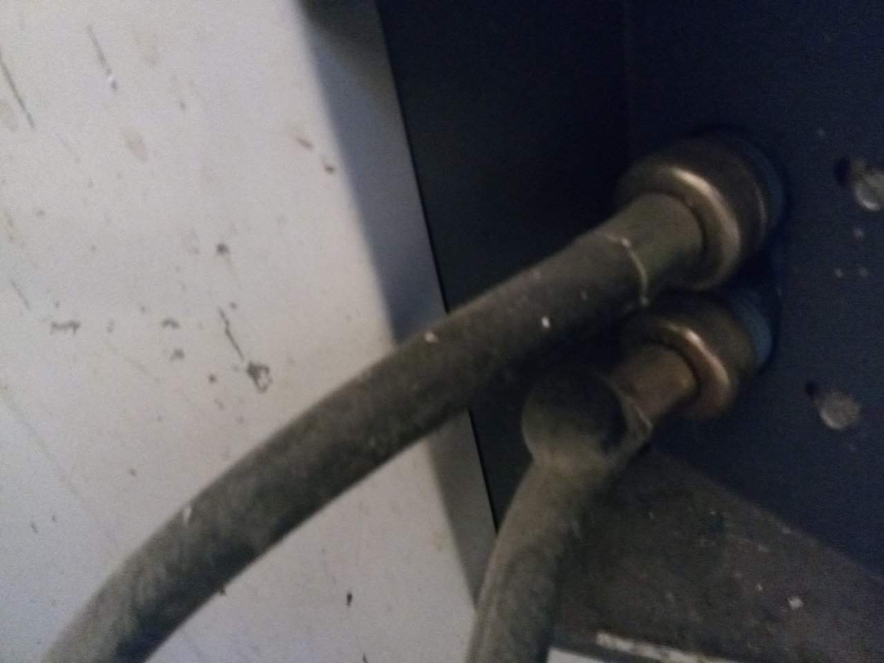

    Having water leak alarms goes a long way too. I got my dad a set for his new place and they caught a rupture in a new washer a week after install.
    Super cheap on Amazon.

    Waiting to close on my new house. It has first floor laundry. I think I’m gonna buy new braided hoses after seeing this just as a precaution now. Current hoses are about 11 years old but look good. Don’t want or need any accidents in my new house, especially with the laundry being upstairs.

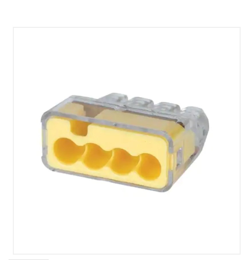

    What is the general consensus on these type of push in connectors? I hate back stab switches, so why would I want to use these in a jbox?
    For context, I need to bring 5 romex (1 supply, 4 load for outdoor lights) into a box and splice together.

    Matter of preference, an electrical contractor can save like 5-15 minutes a j-box using these that money adds up when billing out work.
    I prefer wago personally but I mostly use them in industrial applications…

    Rated for full amperage for the listed wire… need not worry

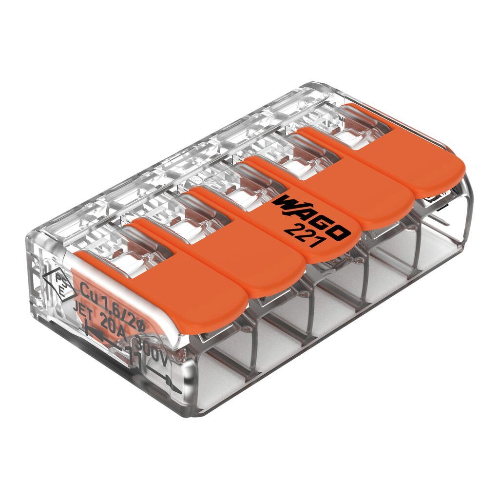

    If you’re not gonna use wire nuts. Wago 221 connectors are probably the best option. And with the 221 lever nut style you can use solid or stranded wires. We use them in our plant. Not always the best application for everything but they are nice when you need them in the right application.

    I too like the Wago connectors Tokyo Joe showed with the levers for disconnecting. They grip tightly and have enough spring action that as the wires get moved around during install that they will maintain a tight connection.

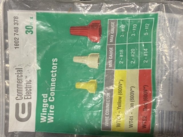

    Also, the standard Commercial Electric winged wire nuts in red from Home Depot are rated for five 12 gauge wires.

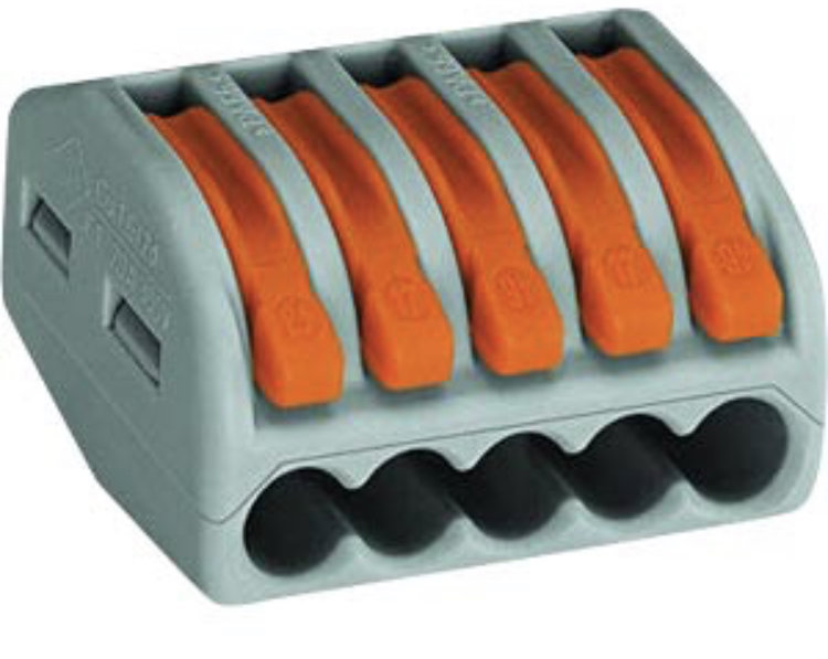

    Ended up ordering some of these. I like the levers, but will still wrap with electrical tape to make sure they stay down.
