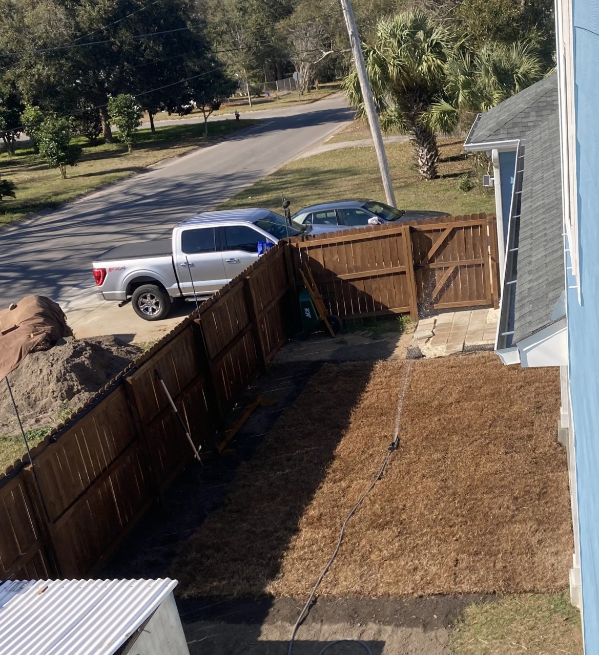

    Installed 1 pallet of sod today, started feeling itchy. Took a shower now I am covered in hives. :annoyed::bananadead:
    Yard is looking better and it’s even mostly level! Only 8 yards of top soil later the yard now has a 1:30 pitch away from the slab. Crazy

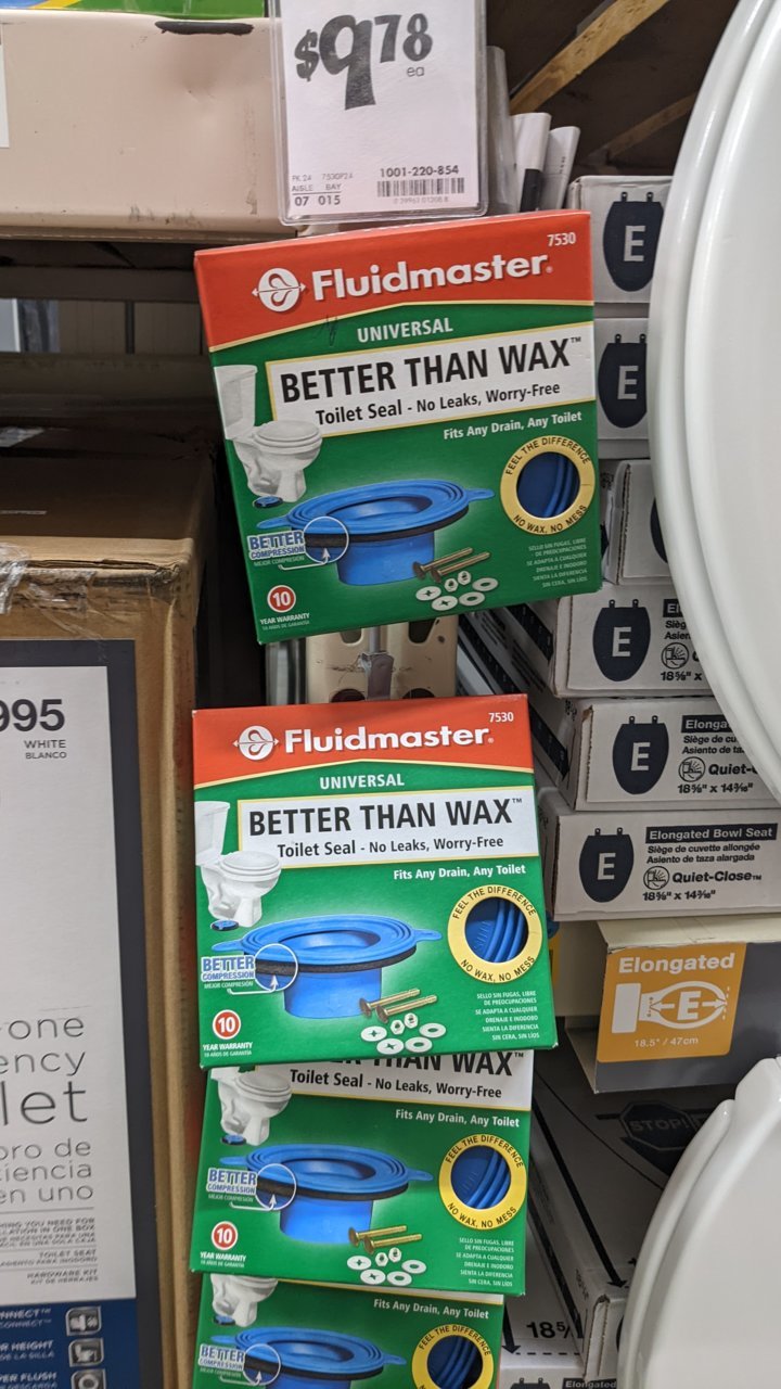

    I need to replace the wax rings on my two toilets, would you guys bother with this or just get a traditional wax ring?

    Traditional wax ring, no flange (horn). Just plain ol' wax.

    It Depends.
    Generally agree with D09
    Butt, is your fecal floor ring recessed or level/above the final floor surface?
    I have had assinine applications with the flange, like 3/4-1" below the floor. Pisses me off as eventually piss leak with just a single 1.99 wax ass ring.

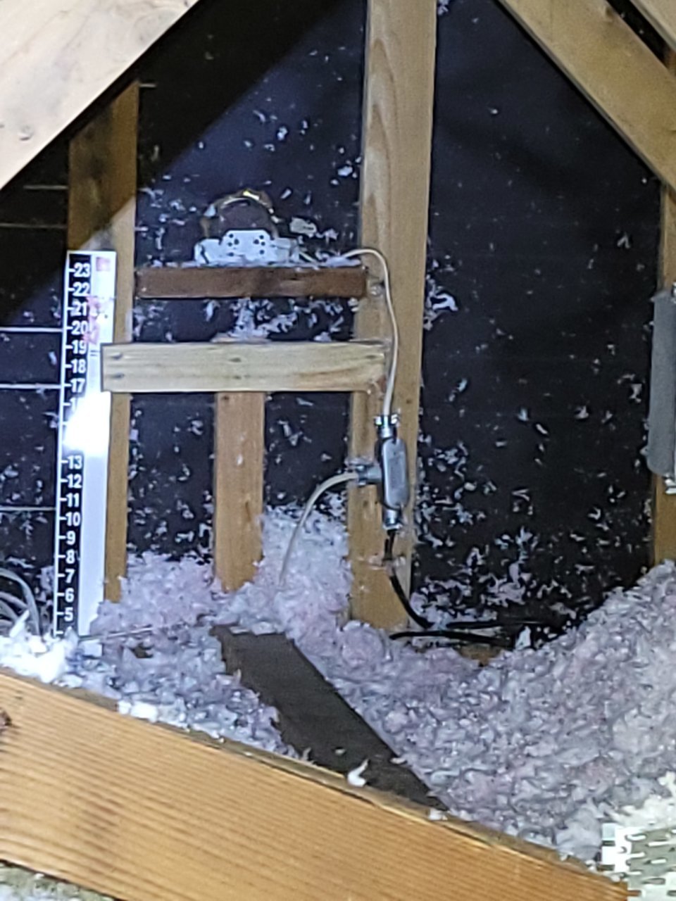

    Need to replace this conduit body with a 4S box to accommodate two more wires. The stud is laying flat against the sheathing. How would you mount the new box? I was thinking just screw a 2x4 to the face and mount the box like normal.

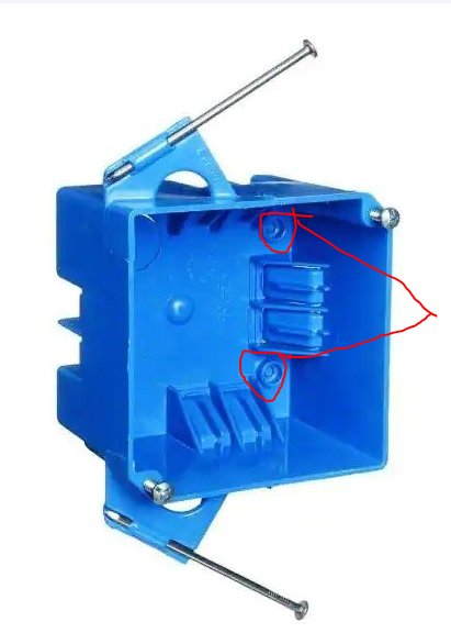

    These are through back mounting holes, just use 3/4" screws and go right into that 1"x#" board.

    Why not use a deep octagon/square/whatever junction box and screw it to 2x4 that is there already?

    :facepalm:Can't believe I missed that. Thanks for the sanity check fellas.

    Metal boxes also work... 4square etc.

    Use a metal box with a metal cover.
