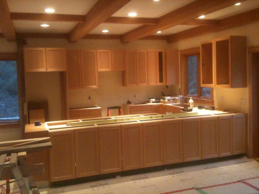

    Finished this kitchen cabinet install today

    Very nice looking kitchen.
