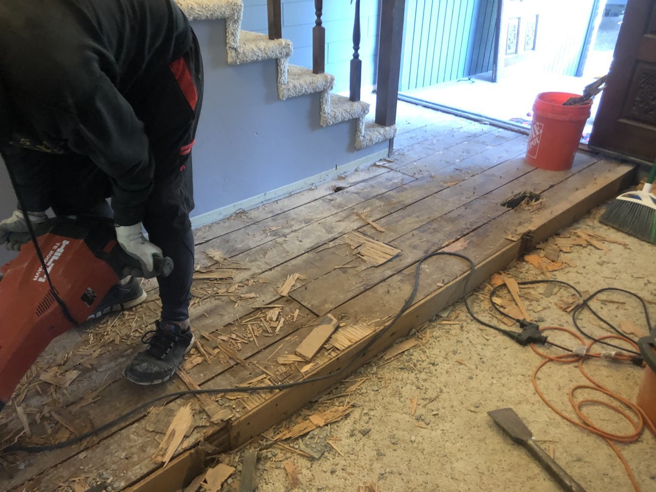

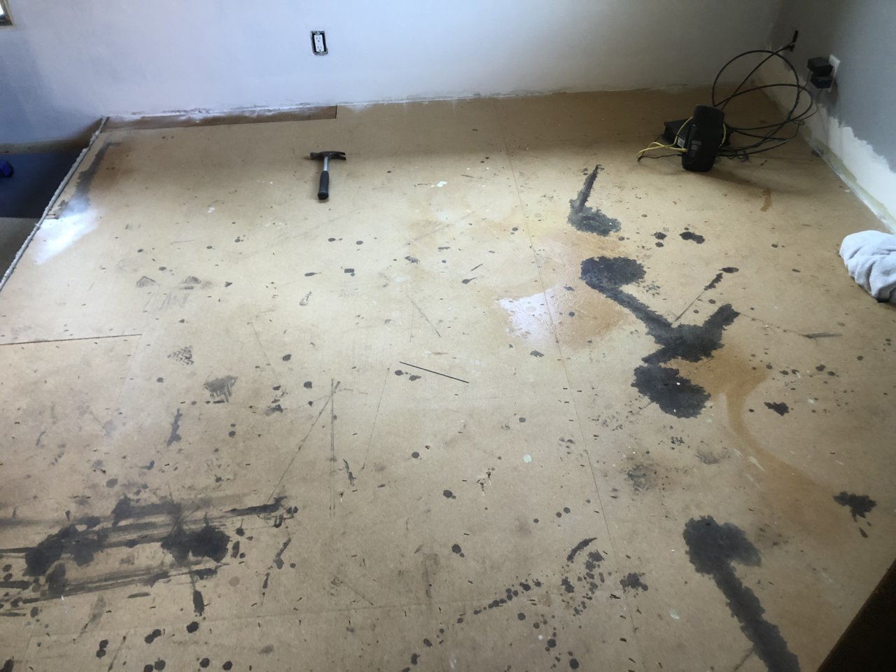

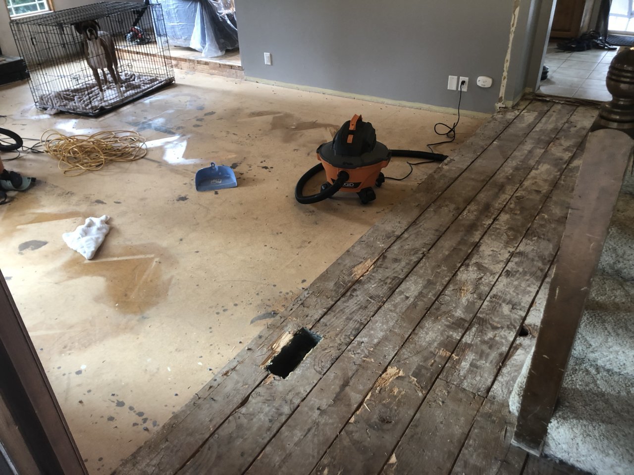

    Prepping to install the solid hickory floor next weekend. I had to rip out carpet, cheap snap together flooring, and some tile that was practically welded to the subfloor. The concrete backer was so adhered to the plywood we just had to scrape the plywood off in sections and now I have to go replace it lol. I’ll do OSB because the rest of my floor uses it. I want to punch the guy that put it together. Luckily it’s just the walkway, but still took a few hours and the number of fasteners I need to yeet before cutting new boards is going to be extremely tedious.
    It looks like I have a deck for a floor now
    The carpet and cheap click floor took probably 20 minutes to get out.
    Anyway, long ways to go before next Saturday. I have to rebuild that subfloor, pull fasteners, patch a bunch of drywall, prime, and paint walls. Changing all of the trim so no undercutting to do other than the fireplace.

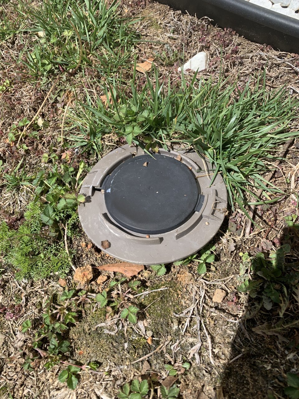

    Hi guys, visiting my sister in law in Raleigh, NC and noticed these plastic covers that are in the ground about 3 feet from her foundation. Ive not seen these before. Are these familiar to anyone? Look like clean outs, but she has 3 along the foundation in the back yard. Thanks!IMG_1850.jpg

    Those are either ant or termite wells full of Poison

    Ok, do you know, are these usually precautionary or after noticing an infestation? She just bought the house.
    And call a pest guy for service?
    She wanted to put in a patio and we don't know how far into the ground the pipes might go and can they be moved?

    Prob the area you are in, usually orko or some monthly service company the previous owner had. The company comes out once a month as needed to fill them and or replace the "bait". id just pull them and move to different side of house. Just watch out for liquids inside.
