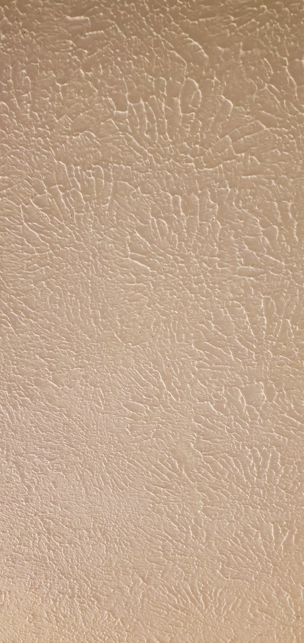

    With all this talk about popcorn ceilings, could someone tell me what type I have?

    We’ve always called it textured. I don’t know if that’s the official term.

    That’s called rosebud texture. It is a slap brush method where you draw/dab a brush in a circular motion while the mud is still wet.

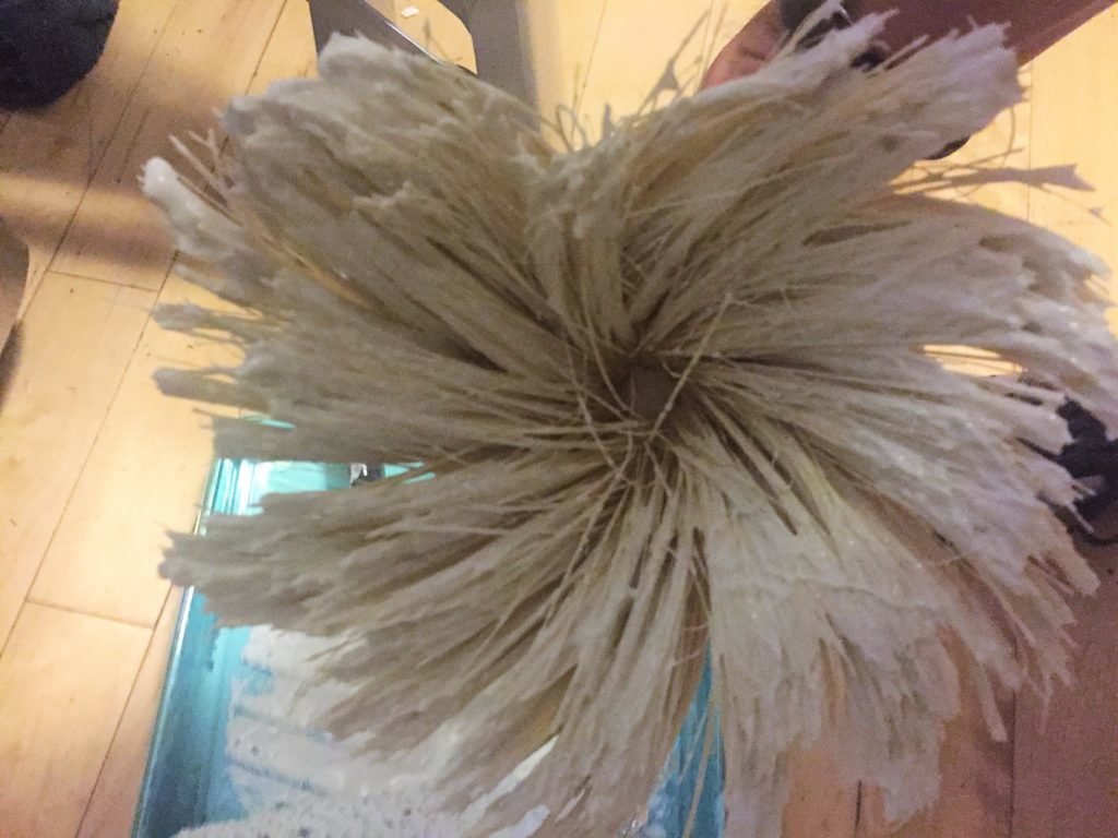

    Btw…if you ever have to repair that ceiling texture this is what the brush will look like.

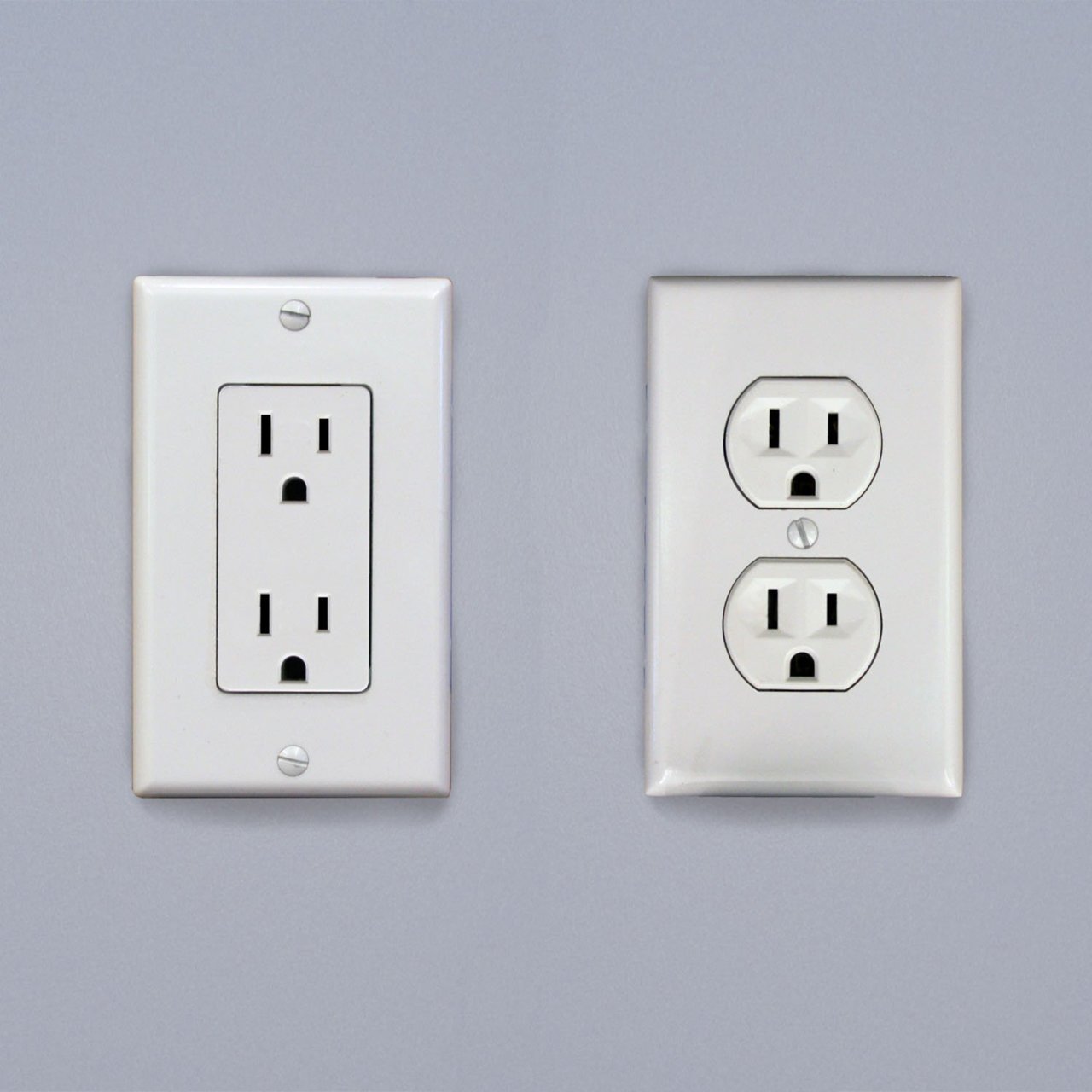

    Looks good! How are decora recepticals different?

    Little more clean looking. Also uses paddle style light switches instead of the standard toggle switch.

    Oh. I'm on the fence about the Decora ones. About half my house has those and the other half is normal.
    Get dust in the slots that way. I've been switching most of them to the Eaton hidden fastener plates.
