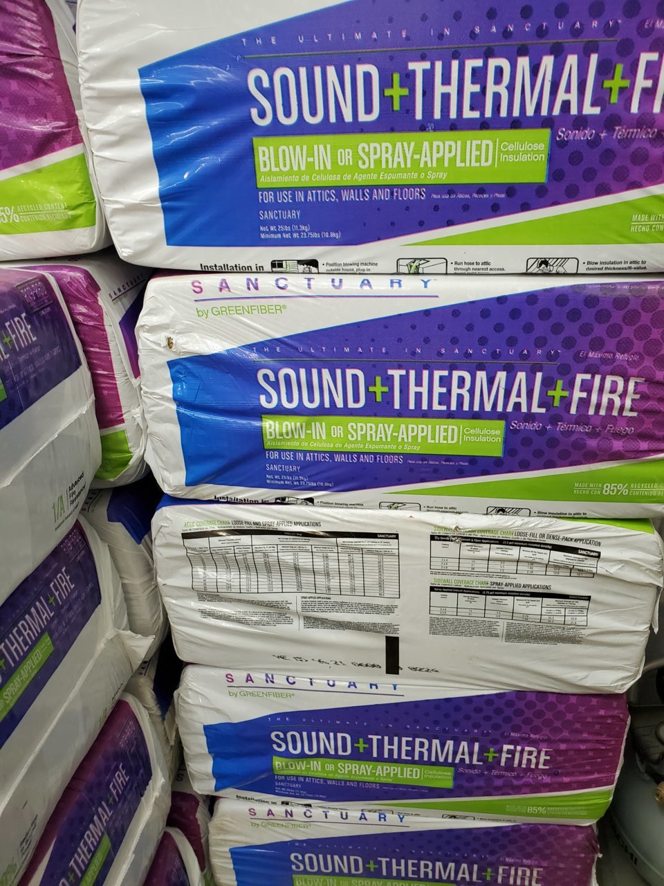

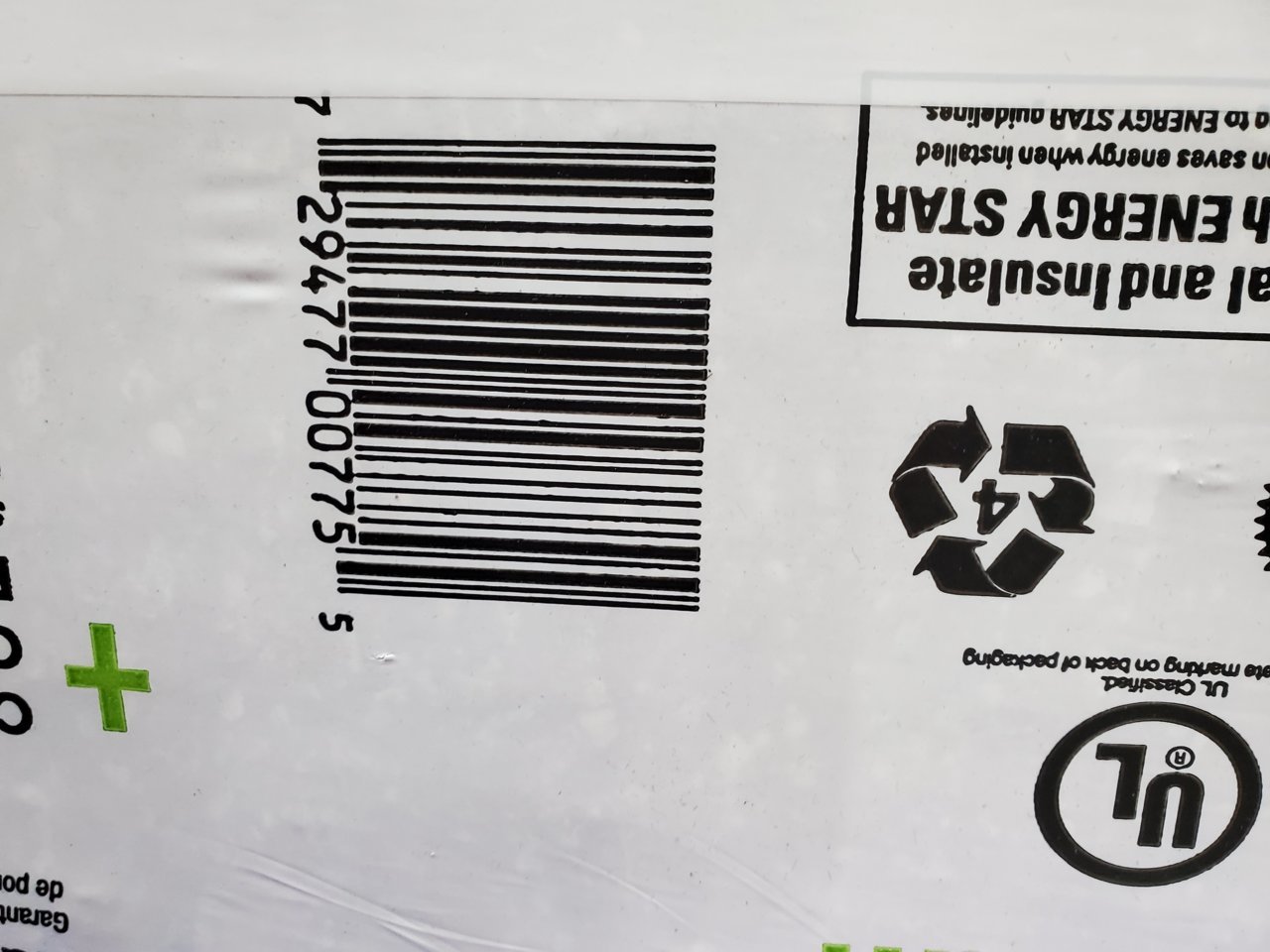

    For those in the market, this cellulose is on clearance at Lowe's. Doesn't show stock on the website or app. $5.67/bag or $4.82/bag if you buy 30. There are some complaints about higher than normal plastic content but at the price you can't beat it.
