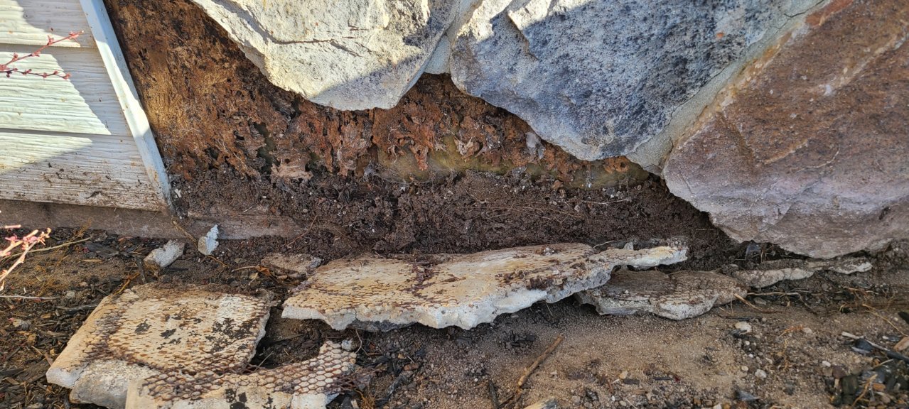

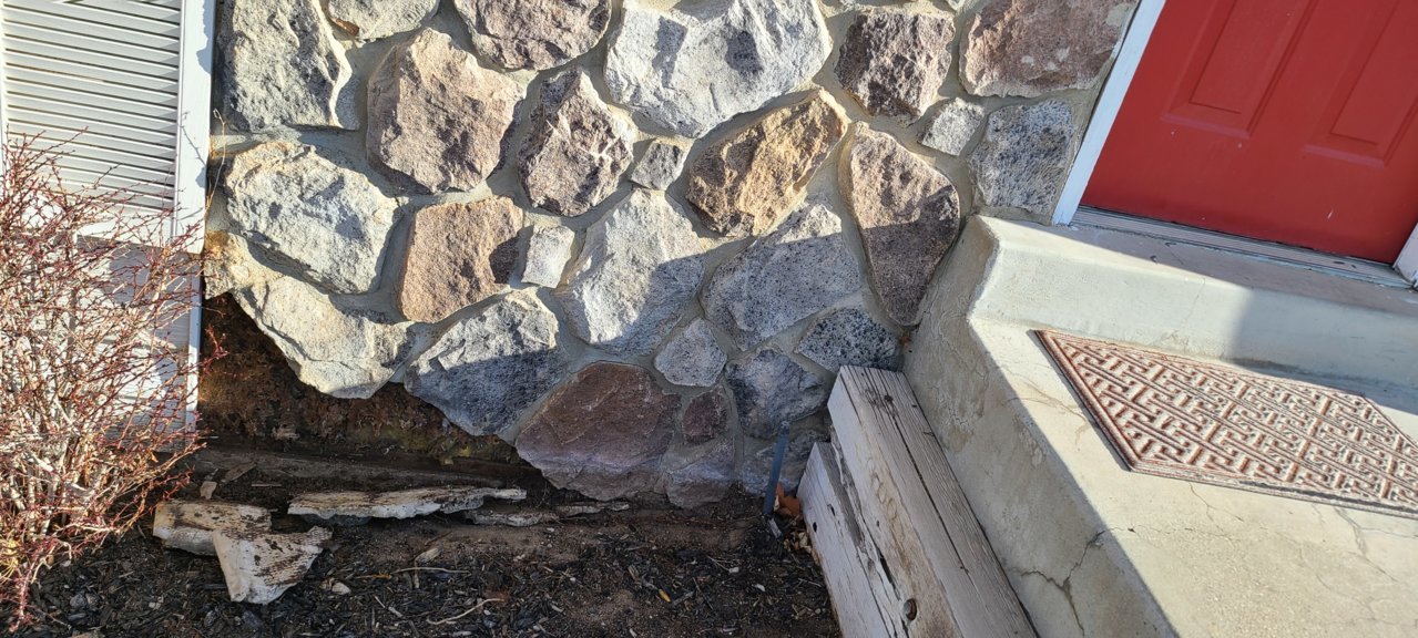

    The upper story sticks out about 18 inches too, so that whole front flowerbed is "under roof" essentially as well unless we get a storm/gusts from the south.
    Thanks, here's hoping! :thumbsup:

    You may want to look under your siding as well. Yes pull things apart look at all areas including pulling insulation back. Hopefully it hasn't penetrated beyond exterior area. Let it dry before rebuilding. Moisture is being held in soil and is wicking up into the wood. Using PLYWOOD apply some Blueskin wrapping the backside including the bottom edge of plywood a good 6 inches or so than cover front of plywood up about a foot and cover with wrap. The Blueskin will help seal the edge of plywood and where the sill plate and plywood meet keeping the moisture out. Most important, pull the dirt away from house and angle for drainage. You already have a good slope towards corner of the house, just make sure that slope is good by your step area.
    Home ownership can be so much fun at times. Just not times like this.

    Wrapping under the bottom edge isn't something I'd though of, but seems like a good idea to protect that edge. I'll look into that.

    Yeah a contractor friend who does this type of repair work showed me one day on a house he was doing.

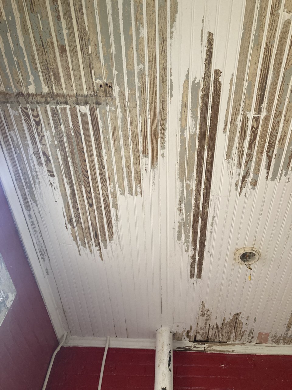

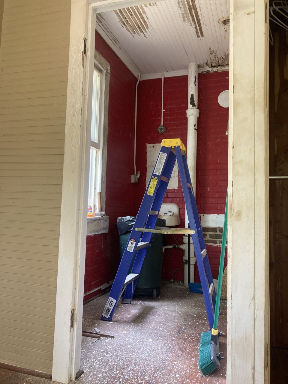

    I have a tendency to over do it. I was just going to wash the walls and get them ready for paint.

    Cut out the badness, insulation packed, scabbed, wrapped and sealed. Also yanked out 3 bushes to make work easier. Hate those thorny bushes. Big thanks to a few good friends that gave up a Saturday to come help.
    Mesh and siding go on again tomorrow. Im tuckered out for the day.

    Funny how you have to pick at the scab so that you can really see what’s going on. I red an article about 15-20 years ago no that was basically stating if you don’t pick the scab or peal back the bad when you find it; it will cost you 2-10 times more in the long run to get it right.

    I'm kinda nuts. I would have torn all that rock stuff off. Nasty work.

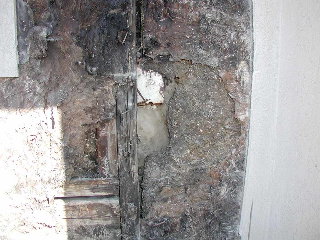

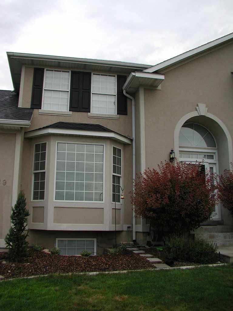

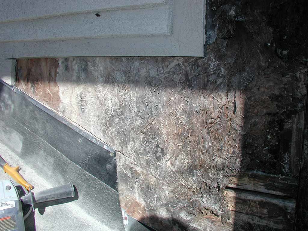

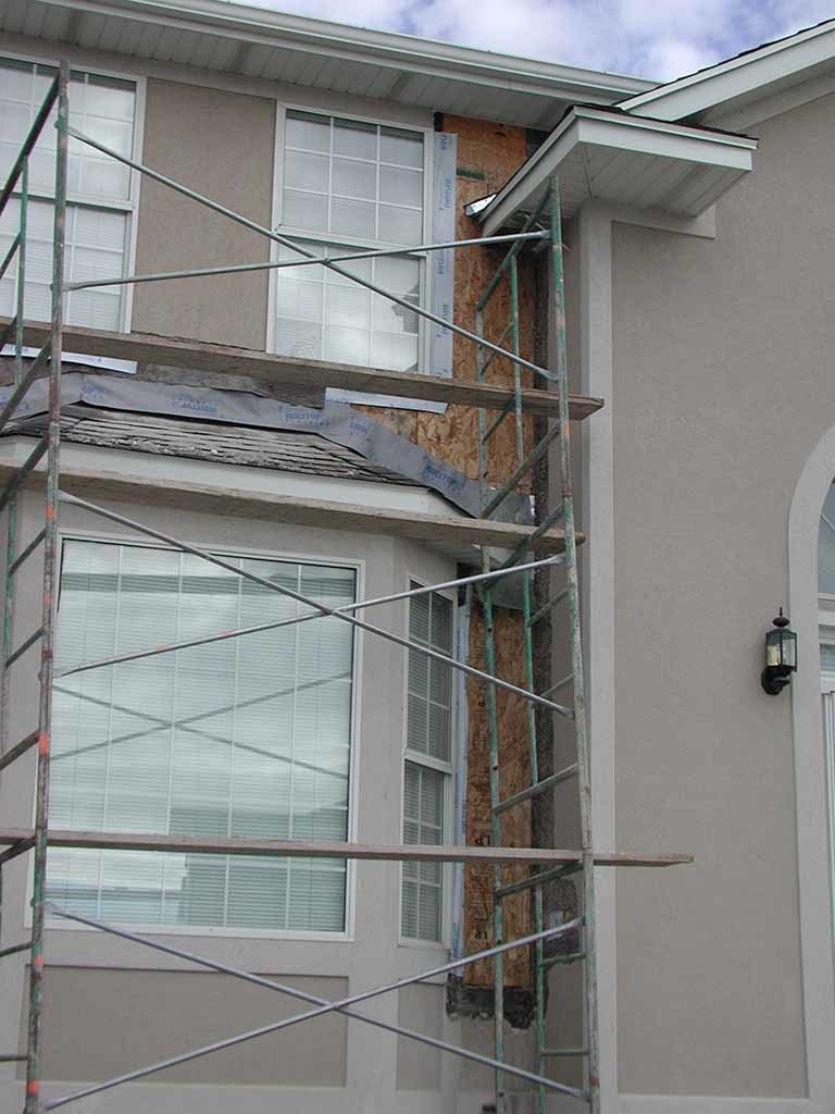

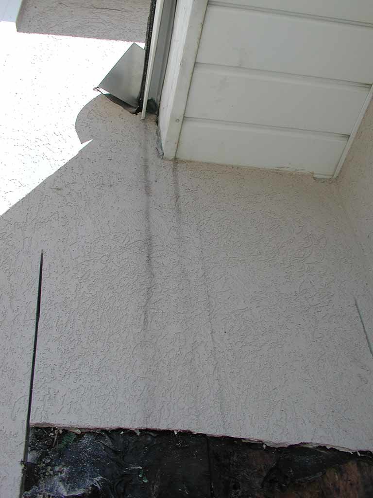

    Or even worse just put another bandage over it. That is what I did. The stucco on my house was looking a little water stained. So I had a guy come in and "fix" the down spout and freshen the stucco with a new coat.
    Several years later it looks good from the street, right?
    It's just a little leak from the gutter, right?
    Yeah, no. It's a full on Charlie Foxtrot.
    The damage went all the way down the downspout and across the bay window. It cost thousands to get fixed right.
    Houses built in the early 90's in Utah, and maybe else where, typically didn't seal the connections between the roof and windows correctly. These pictures are from when the house was 15 years old. I moved out 10 years later because every house in the neighborhood had stucco that had 25 years of rot hidden behind a sad looking exterior. I figured the property values would start to fall as people got high $$,$$$ repair estimates on what has to be some serious problems and decided to move rather than fix.

    :ohsnap:
    That suuuuuucks.

    I could believe it. Had to pull the siding ti get a small corner of bad out to fresh wood and saw some water staining on the other side as well. So we basically ended up fixing the entire front of the house since we had access to it.

    If it wasnt a very high percentage of the front of my house's covering, and I didnt like the look, I would have probably done that too.
