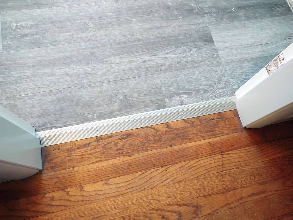

    Ah I see what you're saying! But it took me a while to find the right router bit. I think this might be easier to do, honestly. Just cut a 1/4" x 1/4" slot 1/4" down from the edge per the diagram from earlier with this:
    https://www.amazon.com/Yonico-14911...utter+by+1/4+inch+depth,industrial,207&sr=1-7
    Then glue a piece of spline. Looks like spline is kind of hard to find in 1/4" x 7/16", though. So maybe I'll have to do it your way. Gotta find a track saw now :rofl:

    If you want to go the router way you can make a tongue on the table saw with some leftover flooring. Just rip it to what you need. And watch your fingers. lol

    That's for cutting a groove. You need a tongue cutter.

    I would just make it a lap joint instead.
    1. Cut floor boards flush with track saw.
    2. Nail appropriate sized square dowels along the joint edge to support the nose.
    3. Remove bottom side of the nose to the appropriate depth with router.
    4. Put the nosing down, put wood glue in the lap, slam her home, face-nail with finish nails.

    I might have to. It looks like 1/4” x 7/16” slip tongue is hard to find.
    We would want a groove and then apply slip tongue / dowel to it. I imagine it would be easier as we want to match the groove on the nosing as best we can. I looked at tongue bits and I couldn’t find one that would easily slip into the nosing.
    That’s… actually probably a winner. Seems easier than what I had in mind. With the lap joint we’d have more freedom to snug the nosing to the flush end as well. Wouldn’t be married to the width of the new tongue.

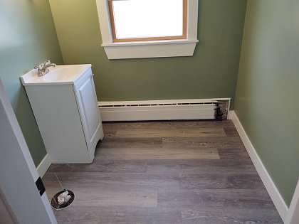

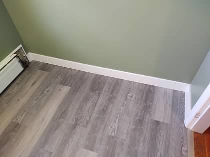

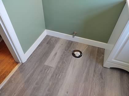

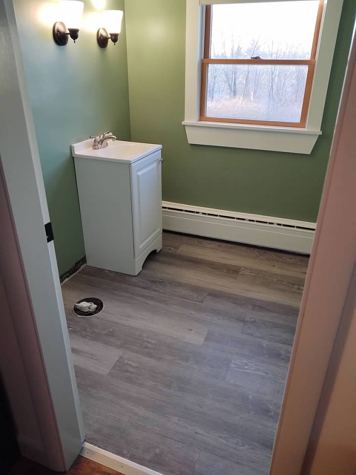

    Thank you. Just installed the baseboard trim, filled and touched up the nail holes. Once that dries, crapper goes back.

    Went to the local hardwood specialist and they had 1/4” x 7/16” spline made out of oak. Exactly what I needed. This will fit great with some room for wood glue.
