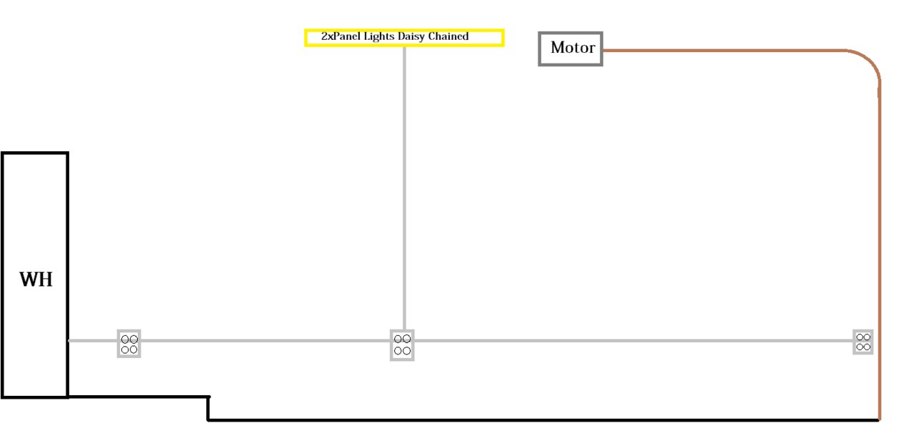

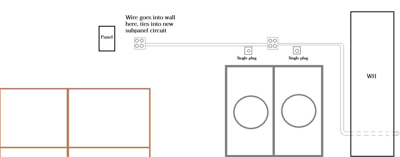

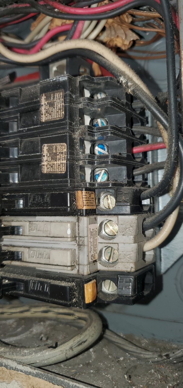

    I'm getting a plan put together to expand the electrical circuits in my condo garage. As of now I've got a duplex outlet on the workbench, then single outlets for the washer/dryer, and then a duplex on the ceiling for the garage door motor. Being a DIY person means lots of extension cords to do anything in the garage that isn't on the workbench. So I want to install some surface mounted conduit (EMT) and put a couple of quad boxes along the head wall and 3 more along the long wall. I'll either split that off onto some panel lights or tap into the existing ceiling light. MS Paint on company time will give you an idea. Since drawing this I decided to install another quad box on the left side of the workbench. I'll be installing some tandem breakers since my tiny condo subpanel is already full. I'll also be installing a new 240v circuit for an EV charger recepticle between the workbench and washing machine. While doing recon on the panel I discovered an installed, but unused, breaker. Strange. Also discovered my son is already a Milwaukee fan :humble:

    All on one breaker? If so, that's a lot. You better make absolutely sure you're not running too much at once.

    You can put up to 10 receptacles on a 20 amp circuit.
    Obviously if you’re running multiple tools, appliances, etc at a time you’ll overload them circuit.

    Please tell me you're upgrading that panel...
