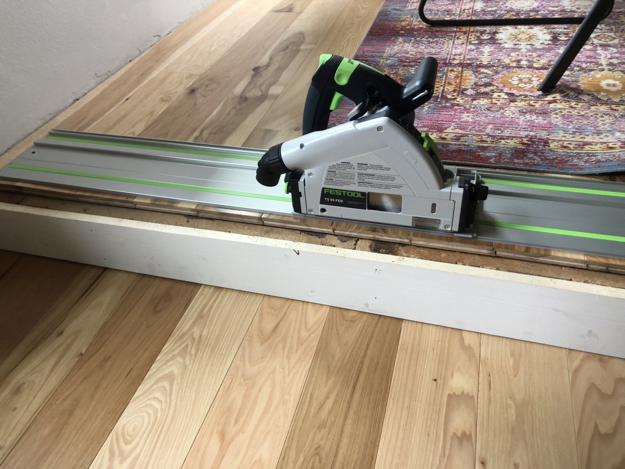

    Okay I got a new (thin) riser all scribed and mocked up. The bottom scribe took me more attempts than I want to admit in order to close gaps underneath. I bought a whopping $50 scribe tool to get it right :rofl: The brown mark is where I had to splice two pieces together. I had to Drydex and sand it flush. It’ll be invisible when I paint it.
    It’s about ready for some scuff-x and then final mounting. Question is, how OCD do I want to go with getting it flush with the subfloor? I used a block plane to get to the scribe line on the bottom. Up top I guess I could block plane the both of these flush to each other, but it would take a lot more work I think. Maybe there’s a router bit that’s better for this? You can see the chatter where I tried to block plane a few strokes. Didn’t necessarily make the nicest cut then I chickened out.

    As long as the subfloor is smooth, a flush trim bit should work on top of the riser.

    Ah yeah I can probably do that. I’d have to hold the router at a perfect 90° to the floor though and mine is a 2.5 HP heavy chunk of metal. Maybe just use a sander? I could take some 80 or 120 and slowly take material away until it’s smooth and flush. The riser is just MDF.

    Or you could borrow a power jointer/planer?

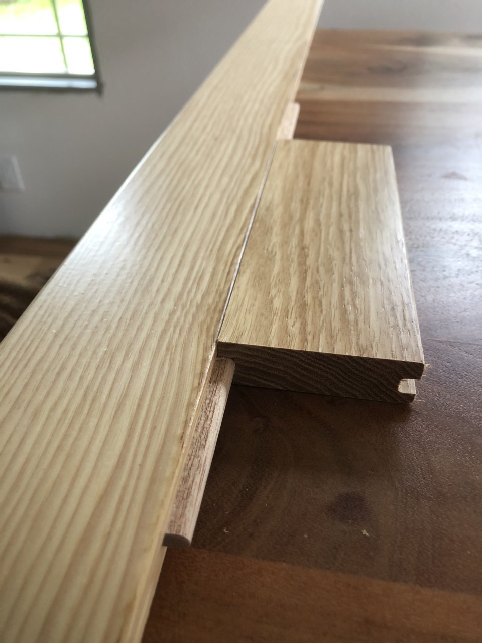

    Just wondering. Can you put a stone strip, like marble on the edge?
    Stone resist wear better than wood.

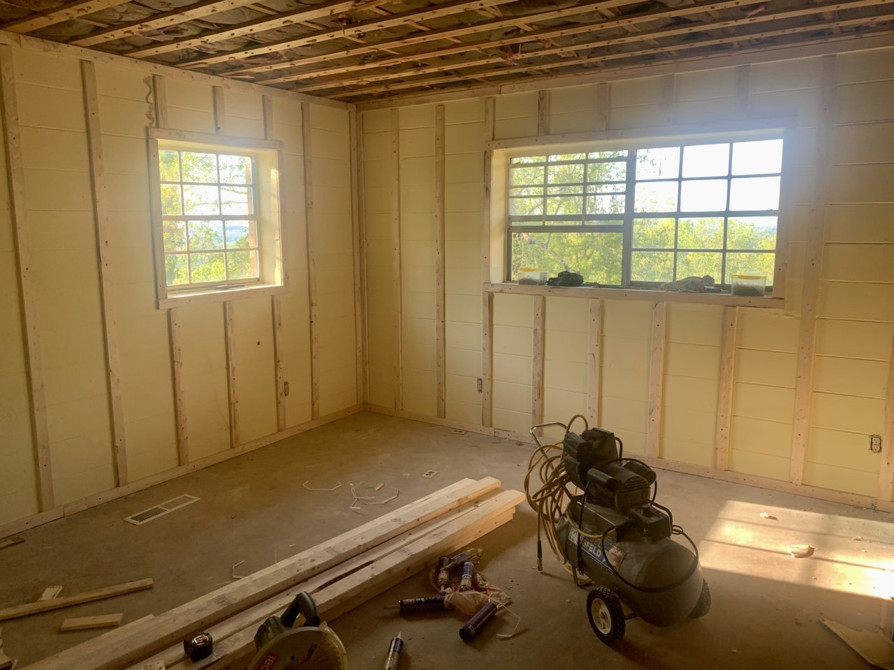

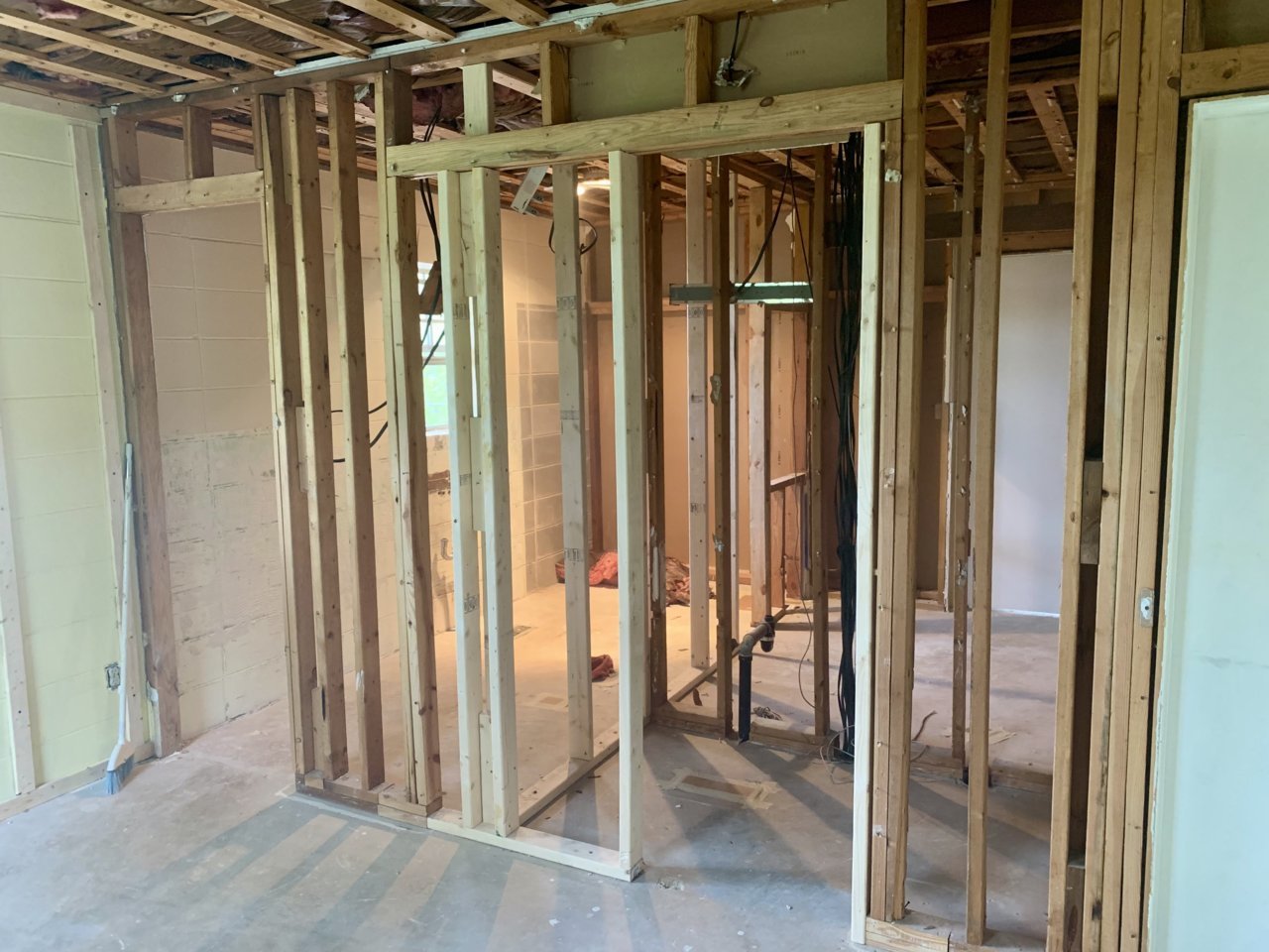

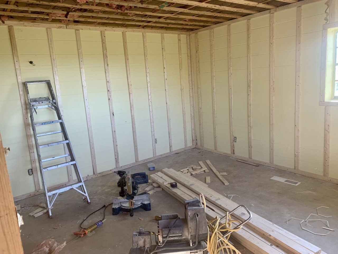

    Furring strips are up and got the new layout for the bathrooms and closet roughed in. Next up roughing in electrical.

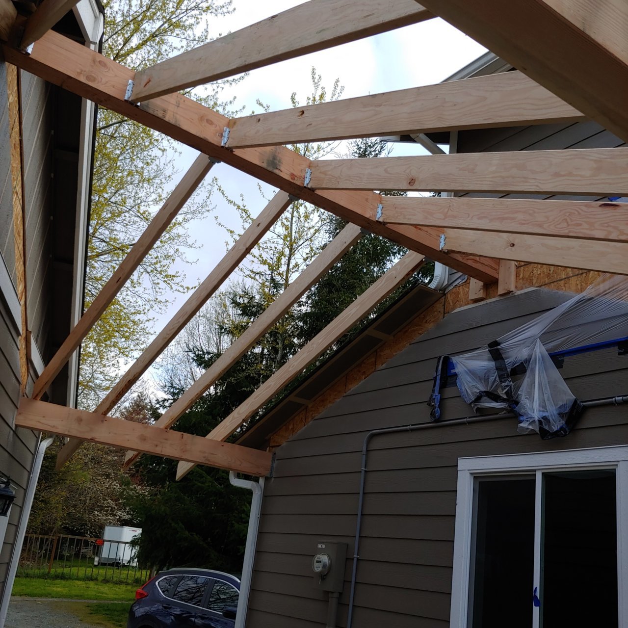

    Framing Inspection is coming Monday. Taken Wednesday.

    You've got some work ahead of you. But it's going to be great having more living space.

    They had a weird layout up there. Closet was too big, two bathrooms with a pocket door haha. Somebody thought putting a sink in front of a window and on top of a vent was a good idea, too. It’ll be more appropriately sized and laid out/separated for kids rooms.

    What kind of joist hangers you using?

    Simpson. I will get the part number when I get home.
