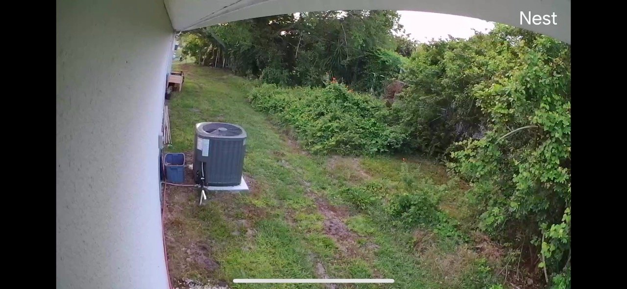

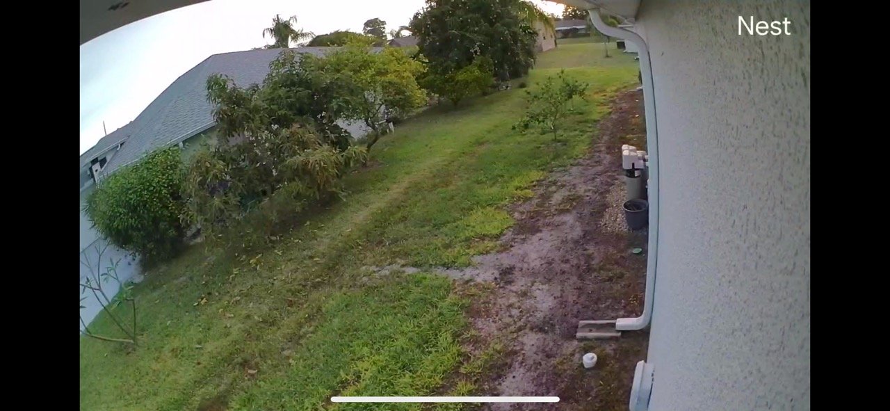

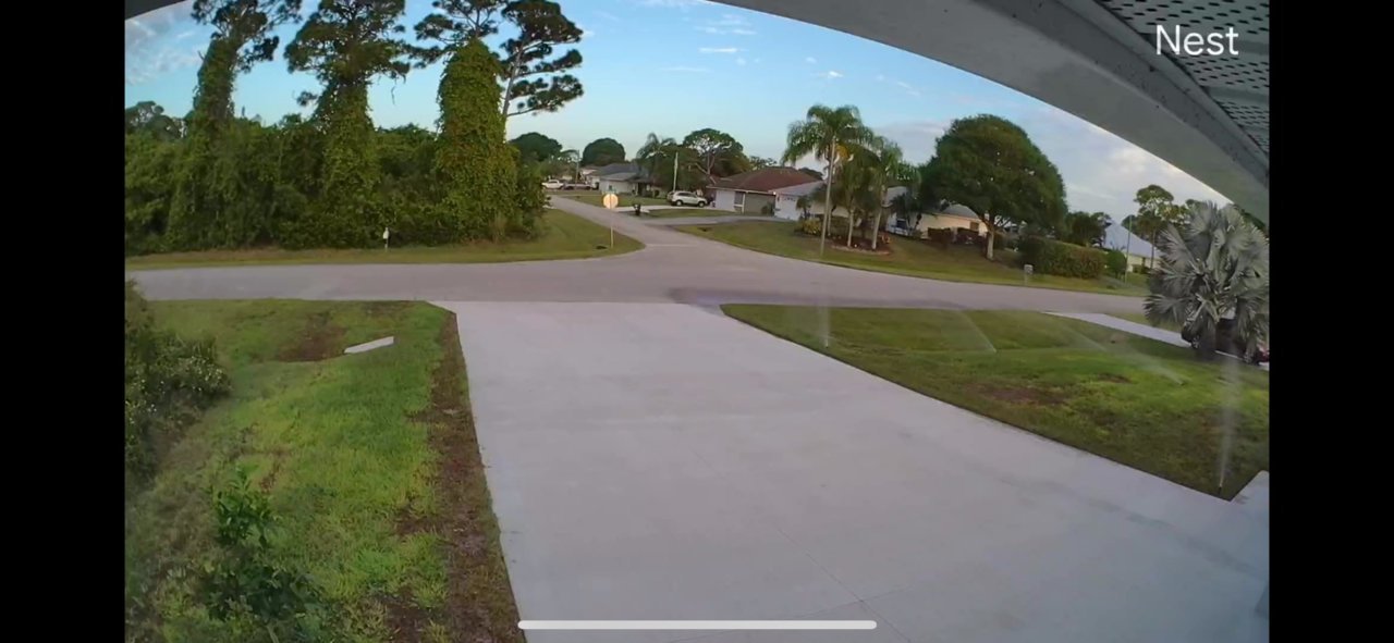

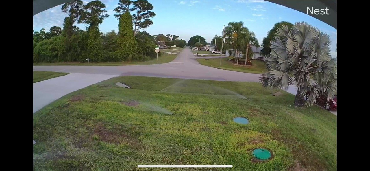

    Added 4 new Nest Cameras to my house. Theyre on battery now but plan on hardwiring them to a power outlet. IMG_9782.PNG.jpg IMG_9783.PNG.jpg IMG_9784.PNG.jpg IMG_9785.PNG.jpg

    Did you get any of the ones with lights?

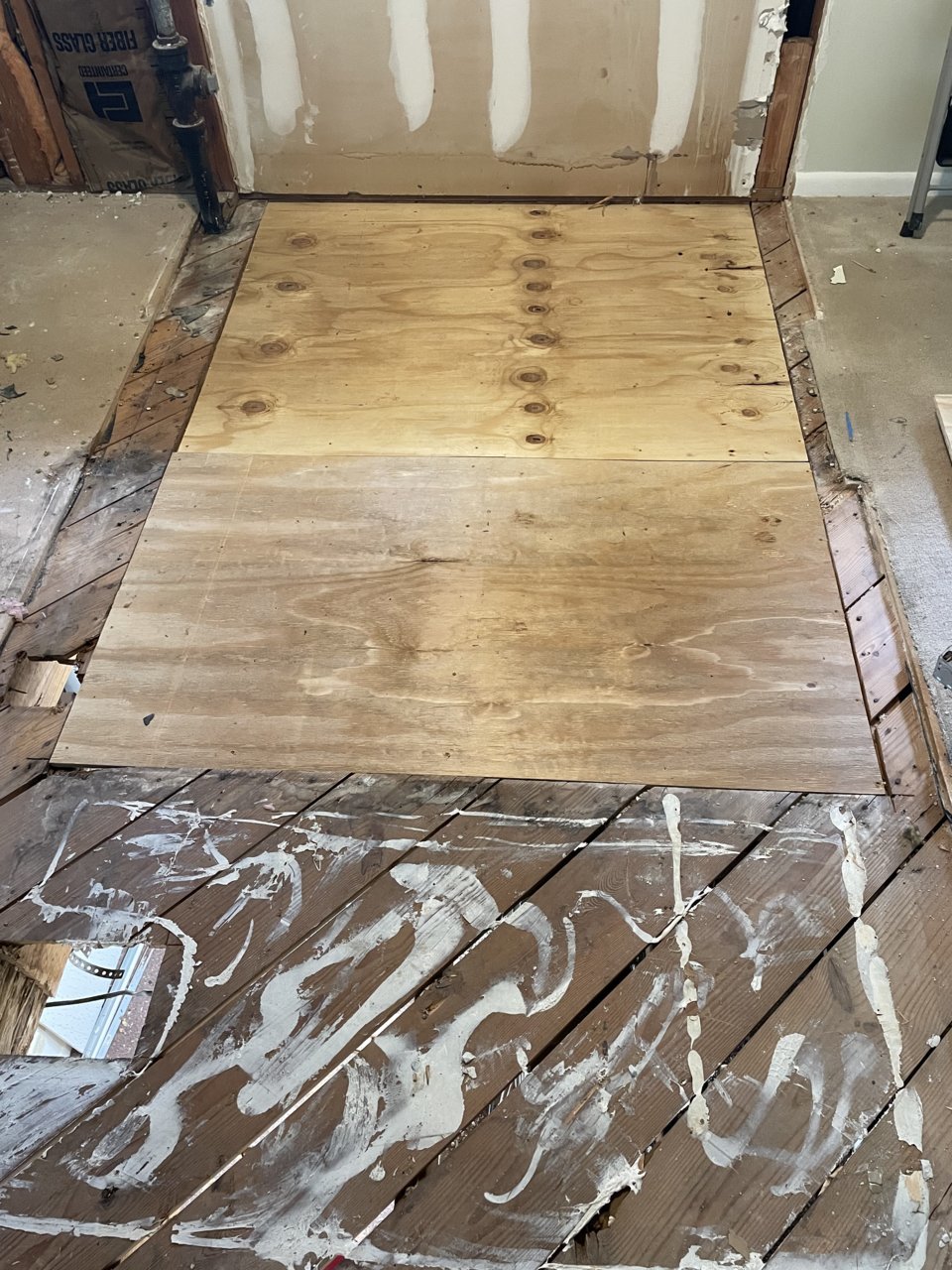

    (If your eyes are good enough to see, just ignore the hanging electrical lol)
