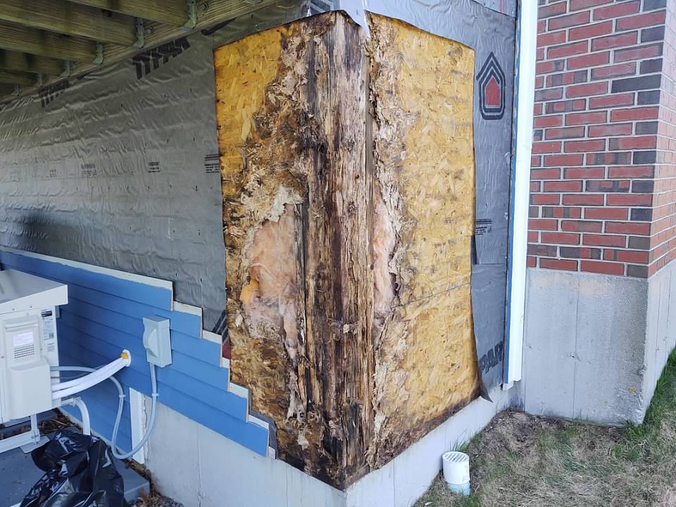

    Seems as though other houses in this neighborhood (high end) have experienced similar issues. One was a $30K repair bill. Original builder did something terribly wrong.
