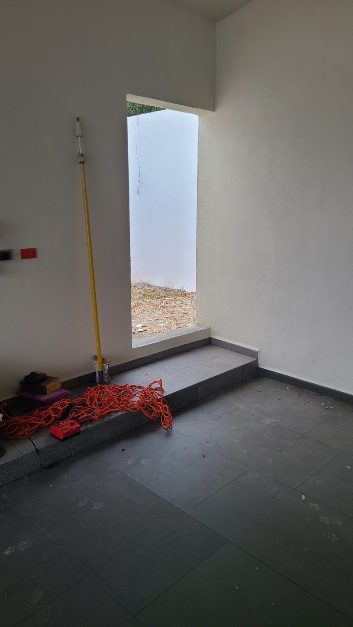

    Started putting up doors outside today. Started with this pedestrian door from the garage my cousin fabricated for me and hung today. Still have several more to do. Next week getting the septic tank topped and some doors on my well pump/filter room out front 20220511_134122.jpg IMG_20220511_162356.jpg

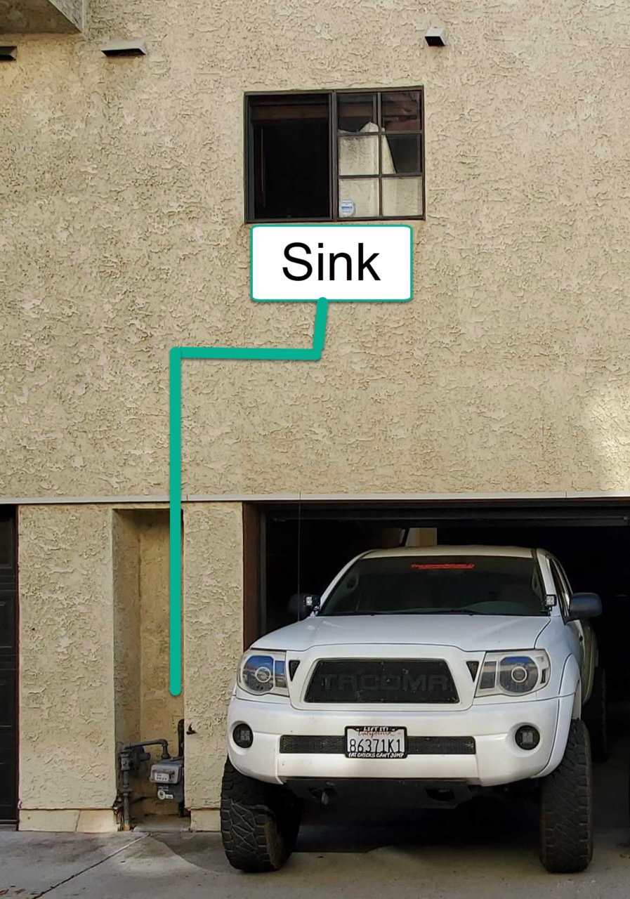

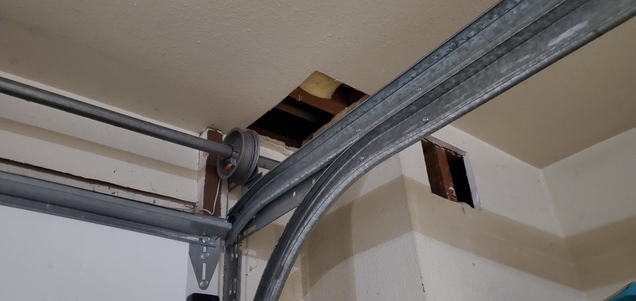

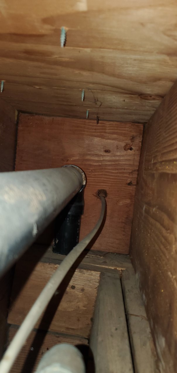

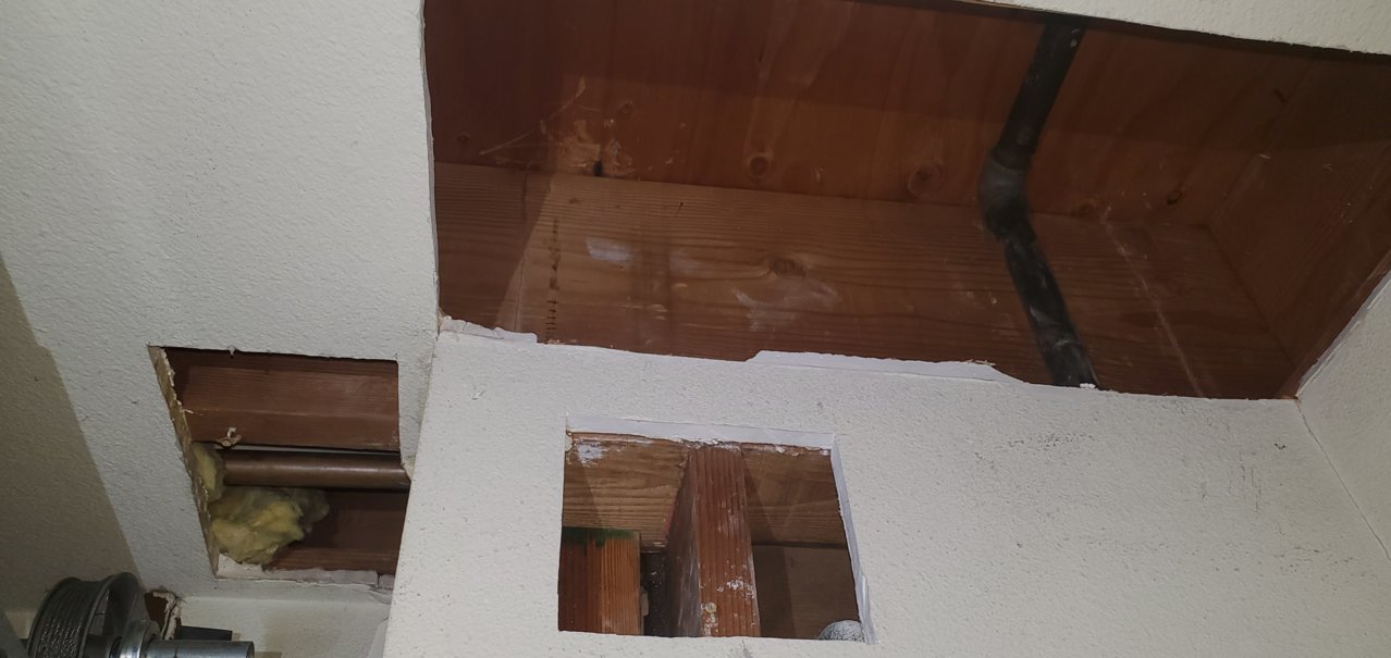

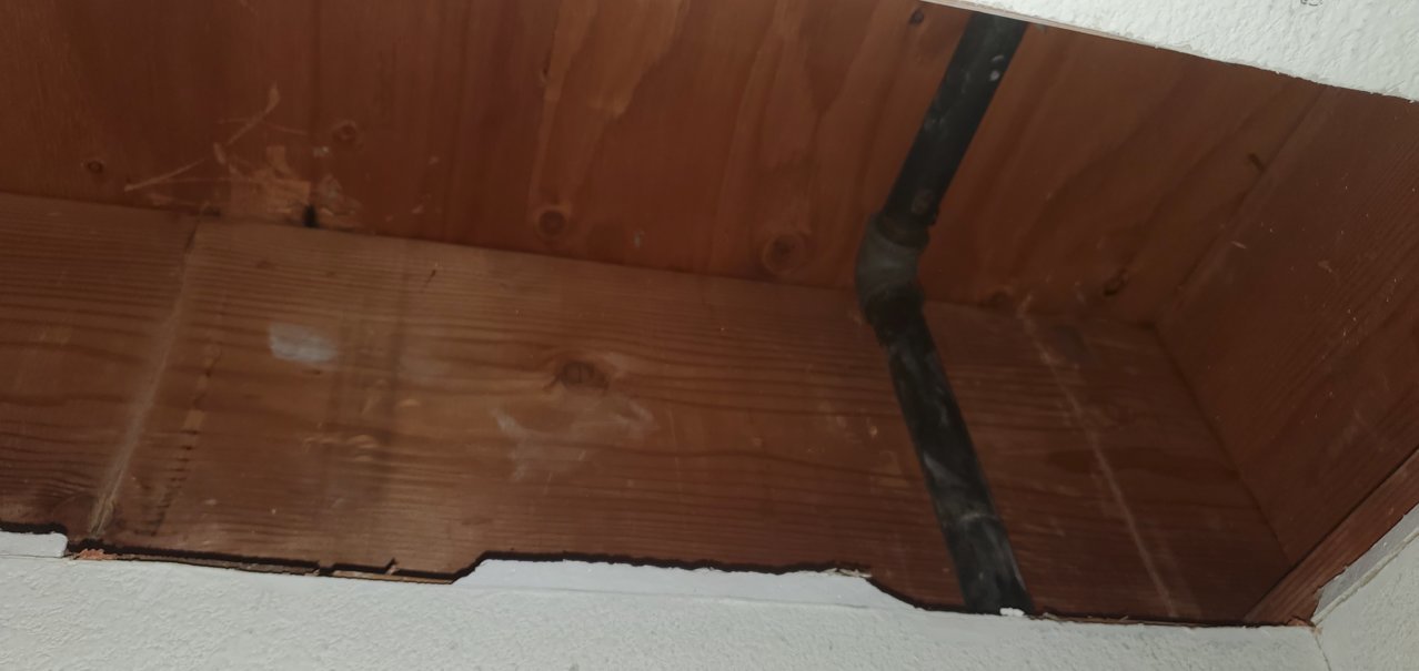

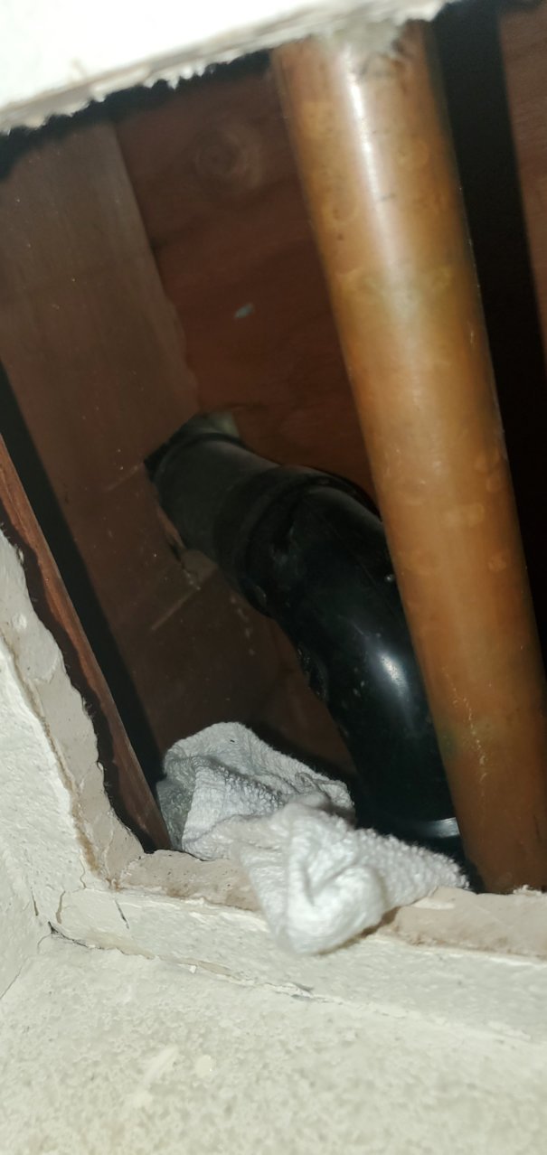

    So the kitchen plumbing does something like this
    Cut some access holes in the garage, of course where I need to get to is all framed in with 2x6 where the gas/water mains are outside my garage. So I went up into the ceiling, unfortunately the water supply runs in that same gap between the joists, so my access is only about 4" on either side of the water pipe.
    Looking up thru that ceiling hole you can see the ABS elbow, confirmed it's leaking like a sieve.
    There's enough room to get a Dremel up there to cut the elbow out & glue in a new one. Just as I was making a shopping list i noticed something on the new endoscope: the downstream elbow has a slow leak as well! This one is 30" in, between the exterior wall & a joist, no access from below unless I open up the "top" of the exterior hideaway where the gas meter is. I don't think the HOA would like me doing that. The water main can be seen coming up from that exterior alcove, in the bottom of this pic.
    Looked at my kitchen & the option there is cutting an access hole in the bottom of my corner cabinet, removing the tile, and then cutting open the subfloor. I think what I decided to do is open an access hole in the garage ceiling against the shared garage wall, on the other side of the joist shown in the pics above. Chop out 18" or so of that joist, leaving it intact where my access hole is shown above, with the fresh end of it now resting on the framing it's sitting on. That'll give me access to the elbows, and when done I can put the cut section of joist back in with some strong ties. This became a real bitch!

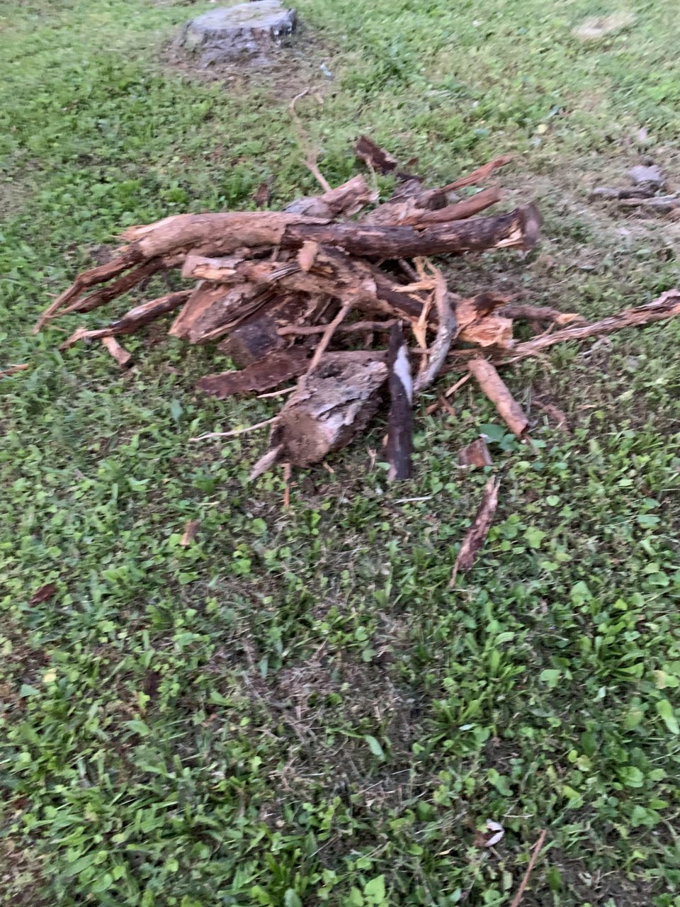

    More root removal after having pine trees cut down, sawzall and a pickaxe

    It's either this or pay my $2,500 deductible. And I really don't wanna make a claim since I just switched carriers in April!
    Ceiling is open, joist is cut on each end. Tomorrow morning I'll get my oscillating tool up there to cut all the screws coming thru the subfloor & hopefully "pop" that section out to access the elbow behind it.

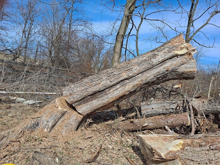

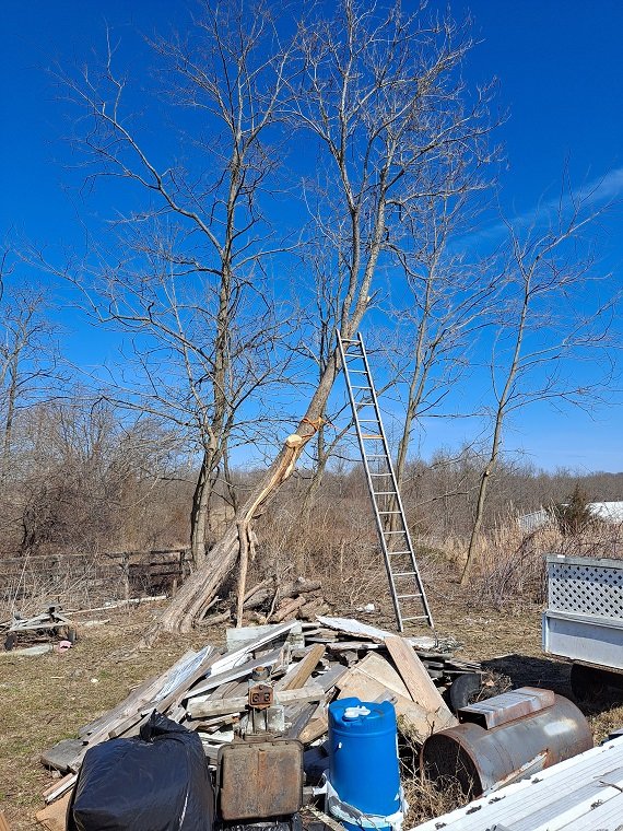

    I cut a tree down by my garage a couple months ago, no l was not up on the ladder cutting but the blade from my tree saw got stuck so that was the only way I could get it. Getting down to the base I was cut damn near all the way thru and it just was levitating like that and just didnt want to fall.
