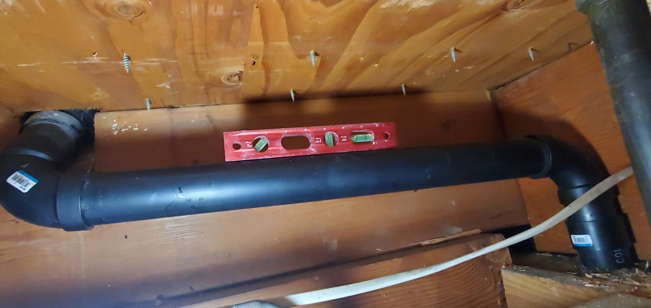

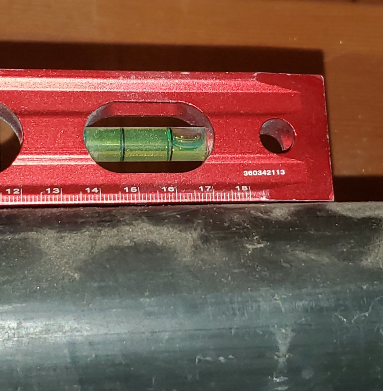

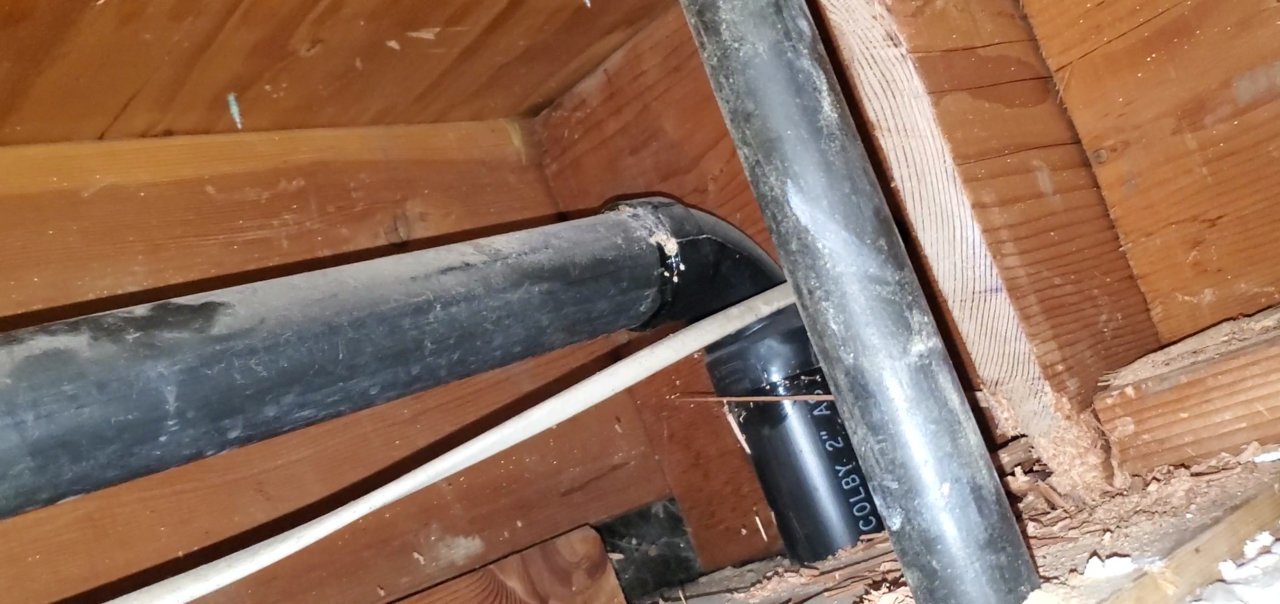

    Got up early and knocked out about 2' of 2x6 joist that was blocking access to the drain I needed. By 0700 I was attacking the nails & screws along the top of it with my oscillating tool, I preemptively sent an apology text to my neighbor :sorry: Got it out of the way and finally had enough room to get an arm up there.
    After looking at it from a few feet away I followed a hunch and grabbed my level. I guess water flowed uphill when this was built in 83? This whole section was full of a ton of sludge and explains why the leak continued so much longer than expected after I poured just 1 cup of water in the drain. The water wasn't flowing downstream it was just pooled up leaking out of the elbow joint.
    Measured once, cut thrice & dry fit everything. I'll be damned if it's not sloped downhill now! Ended up with ~1/2" per foot of slope for this ~28" stretch. :woot:

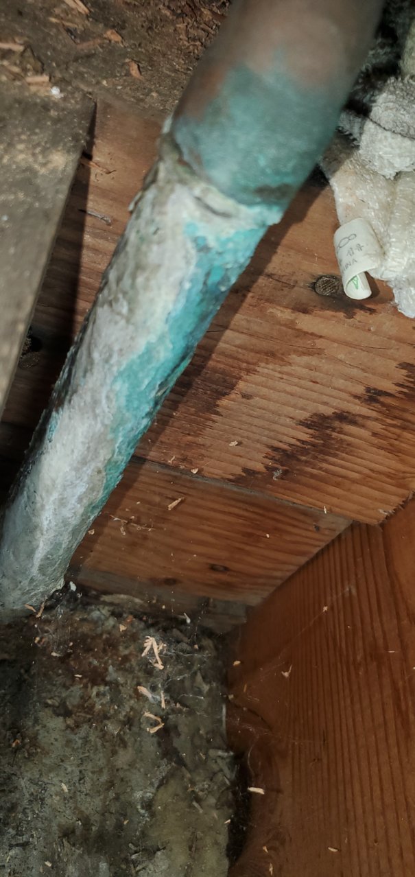

    Disassembled, cleaned all the joints & glued it up. Waiting on it to dry as I type. The other fun discovery was that my water supply is weeping enough to see. The mineral deposits on the pipe were what caught my eye on that. So now this weekend I'll be sweating a new copper elbow on that. This also explains why the alcove where my water/gas mains are always has mold growing on the stucco. I figured it was because it's on a north facing wall & doesn't get sun. But this water dripping down the pipe is keeping the whole operation wet. This is turning into a Holmes on Homes episode :spending::angrygirl:

    That's been seeping a long time. You got enough to cut the exiting elbow at the wall side or are you gonna sweat it off?
