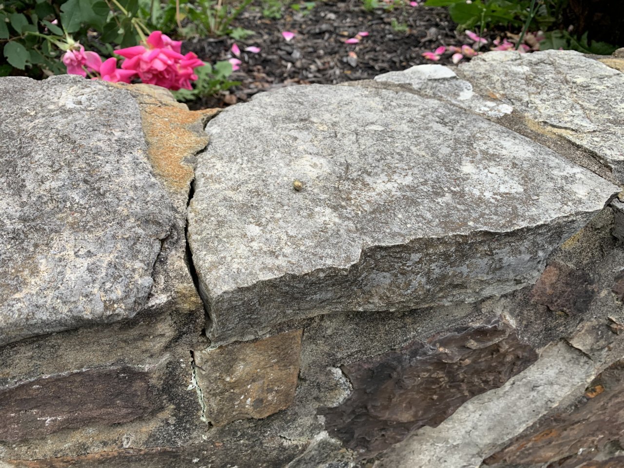

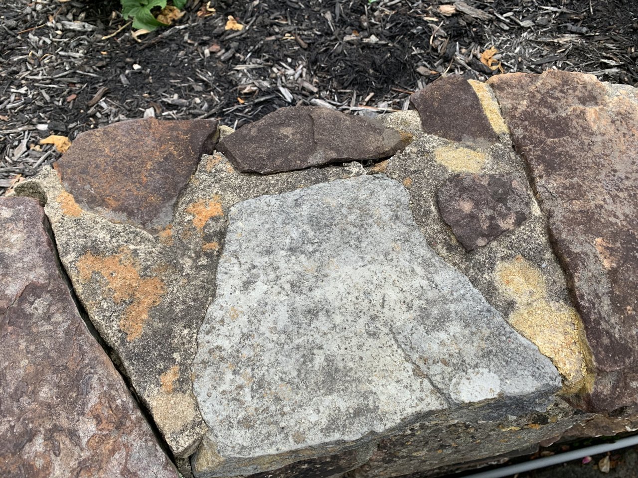

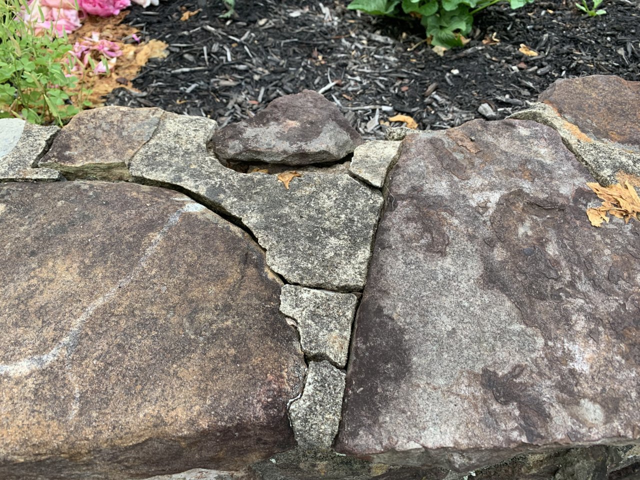

    I wouldn't bother chipping it out. Bigger headache. I'd just mix up some quick set concrete, fill a zip lock gallon bag, cut the bottom corner off and pipe it in. :notsure:

    Well, if you're gonna spend the time on it, do it right. It's alot of work, but the best way would be to remove all the mortar...

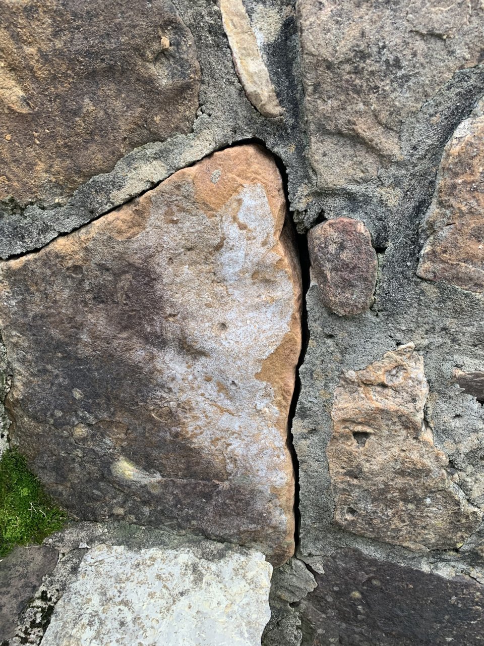

    That was my thought. Or maybe use damtite.

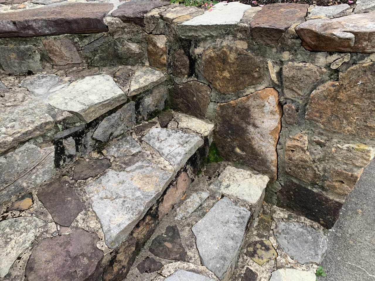

    I hate that wall, it is pretty, but I wish they would have left it brick.

    Depends on how well bonded it is. Looking at those failures either they didn't compact the base before they started the base course or they used the crappiest mortar known to man. I'd start by hitting the mortar seams with a mason hammer to see if they are even bonded still. If there not it's all gonna happen again a few years down the road. But I'm a carpenter and not a mason so I could be way off. lol

    I’m no mason, but that seems like a lot of mortar and not enough rock? Not sure if mortar will fail sooner having a big span like that. I could be totally wrong just spitballin’

    I think if you start chipping it out the wall is going to crumble and you'll end up spending more to rebuild it or replace it entirely. Agreed on settling over time likely causing the cracks. How much time/money do you want to invest in it?

    This is when I need you to lie to me and tell me it’s a 5 minute fix, even though I know the one who had this done got the cheapest contractor (and I use that term loosely) they could find. Better buy some stock in damtite and plastic bags, looks like this is gonna be my big summer project.

    this might sound like a dumb question but do you guys get winter conditions where it rains during the day then freezes at night ? because that looks like frost heaving / ice heaving in the joints to me
