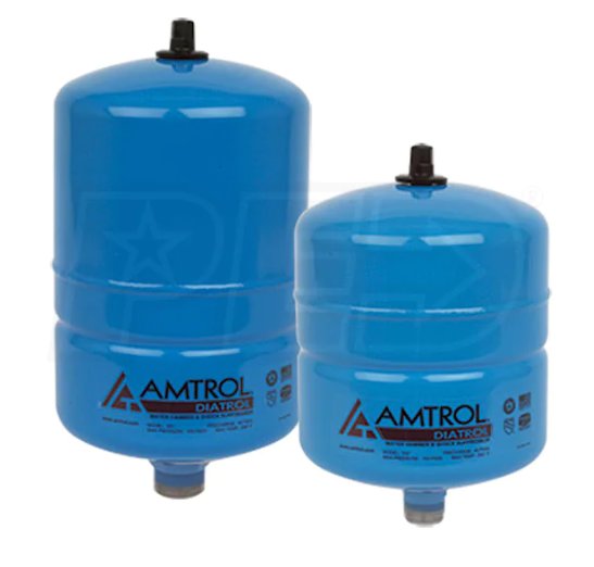

    I have a plumbing question -
    The pressure regulator in the house is 26 years old. It works fine, no leaks, no pressure fluctuations. In the last week or so, when I open a water value (sink, toilet, etc.), the water flowing through the regulator sounds like a water hammer.
    This does not happen upon the opening of every valve, only some of them, so it could be volume related.
    I assume the spring in the regulator is compressing and rapidly expanding with the flow, creating the hammer sound and vibration. (Just a guess)
    I have adjusted the pressure setting slightly, thinking repositioning the diaphragm may help. It didn't.
    Do I need to replace the pressure regulator?

    Do you have a water hammer in your system anywhere? It could need recharged or replaced.
    SpyGoat likes this.

    No, I don't.
    The closest thing I have is an expansion tank next to my water heater. It's about 12 years old.

    Check your pressure tank see if its filled with water. Turn off main line and pump, drain tank then pressurize tank.
    Also may need to shut off house main line and drain the water from all the lines then pressurize again. Which drains the water arrestors if it has any.
    https://boltonservicewnc.com/tired-...ng-noise-in-your-home-all-about-water-hammer/
