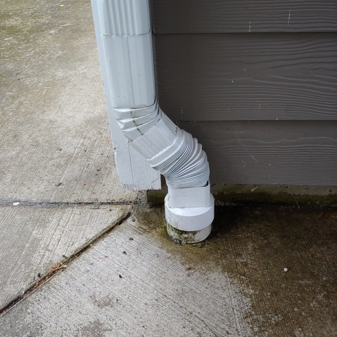

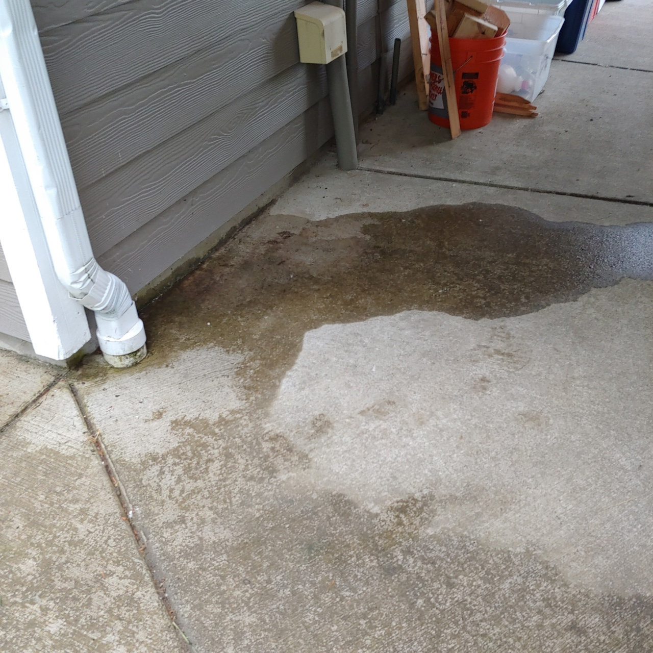

    Leaky weird non-pro down spout leakage........pissing me off. Right in the breezeway.
    Have not looked what I can get locally. Any experts here??
    Replace, seal whatever.

    Clear the clog that's causing it.

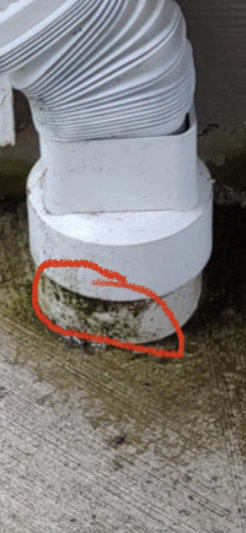

    the 4" PVC slip cap is over the outside of the pipe so if its an unglued connection the water could be weeping out between the pipe and cap

    Id bet theres a big plug of leaves and shingle bits in there that water cant get past.

    you might verify that the drain isn’t plugged too

    Or a dead rat

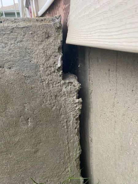

    I'm not sure if these will be good.

    It's mostly rain water, accumulating snow sitting on the porch causing the wood to rot.
    I have to figure out what I can install under the doorway to prevent any future damage.

    The slope of the porch needs to be fixed to shed water away from the house. Any other "solution" is just an extension to the problem.

    The L shaped brackets get sandwich/mortar inbetween the block. Then the others side get bolted to the house foundation.
    This was an idea from a neighbor that had it done to his block porch.

    Once the aluminum flashing is remove I can see how much damage is done. I don't want to remove anything yet.
    Once the old porch is remove I can have a contractor look at the damages. Right now I'm having a hard time finding a masonry contractor.

    After they demo and haul away the old porch you’ll want to peel off the bottom couple courses of siding, repair the sheathing, then apply a peel and stick membrane that will cover all the wood down to the foundation. We use ice guard but there are different products available. They will pour the new porch (with correct slope lol) up against this membrane. You might consider making the new porch height like 1/2” under the door threshold.

    I seen it done at a friends house with a aluminum flashing get nailed to the house then overlap the first board that attaches to the house.
